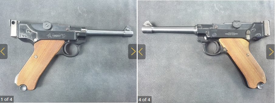

Originally Posted by Kyrie View Post
Is your pistol like one of these?
https://www.gunbroker.com/item/768975411
What is that silver block on the back of the receiver??? Is it an accessory adjustable sight???
Unread 05-09-2018, 03:22 PM   #8
kurusu
Join Date: Sep 2007
Posts: 1,225
Thanks: 2,679
Yes it is an adjustable sight. There were two versions. Fixed and adjustable sights.
