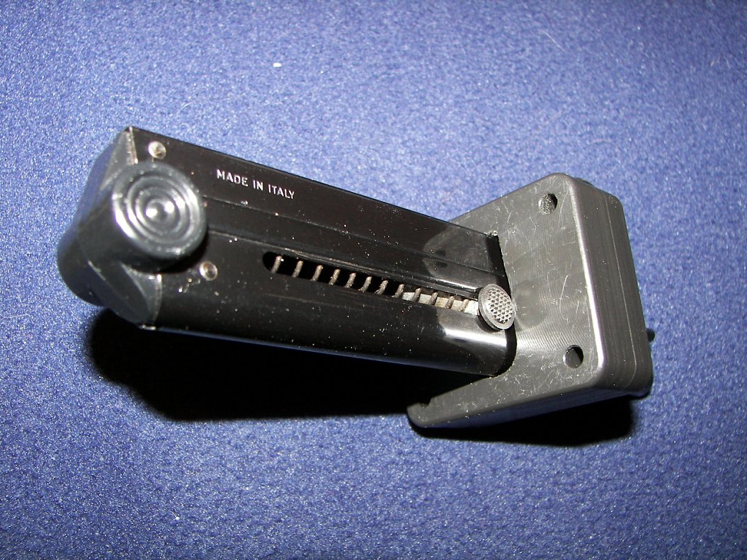

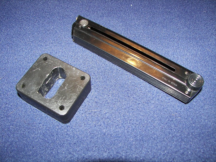

After struggling, quite manfully, to reload my Luger's magazines with and without the clever issue tool, I found a block of high-density plastic in my toolbox (a leftover from a GPS mounting exercise, for what that's worth) and with the use of a 1/2" router bit in my drill-press (not to melt the plastic) plus a bit of hand filing, came up with a hole just large enough (1/2" x 1.05") to pass a Luger magazine, but not pass the follower "handle" or "button." The attached pictures should "speak for themselves" and I can tell you this gizmo really reduces the time & effort required to load the eighth round. Tongue in cheek - I have no designs on attempting to patent this, so send me no royalties.
