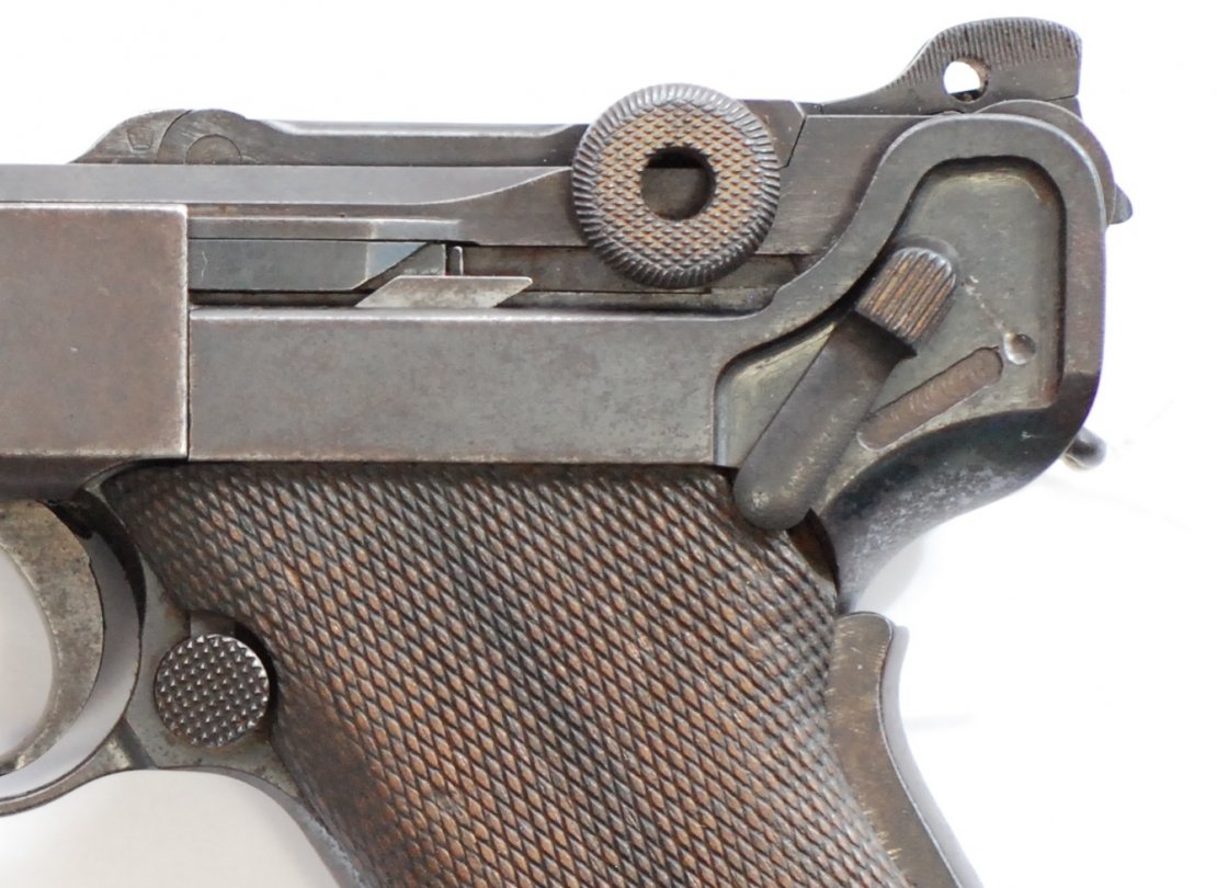

Here you go, Ski.
Norm

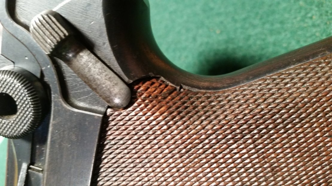

Well , I have but 1 luger at this point ... and I'd like to take it to the range.
Since starting this thread I did a close inspection of the area in question - I think I may have a repaired chip. Have a look ---

A peep at the back side might tell us more, but the area does appear as though it might have been worked on.
My notion of the cause of many such chips is more akin to shrinkage or wear that lets the panel slide forward when a shot is taken. This tends to bring the area in question up against the safety lever's shaft with a sharp, significant force. Make certain wood grips fit snugly and take measures to stabilize them if they are loose. When fitting the left grip, I also recommend shaving out just a touch of clearance between the wood and the rear of the safety lever.
When the chip falls off during the grip scale's, It is my opinion that many of them are already broken, as above...then the loose chip merely released from captivity when the grip is removed from the frame.
That's not to say that one ought to abandon caution when removing the left grip!

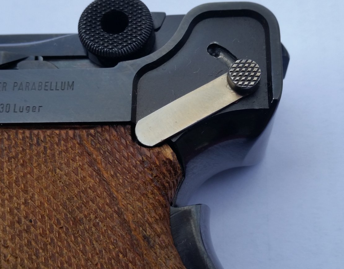

I just bought a post-war Mauser Parabellum in 30 Luger. It looks to be unfired, except for the obvious test-firing at the factory in Oberndorf in Dec 1970. But it came with the left grip chipped.
So, while I realize that one theory on how these grips get chipped is from firing, I have to believe that, in my case, it was from handling, by some previous person or persons unknown. It's easy to snag the grip on the safety lever when removing unless you are really careful.
Note from the photo that the chip on this grip is slightly different others I have seen. The back edge of the grip is not missing, but a piece off the top outside surface is chipped off.
Another piece of data for the million-dollar chip

The left grip is snug , no movement. However - my logic is that , since I appear to have a repaired chip , it happened once and therefor can happen again. Now , I have no way of knowing if the Chip occurred as a result of shooting or bad handling , but given the fact that the grips are original to the gun , and the repair is nicely done , I am unwilling to risk it. I'd hate to undo the work of whoever it was that took the time and trouble to do that repair.
And , for what it's worth , I am happy that the Chip is repaired rather than broken and with a (small) void. I don't know if that flies in the face of conventional thinking , but it looks pretty darned good , and my hat is off the the Chip repair guy , whoever and whenever that was.
The grips on the 1970's Mausers are not held in place the same way as the originals; and the safety lever is a different shape.
I agree your chip likely has another cause than recoil.
