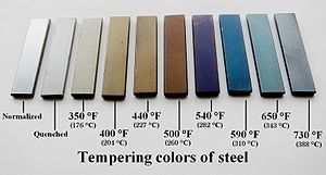

David, here's a leg up for your terminology.
The term "fire blued" is usually applied to the cosmetic coloration done to certain small parts on the early Lugers. The grip screws, front sight blade, and the sear bar spring were subjected to heat in order to turn their surface molecules a bright blue color.
Rust bluing is a slow, cold process during which chemicals are wiped onto the parts, which are left to rust in a humidity box, then boiled in distilled water to turn the red rust to black/blue. In between each treatment, the gun's surfaces are "carded" with steel wool to smooth the surface. The process is repeated several times until the proper finish color is achieved. This was how Lugers made before the middle of 1937 were finished.
Mid 1937, the Mauser factory adopted "hot dip" or "salt bluing," wherein the parts were immersed in high temperature liquid chemical salt baths. Completed in one shot, it's much less labor intensive than the hand-done rust bluing, so the factory saved considerable time/money with this process.
Early 20th century guns (but not Lugers) sometimes had a finish called "charcoal bluing," during which the parts were buried in smoldering charcoal to develop a very handsome dark blue finish, albeit quite thin--somewhat akin to fire bluing.
I think you meant "rust blue" above, for Imperial or Weimar era Lugers...although some of the small parts are fire blued, or "strawed."
File Type: jpg Tempering_standards_used_in_blacksmithing.JPG (11.7 KB, 328 views)

Thanks David, quite interesting to bear in mind.

no i meant fireblue trigger/etc....seems like 1/2 of these guns have rust blued triggers,etc ....and 1/2 came with fire/blue triggers....
i like the look as my luger has fire blue parts also....want to match it and i think its a nice feature....
i own a early 1937 luger, so im up on the rust bluing........im always looking to learn though!!!

OK, then, you mean "straw" (not fireblue). Describing the treatment thus will avoid confusing us.

He means "fire blued". The 1914 Mauser had a fire blued trigger. This feature can also be seen on other firearms of the period such as the trigger and safety lever on early Colt 1903 Hammerless

Mauser made pocket pistols from 1910 to about 1941, in both .25ACP and .32ACP. What you said "1/2 of these guns have rust blued triggers,etc ....and 1/2 came with fire/blue triggers" is incorrect. You may want to study up a little before you buy one to make sure you get what you want.
There are 3 different main models (many sub-models) of the Mauser pocket guns.
All Mod. 1910 have fire blue trigger, ejector, take down, and slide release up until 1936.
All Mod. 1914 have fire blue trigger, ejector, take down, and slide release up until 1929. Then the finish changed to salt blued, up through 1933.
All Mod 1934 have salt blued finish on the frame and all small parts.
None of them have rust blued triggers, but when they wear & age the fire blue can often fade to gray metal, which you might mistake for a rust blue.
