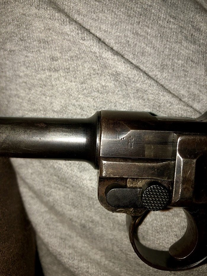

I just purchased this Luger with serial # 6469. I don't really know much about Lugers however I was told it was a 9mm which it is not. 9mm Luger shells will not fit the chamber.
Any help to identify and date this Luger would be appreciated.

The correct serial number is 6469m. It's what is often called a 1920 Commercial or an "alphabet Luger." Being an "m" block , it was probably made in 1922/1923. It should be .30 Luger (7.65x21mm), not 9mm (9x19mm) For what it's worth, the .30 Luger is really sweet shooting cartridge - you'll like it.

I'm pretty new to Lugers myself, but I've been reading a lot and especially reading this forum.
Let's see what I've learned in reading and from hanging around here. I'm sure someone will correct me if I'm mistaken.
First, the serial number is 6469m, the script letter under the serial number is actually part of the serial number. The crown over N proof mark indicates it's a 1920's commercial (not military) gun. It would be in 7.65 caliber (.30 Luger) if 9mm rounds don't fit, which is consistent with it being 1920's commercial. I THINK the fact that it is numbered in this fashion indicates 1923 or later, because originally 1920 commercials were numbered without the script letter, but I'm not sure about that date. Does it have an import mark ("Germany") anywhere? I didn't see it in the pictures.
It should have a wood-bottom magazine.
All the numbers I see are matched which is good, however the strawing on the small parts is pretty much gone.
As to value, given the condition overall, and assuming it has the correct magazine and a decent bore, I PERSONALLY would say about $700- $800, but not being a military gun it would be of less interest to most collectors. Others may value it differently.
Congratulations on getting your first Luger!
(AH! I see bill answered while I was busy typing. )
Post Script: I find that Fiocchi 7.65 ammo does not cycle my 1920 commercial properly, being a bit under-powered, but PPU 7.65 ammo works great

I do have the magazine with a wooden bottom. Very, Very small print right side and hard to make out even with a lighted magnifying glass the best I can decipher "MADE IN GERMANY"

You have a decent shooter. One thing I notice is that the takedown lever appears to be an aftermarket cast part, not an original forged and machine piece.

I have an Alphabet Commercial Luger (formerly called the 1920 Commercial Luger) which I really love to shoot. As stated above, and like yours, it uses 7.65 Parabellum (called "30 Luger" in the USA). Your serial number suggests that it was made between 1922 and 1925, though I have not been able to find any definitive serial number list that could pin it down to a specific year. I recommend you look at the Luger FAQs on this forum, and at the "sticky" posts by Dwight Gruber on commercial Lugers. If you want to reload, I suggest you look at the posts by "Sieger" on the reloading threads of this forum. Hope you enjoy your Luger!
