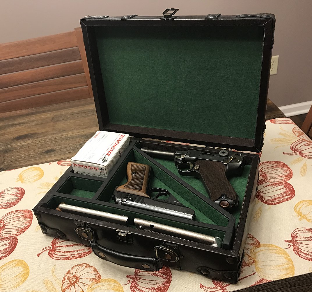

Just finished building this box to take my Luger to the range in.
Still need to get some additional latches on the lid. I don’t think one is going to cut it. Does anyone know where I could find something that may work?

Wow! Just fount the same type that’s already used on the box.
Can’t believe I didn’t think of eBay first thing.
Thanks!

Sorry I was not more clear, I built the insert and used a store bought box.
It's not perfect by any means but it was my first attempt at something like this.
I am planning on adding some flat pieces of felt covered wood to the inside of the lid to aid with keeping everything in place.

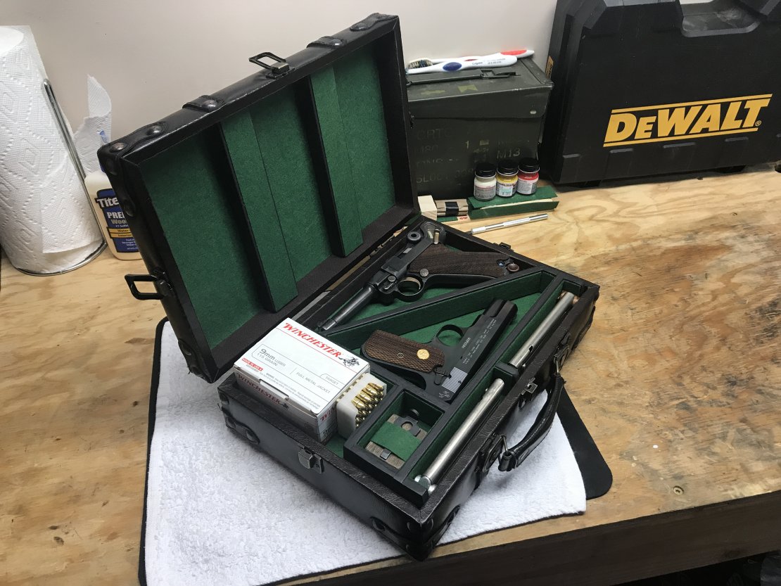

Finished up all the additions to the box.
It feels much better with the latches on the sides!

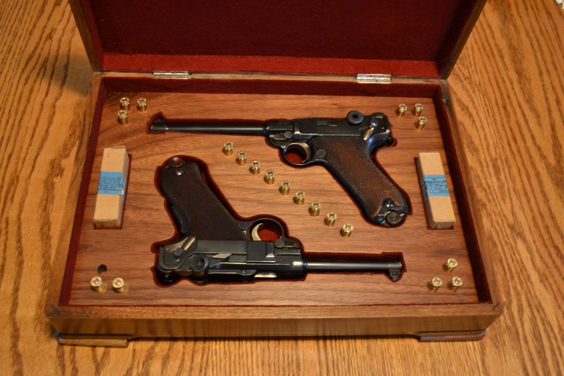

I took an old silverware box and had a friend make an insert for me. Very pleased with the results. The pistols are shooters I made from lots of mixed parts.

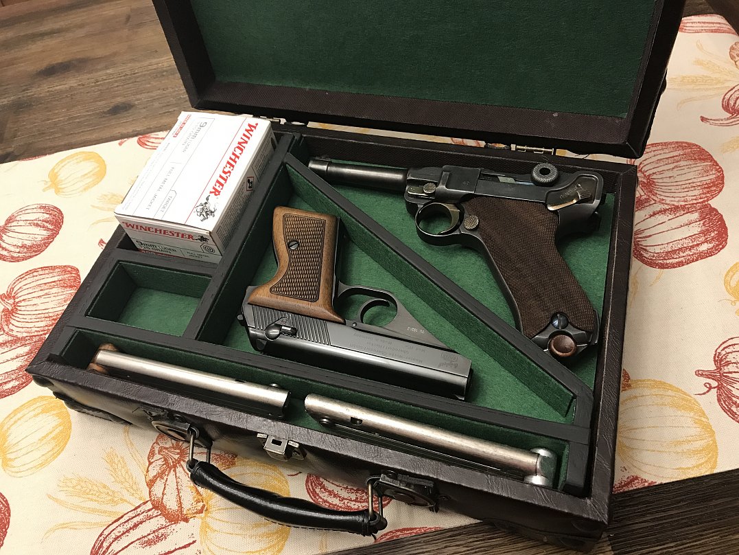

I though about molding some sort of form fitted bottom as well. I couldn't come up with a feasible solution.
I ended up using some contractor shims I had left over from installing a door.
Just used some wood glue to bond two wedge shaped shims together to make a plank then cut the parts to fit and bonded them all together with wood glue. After sanding and painting it it's hard to tell they were once shims.
I then used spray adhesive to bond the felt to the wood frame. It all fits tightly into the box with no up and down movement.
I believe the felt mounted to pine is soft enough to not damage my pistol. The frame is very strong as well.
