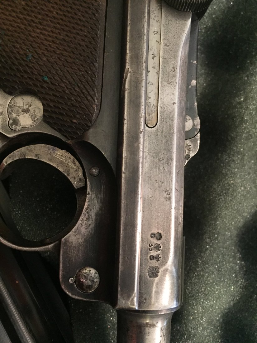

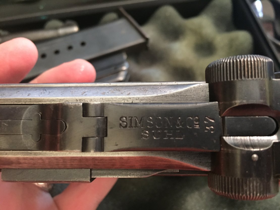

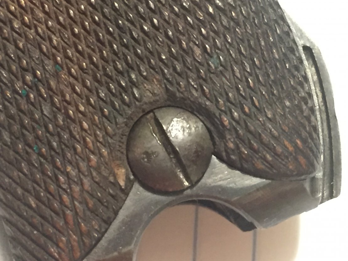

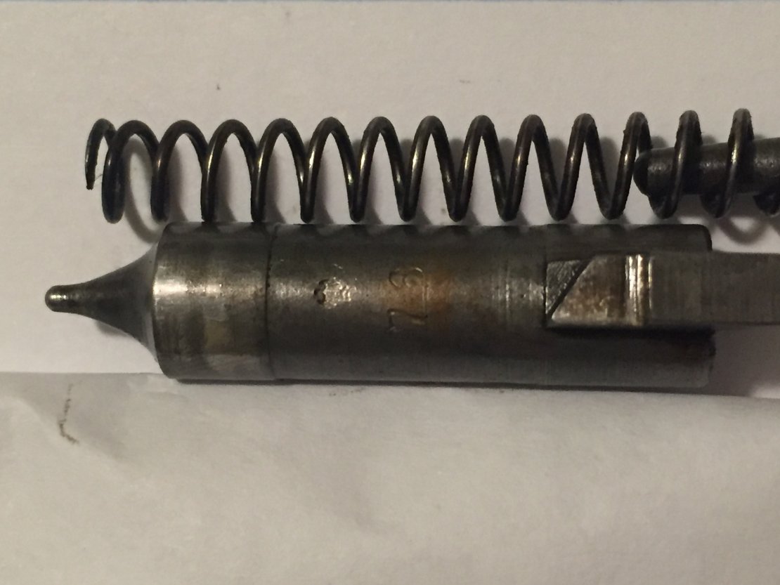

I inherited a couple German pistols that were originally picked up by a family member in Europe during WW2. I would like to shoot the Luger pictured, but am unsure if that is wise. I would hate to damage it or significantly reduce its value. Any advice is greatly appreciated!

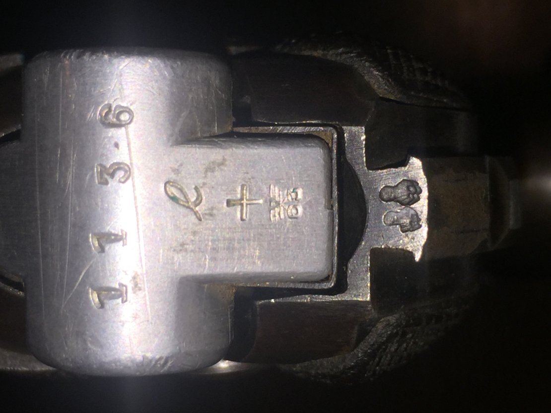

As far as I can tell, it was made by Simpson & Co. and was pre-WW2 manufacture. All the parts have matching serial numbers...almost. The clip does not match and the firing pin is stamped "73", I'm wondering if that was a manufacturer mistake since the other parts are stamped "37".
Your comments are appreciated in advance! Thank you

Welcome to the board.
Your question has been addressed countless times- what it comes down to is- it is up to you.
Breaking a numbered part will reduce its value, but if you inherited it- it was free- so not a big issue.
It would be worth more to you as a family related item than anyone else, JMHO.
If the striker(firing pin) also has a small eagle/6 stamped on it, it may be an original Simson part.
If not, it has already been replaced once.
Some folks worry a lot about "breaking" a luger, I don't, if you use regular 115 gr ammo, not +P and not Nato, I would shoot it.
The parts that break more often- but not really often:
ejector
extractor
striker
On a Simson they would all have the small e/6 - parts which are hard to find.
You could always buy spares and replace them before you shoot.
Do a search for shooting my luger, and read all the opinions.
Everyone has one, and they are usually different!
The safest way is to buy a shooter luger and shoot it!

As far as I can tell, it was made by Simpson & Co...
If that it what it says, then it is a very poor quality fake...
Old 10-09-2017, 08:30 PM   #5
Now Rich, be nice. This is the new collectors forum.
JShark,
what he means is "Simson" as in the luger producer is spelled without the "p".
Someone corrected me in my first post also, something I'll not forget.
There is a "Simpson" luger seller though, in Ill.

Corrected, thank you for the explanation for DonVoigt. And I read your response on my mistake post. I didn't notice the stamp on the firing pin, so I assume it was a replacement.

I need to ask a couple of questions
1. it is 1237 and NOT 1237a?

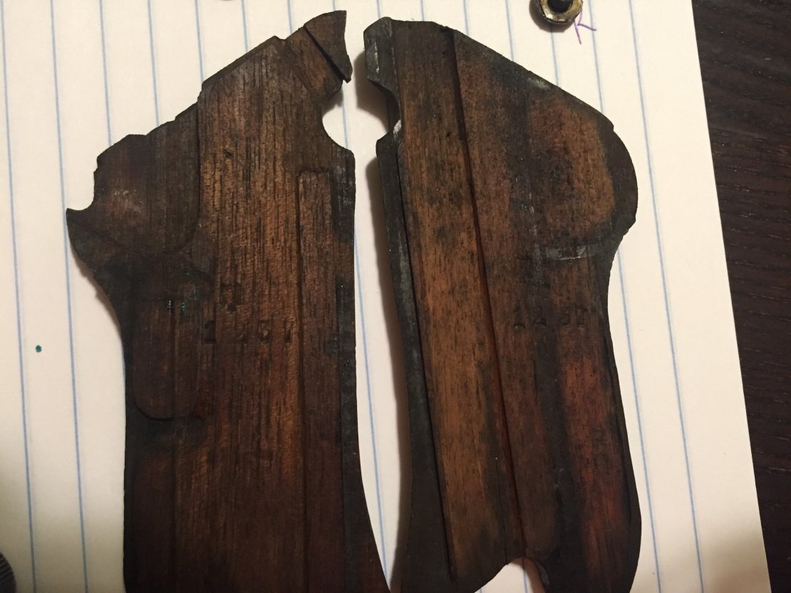

2. look at the bottom of the stock lug, it should have two eagle 6's
Its in rougher shape, lots of bluing loss, of course I would still buy it if the price was right
I will assume it is 1237, the firing pin being messed up by the factory is very unlikely - much more likely it got swapped accidentally by a soldier or at the company.
Grips should be marked 1237 - which is unusual, most lugers the only have the last two of the serial number.
1237 would have been made in late 1926 or early 1927 for the army - there were a total of less than 12,000 Simson lugers made. BTW, I have accidentally written Simpson - oh well
Old 10-09-2017, 10:40 PM   #10
There were only 12,000 Simson Lugers manufactured between WW-I and about 1933. These are so rare that I personally would not fire one under any circumstances.
Almost every part has an E/6 acceptance stamp, including the grip screws. if you lose or break a part, they are literally made of "unobtainium".
An original Simson firing pin would have a E/6 mark as well as the number. if this is missing, it's a replacement. If it's present it could be original.

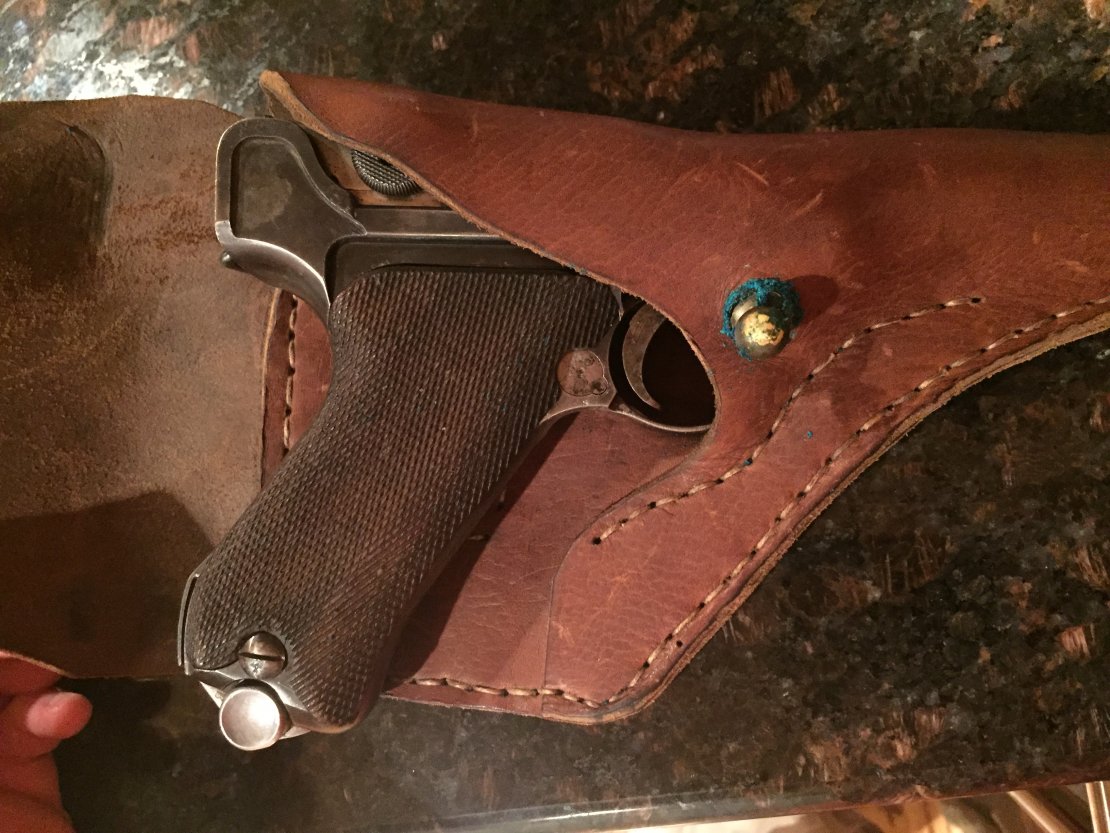

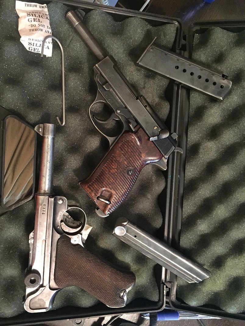

Thanks for all the advice. I love history and these guns are certainly part of it. I don't ever plan on selling this gun, so I'll feed a few rounds through it. I suppose that's why it was made after all. For those of you that like history, I'm told this Luger, along with a P38 pictured above, weee picked up off the battlefield by an uncle of mine. His name was Sgt. Hilliger and he was attached to a forward communication unit. He carried the Luger as a personal sidearm for a few years, until he "found" the P38 and decided to carry it instead.
Here are a few more photos and the holster he carried. I assume the holster was made somewhere in the rear,as it doesn't have any German markings.

The firing pin is, in fact, a Simson accepted firing pin.
There are factory "errors" where serial numbers are misstamped. It's more likely that you have something like that.

Your holster is not German military. It was probably not made in Europe either.
