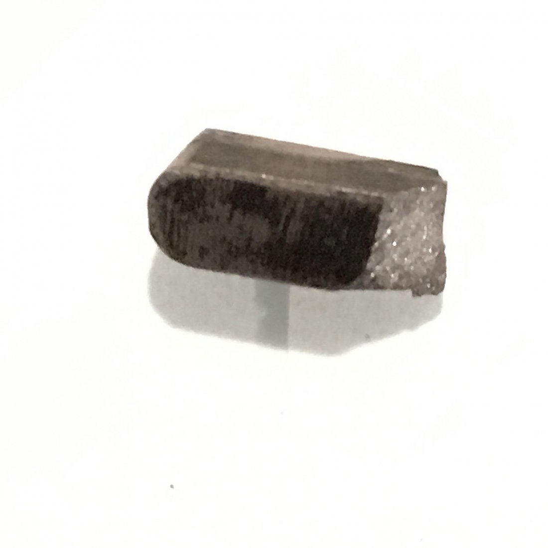

Hi All,
Is there any way to bond / weld these two pieces back together? I know this is a "long shot," but I'll take the risk and ask anyway.
Photos below:
Thanks for your time and advice

You can shoot the pistol without the hold open. Just leave it out of the gun.
It's a part that requires fitting, and is somewhat precision in manufacture. You would probably get the best results by replacing it and the spring.
The part is hardened. It's interesting to see it snap there...
That is were they all snap. And I have witnessed personnaly a significant number do just that, generally jamming up the action as it happened to RShaw. Which is just what one needs in the middle of a match .
Never happened to me, because as I said in the other thread I remove it prior to shooting.

From my hearsay knowledge of micro welding, I would say the real question is cost. A tungsten inert gas ("TIG")micro welding expert can weld very small parts. There are also other methods. You'd then need to have a skilled person shape the part and re-fit it to the pistol. Both require expertise and equipment.
I asked Charles Danner about TIG welding once, and he said that while he didn't do it he had a resource. Charles is an expert rust-bluer of firearms, I don't have his contact data with me as I write this but you could find him by searching the forums. My exprience in getting one-off things repaired via skilled welding is that the hard part is finding someone. Intricate welding is almost an art form and artists can be "challenging" to deal with. That said, a well-executed weld repair is IMO a thing of beauty itself.

No matter how well the weld, it is still going to need 'fitting'. Milling preferably, filing probably. It will never be original; it will always be 'repaired'.
Best to just get an un-numbered holdopen and keep mum about it.
