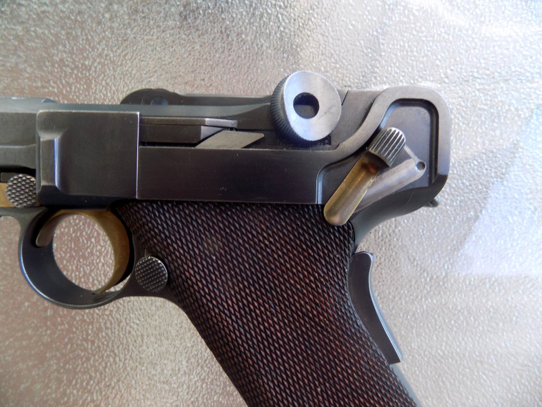

An example~1902 Fat Barrel~ Thank You Ron~

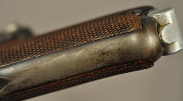

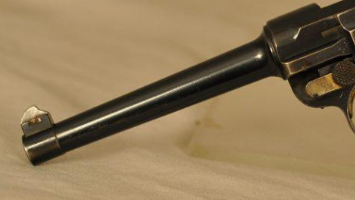

Sorry for delay, seller just emailed these. Does the barrel look to be reblued

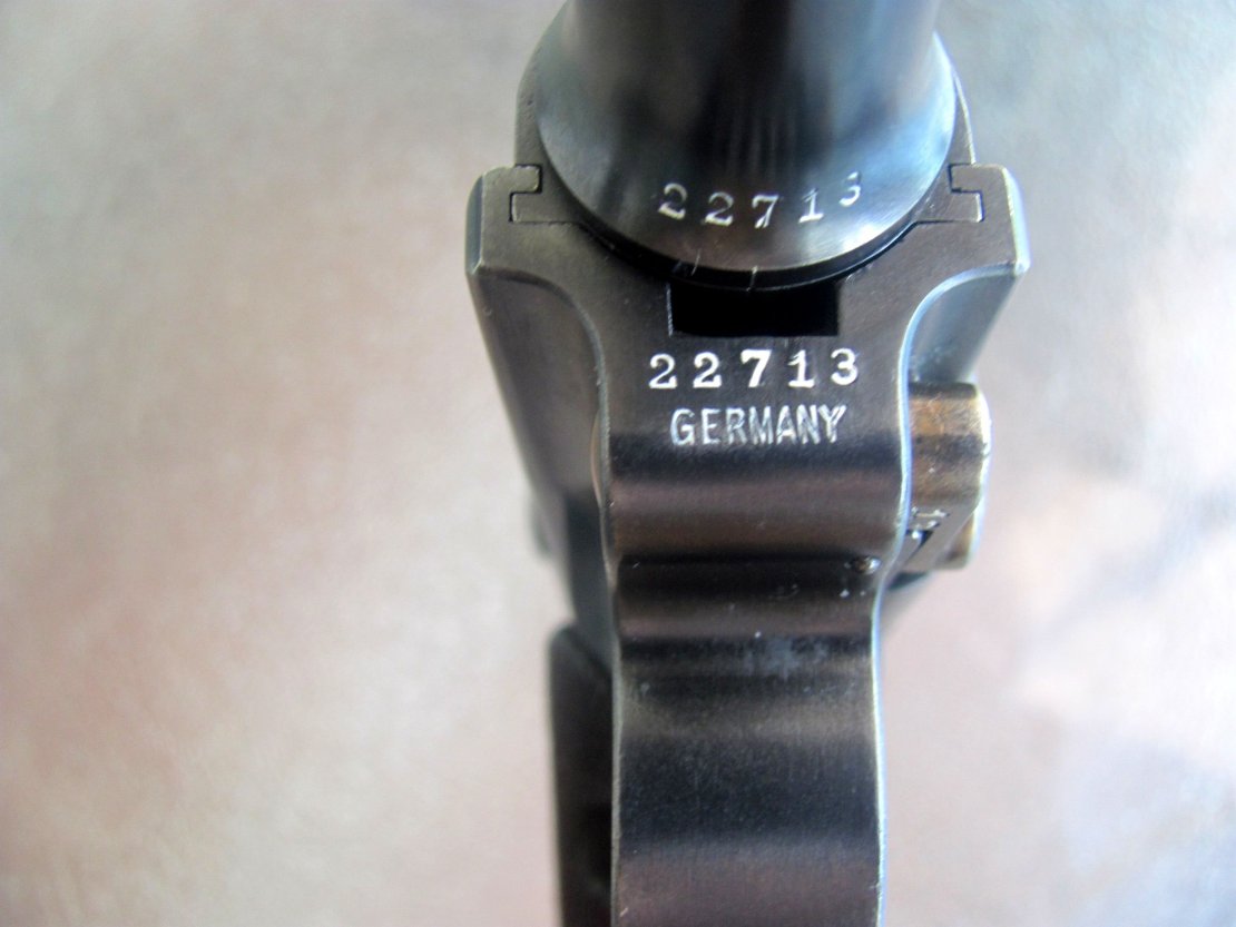

Does the 'Germany' considered a halo?
Unread 07-14-2017, 07:35 PM   #14
Posts: 3,403
Thanks: 7,569
Yes, Eric, this appears to be a halo on steroids! It is even and distinct to the max.
Also, do I member correctly that the s-link for the mainspring should be fire-blued? And the grip screws?
Anyhoo... a very nice M1900 Nick a great find. I may speak for others if I ask if you mind divulging the price range. I'm betting you did well...

This looks like a nice honest 1900 American Eagle. Very good for a gun that is 115 years old. Please tell us what the proof markings are.
Unread 07-15-2017, 09:30 AM   #16
Eric, your 'fat barrel' has the white goop obscuring the 'GERMANY' stamp...Does your 'fat barrel' 'GERMANY' have a halo???
Unread 07-15-2017, 09:43 AM   #17
Need more pictures of this barrel. The blue on barrel does look too nice for a gun in this shape.
But putting that small technical detail aside, bigger picture is also important, probably more important. For commercial pistol that has many survivors, only top ones could demand premium. Just be honest is not enough, it has to be honest and super nice if it's not cheap. For what has been presented... it is not in that category. If you let it come, it has to be cheap.

As the gun is not in hand I can only provide the pictures sent. I see no proof marks anywhere in any of the pictures I've received but based on everything else I feel confident they are legit. Not even sure where they would be present on a 1900. I'm slowly gaining a perspective of original finishes and what to look for but have a very limited knowledge of value on a piece like this. Simpson has quite a few for review but thier pricing is all over the board. Gunbroker completed auctions show these going for 1100-1700 with the occasional 3k reserve that never gets a bid. So I guess what I'm asking is a value assessment on this particular 1900

I agree with alvin the barrel seems too nice compared to the receiver, some more up close, detailed pictures could probably be useful.
Flash photo burns out the middle and leaves the rest too dark to see, outside in open shade works good, preferably on an overcast day.
Nice finding anyway.

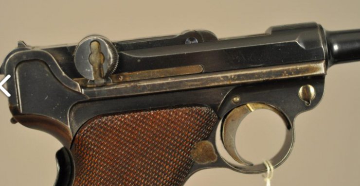

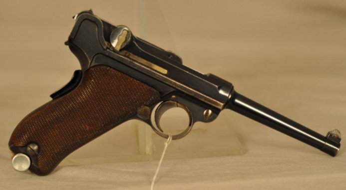

Default barrel pics
barrel pictures
File Type: png Screen Shot 2017-07-15 at 10.12.26 AM.png (133.7 KB, 220 views)
File Type: png Screen Shot 2017-07-15 at 10.11.22 AM.png (97.1 KB, 427 views)
File Type: png Screen Shot 2017-07-15 at 10.11.38 AM.png (77.1 KB, 348 views)
