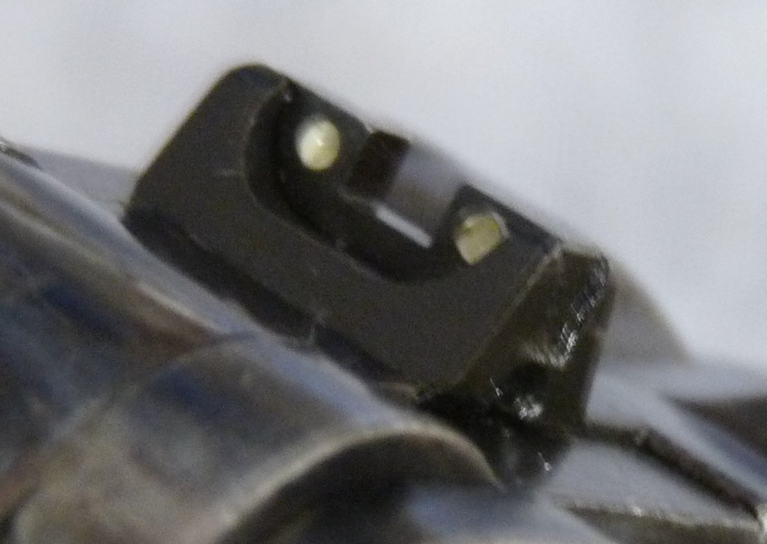

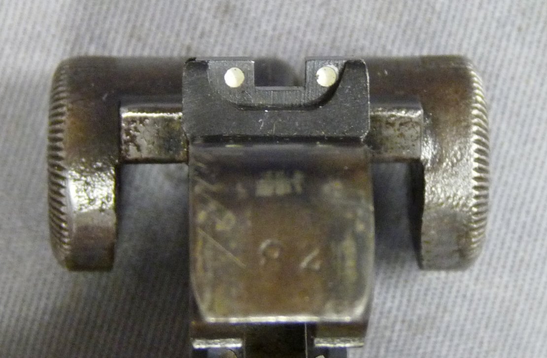

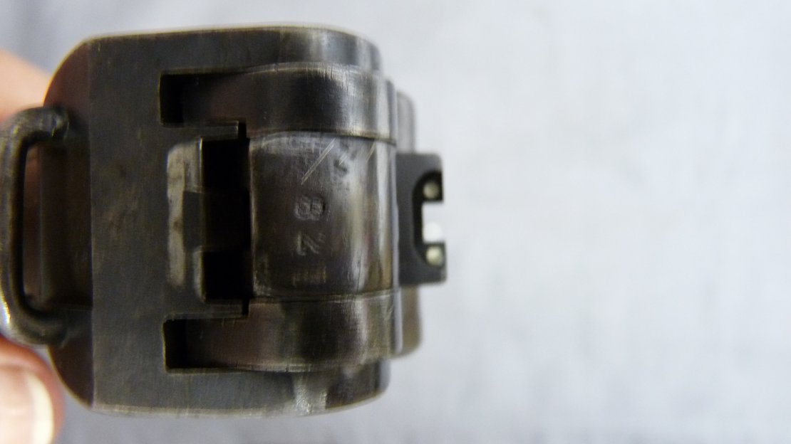

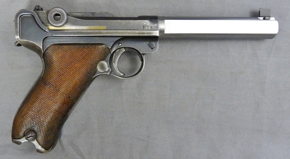

I advise strongly to stay away from any 'smith for trigger work- they quite likely will make it worse or cost you a lot in parts replacement.
Practice with the trigger, you can and will get better.
or if you really want a target luger- buy or make one!
There is a Mauser "Sport Modell" on sale here or the other forum- it has adjustable sights.
Or do what I did , sorry for the fuzzy sight pictures :

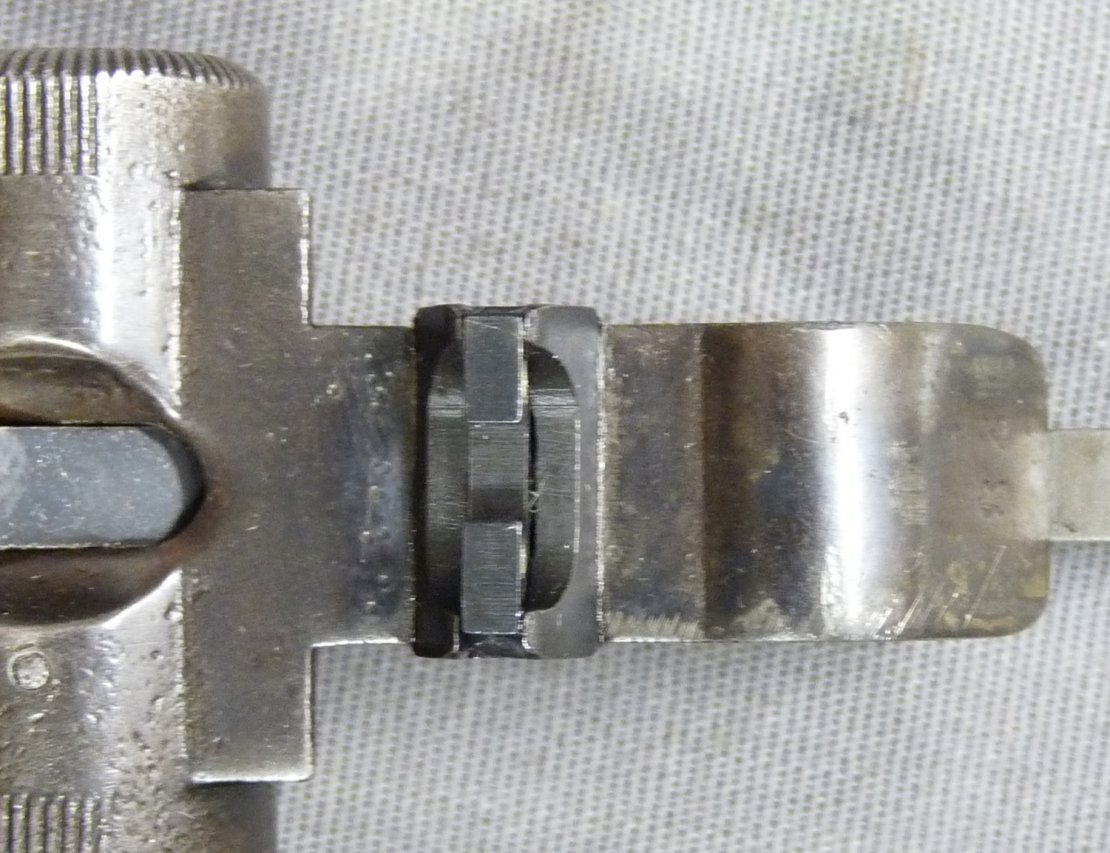

Hello,
@DonVoigt
which kind of front sight you used? is it possible to show a picture from top (rear sight)?
thank you

Bmax,
the front sight is available from Brownell's; it fits a "Mauser" rifle slot and I think it is made for fitting to many different applications.
The rear sight is a slightly modified Beretta 92 pistol rear sight.
The lower area of each side was relieved to allow the toggle to close as the sight is slightly wider than the distance between the "forks".
As this one was an experiment, I used a file; a cleaner job could be done by milling the bottom of the sight.
Welcome to the board and hope this helps.
