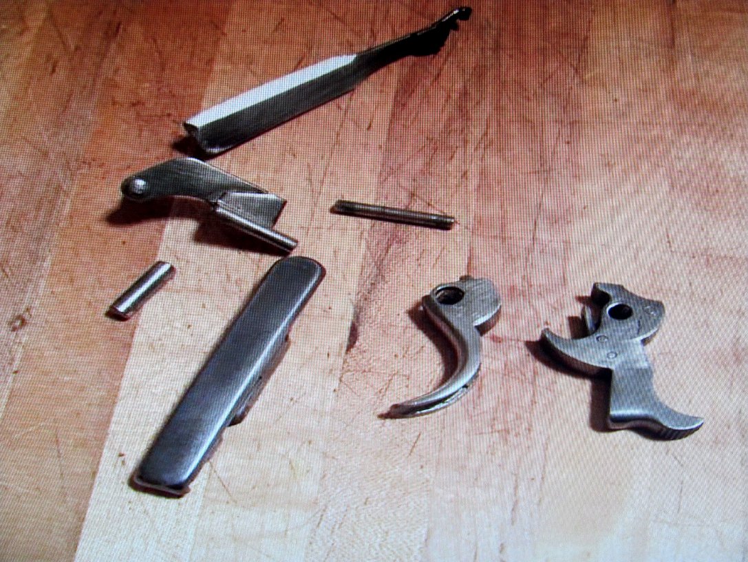

Here is a strawed Luger and a Mauser Luger with blued parts. Two of the 400 +- Lugers I have restored.

A prior straw thread from a few years ago! http://luger.gunboards.com/showthrea...sh-Restoration
