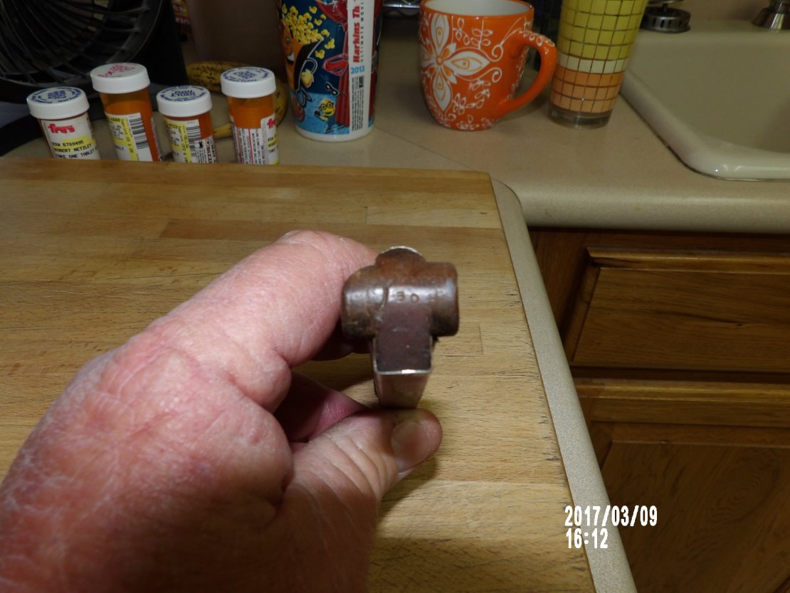

I'd be interested in seeing photos of the "two matching numbered mags".

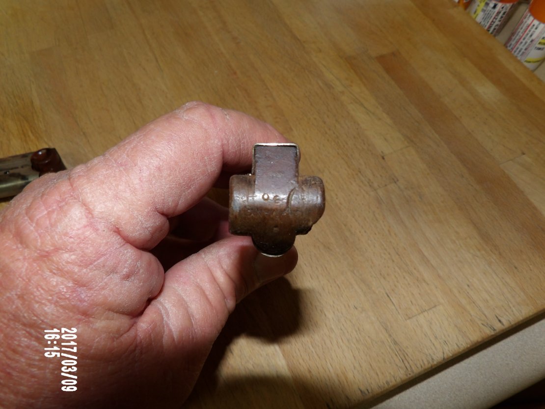

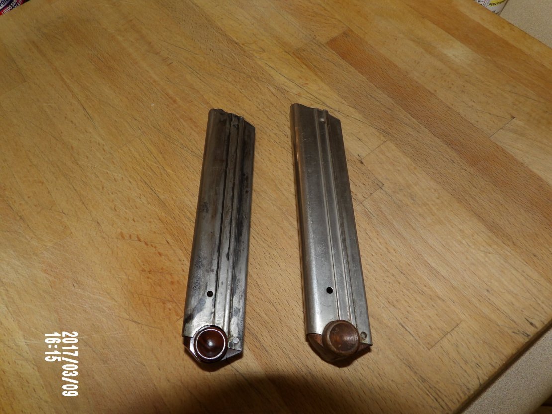

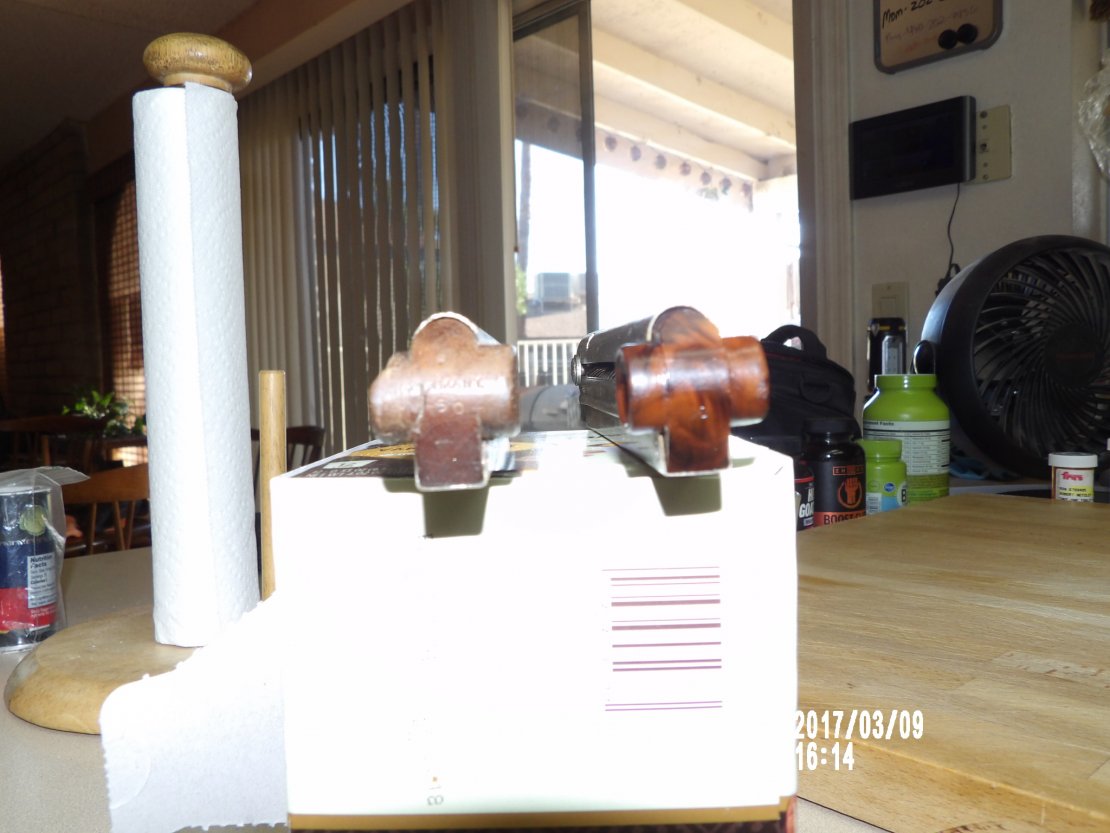

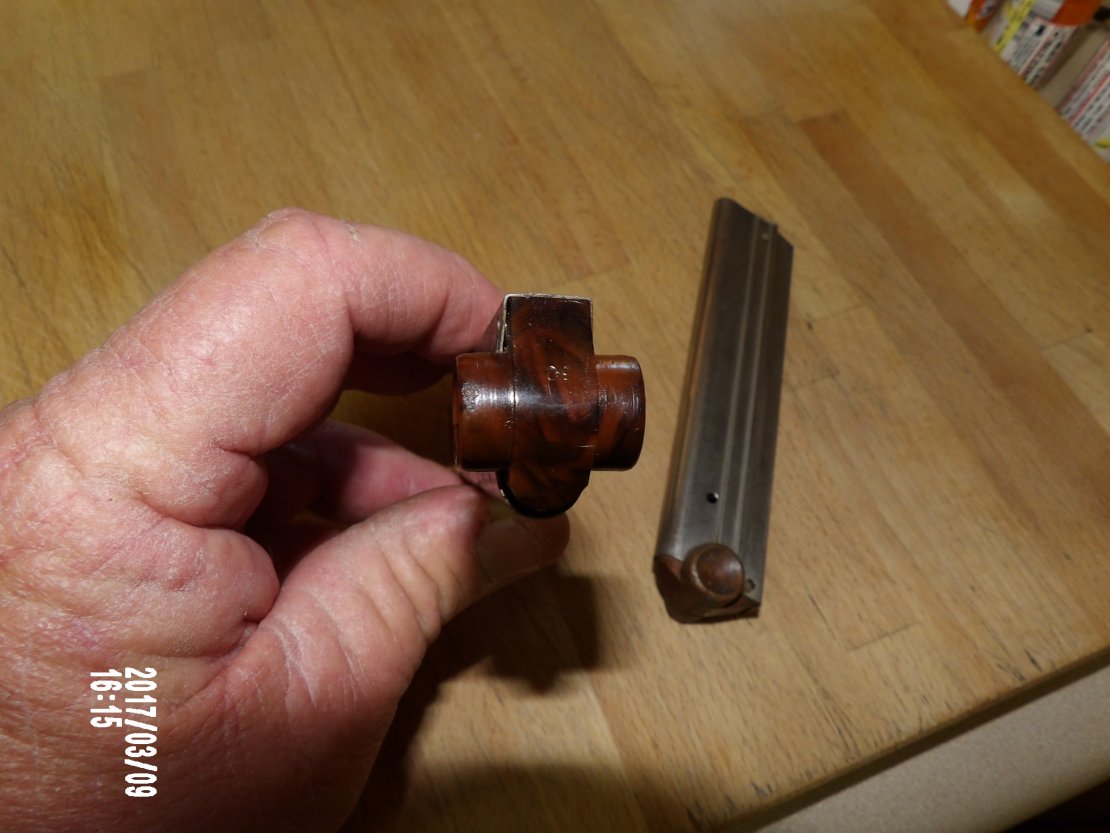

Thanks for the response attached are the pics of the mags
1 of them says Germany and the the last two of the serial 50 the other 1 just has the last 2 of the serial I also have the holster

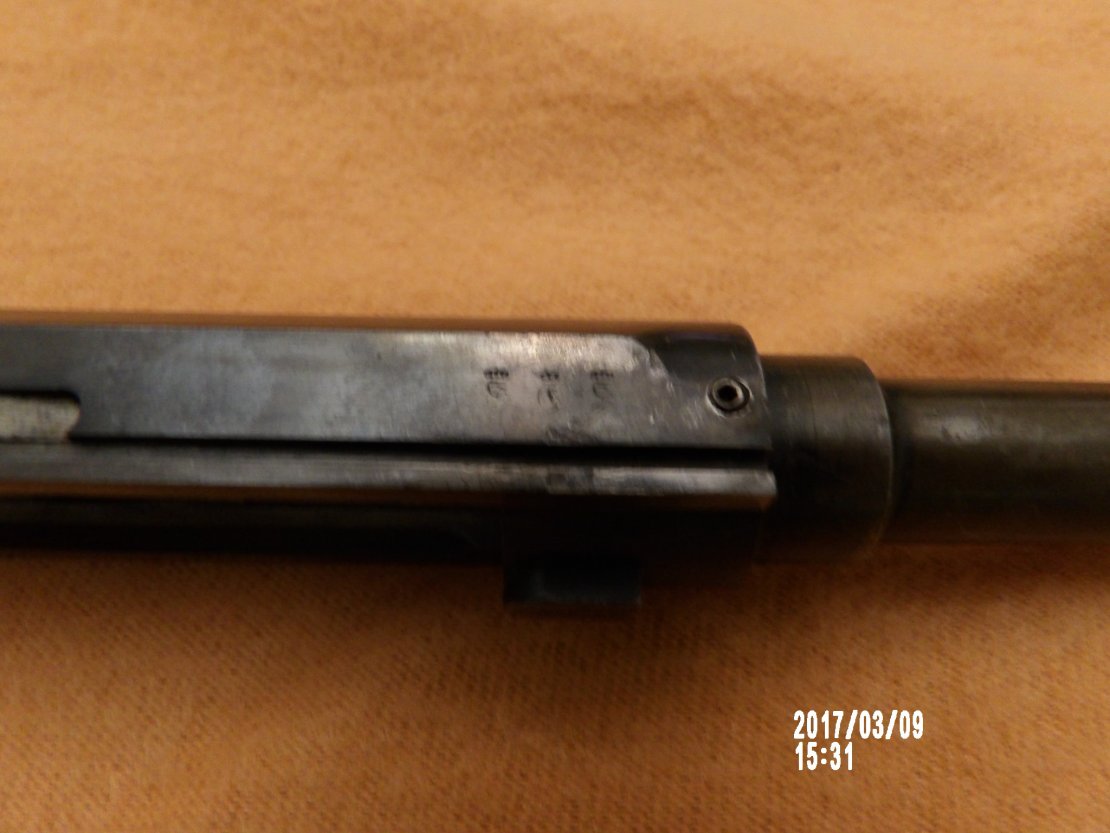

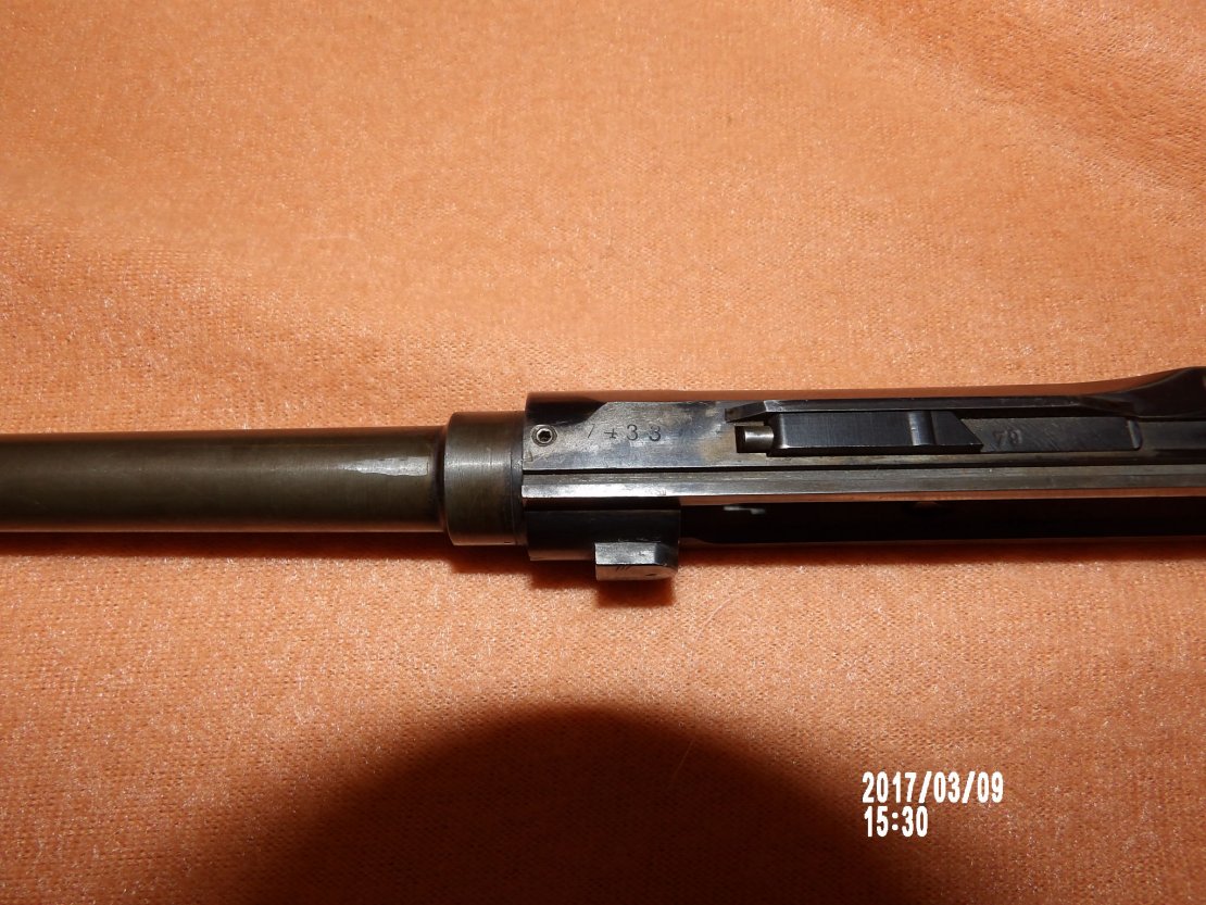

On another note I have an 11'' barrel serial 7438 attached are pics

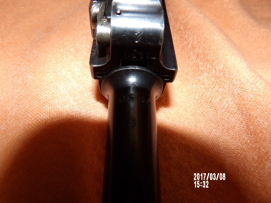

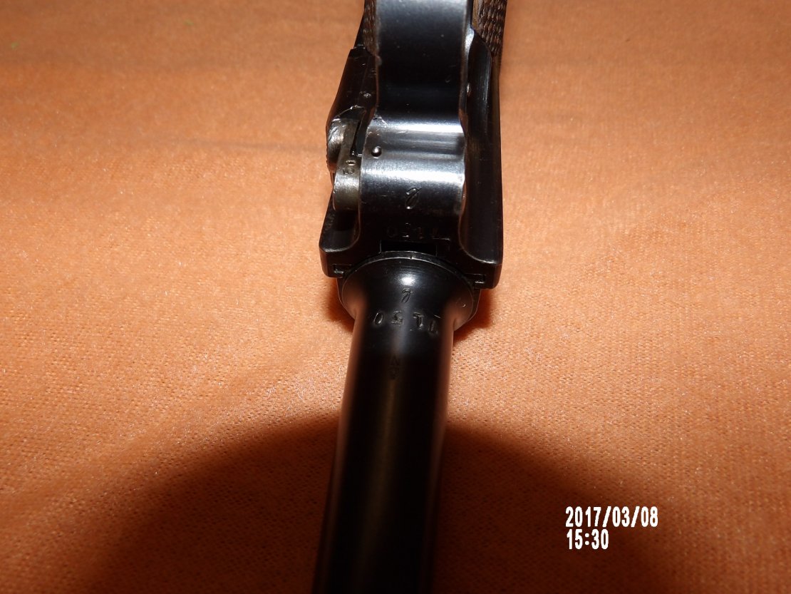

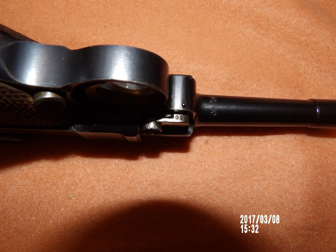

Your upper was made from a 1914 military P.08's barrel extension and an aftermarket barrel which was very crudely installed. The barrel extension was over-worked, as is evidenced by the shallowness of the 1914 manufacture date. It could be set up as a novelty piece for shooting, whether by you or someone else. One member recently bought an LP.08 (Artillery) upper, which he puts atop the frame of another gun--now it's two in one.

For a military gun the magazines should both have the full serial number and the suffix letter too, so the "50" is doubtfully original, although both are from the correct period. Commercials generally came with un-numbered magazines.
That long barreled upper does look interesting and would be fun to play with as a spare.

I am a bit concerned about the use of two set-screws on the long barreled Luger... one on either side of the upper receiver, that appear to hold the barrel in alignment. There should be no need for these screws and the modification of the receiver to hold the barrel in place.
Has anyone seen this type of barrel installation before on a Luger?
Unread 03-10-2017, 12:08 PM   #11
John, I have not seen the use of set screws either. The suffix letter on this creation appears to be a lower case L with DWM military inspector's marking on the right side of receiver. TH

Try taking the set screws out and see if you can unscrew the barrel by hand. Maybe clamp the extension sideways in a vise (without crushing the forks) and wrap a rag around the barrel and try to unscrew it.
I would guess the setscrews are a 'bubba' solution to timing the barrel to the extension. Best case scenario, you'll be able to unscrew the barrel without too much effort. Worst case is that there are no threads on that 'bubba' barrel and the setscrews are the only thing holding it in place...
Unread 03-10-2017, 01:33 PM   #14
I'd suggest removing the set screws to determine if the barrel is free to come out then. If not they may be there to stop any rotation of the threads, as this barrel doesn't have the "shoulder" to butt up against the extension. If, on the other hand, if they are removed and the barrel pulls out , then it is probably time to hang it up.
Sheepherder, If the barrel threads in, then the set screws would not be the only thing holding the barrel in place... however if, as David has suggested might be the case, the barrel is just a pressed in fit, and the set screws are the only thing holding the barrel in place, this receiver is toast.
David I agree with you, It looks to me that it was a former .30 caliber rifle barrel that was used which had sufficient diameter for threads, but insufficient diameter to create a shoulder. Set screws might not be an elegant "bubba" solution, but I don't believe a screwed in barrel with set screws to prevent rotation would be a dangerous situation.
