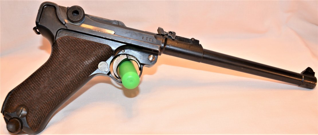

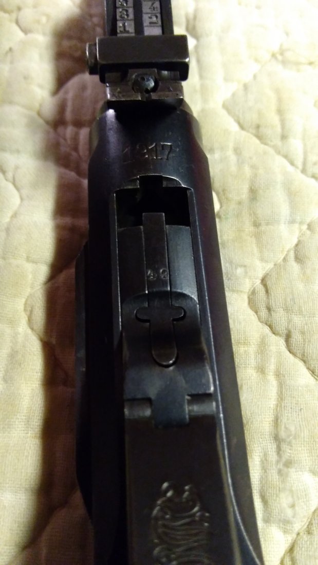

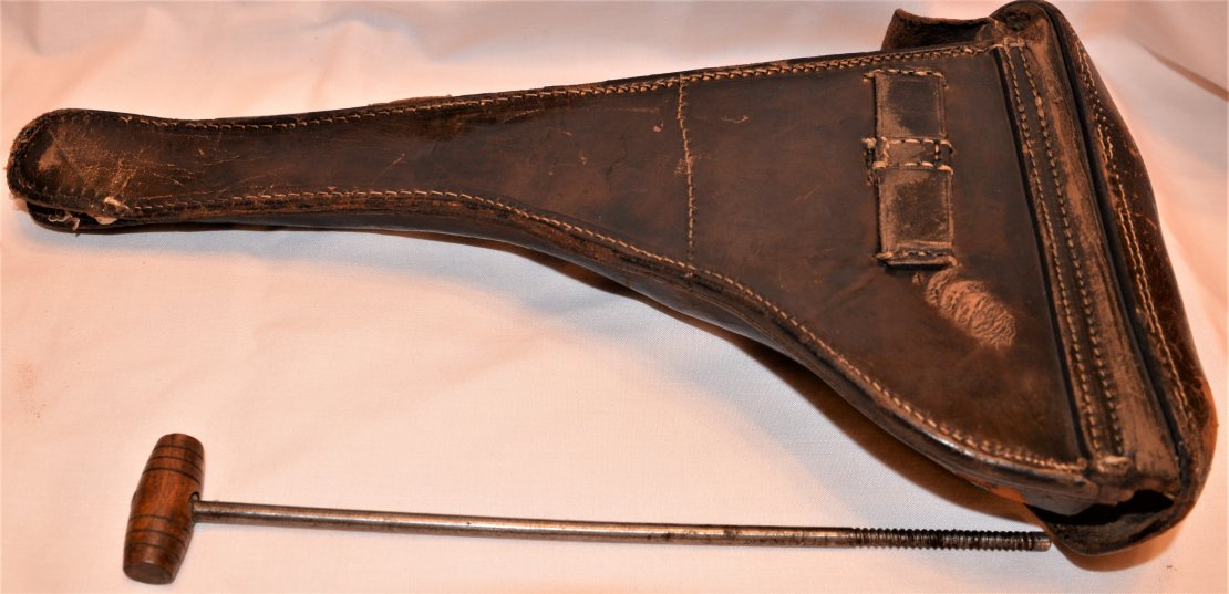

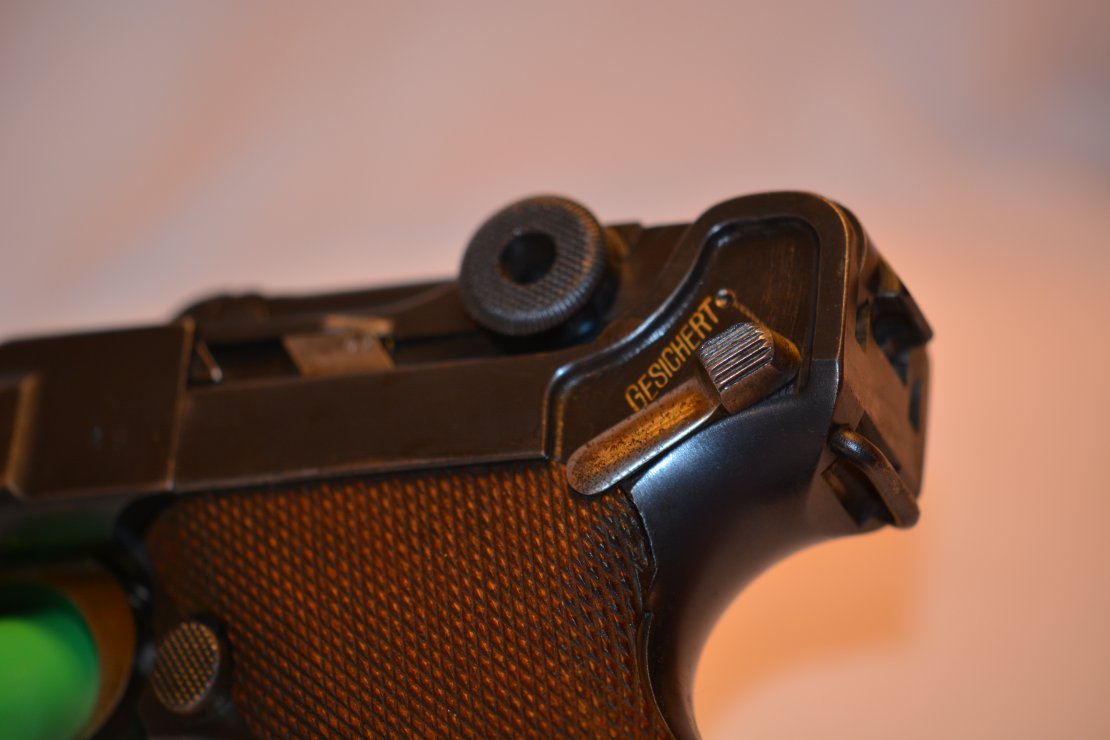

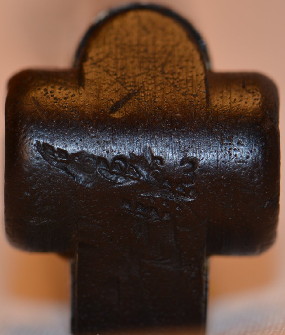

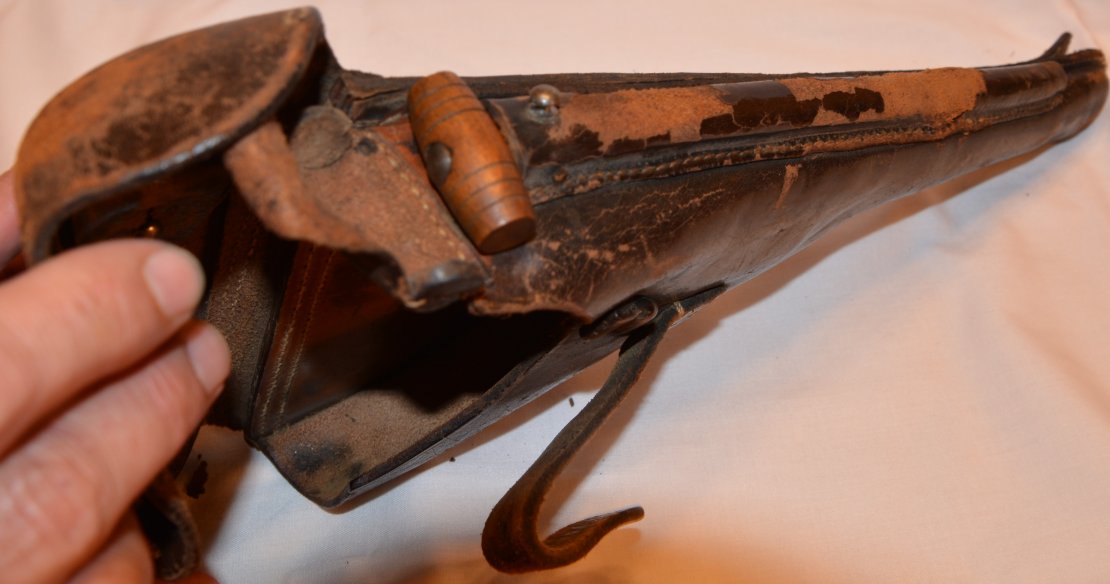

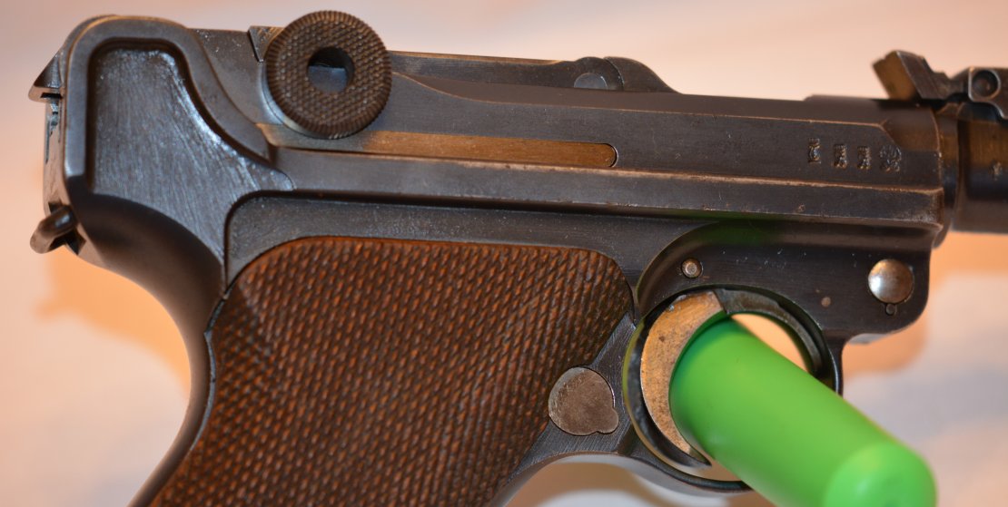

Thanks for taking the time to look at this. My son inherited this gun and he volunteered me to find out what I can about it. Any help is appreciated. More pics are available. Just ask.

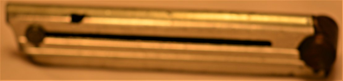

I believe the numbers on the butt of the magazine are 9263.

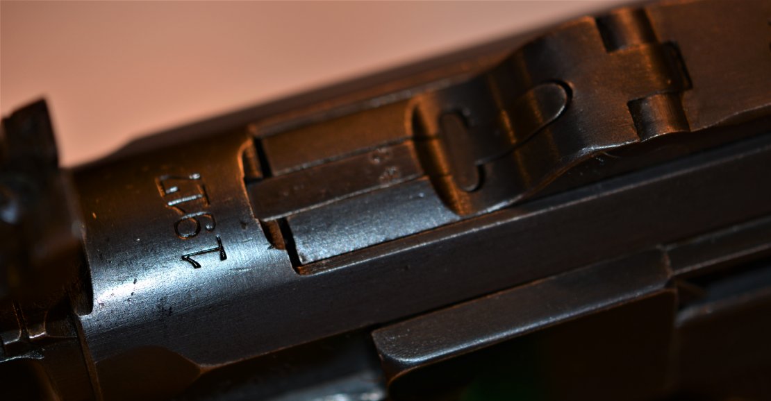

Looks like a very nice military Artillery Luger, not perfect but much nicer than most. Finish looks original, but you need to check all the internals for correct numbering. Mag. is obviously a mismatch. What specific questions do you have for us?

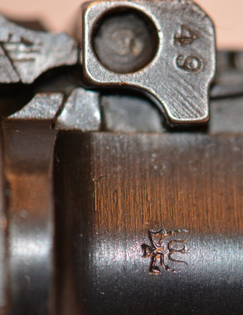

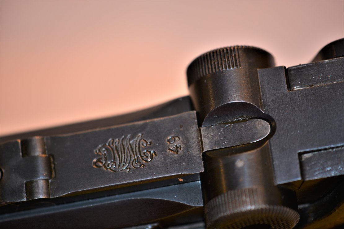

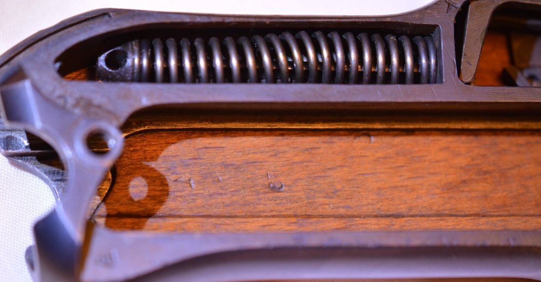

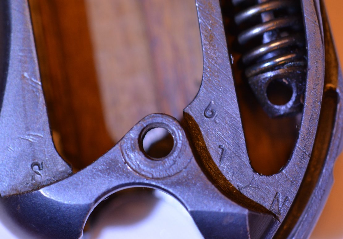

Thanks for the quick response. Not sure I'm' the person to disassemble but will look into what it takes. From what I can tell, all of the external numbers match. We removed the grips, wondering if they were numbered. Appears to be 67 stamped in the wood. Any thoughts on that?

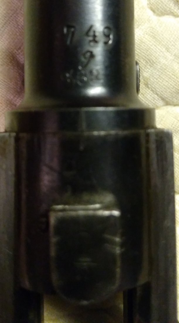

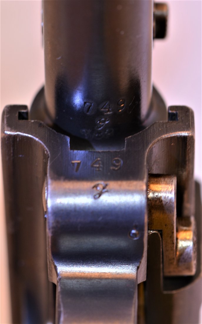

The grips would have had "49" inside when made, so the grips are replaced somewhere/sometime. Well I am guessing the serial number ends in 49, but I can't see the entire serial, it is on the front of the frame, bottom of barrel and left side. Those pictures would be good to post.

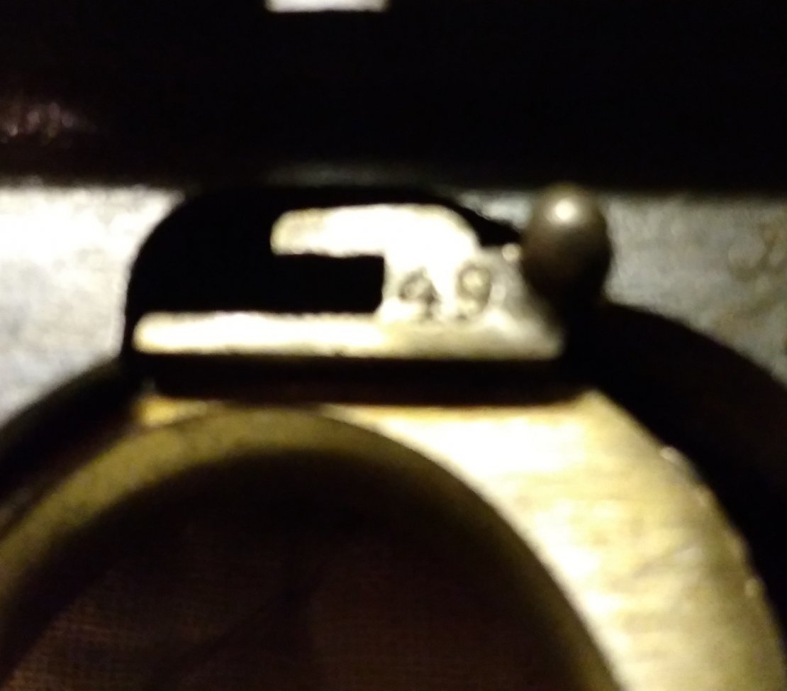

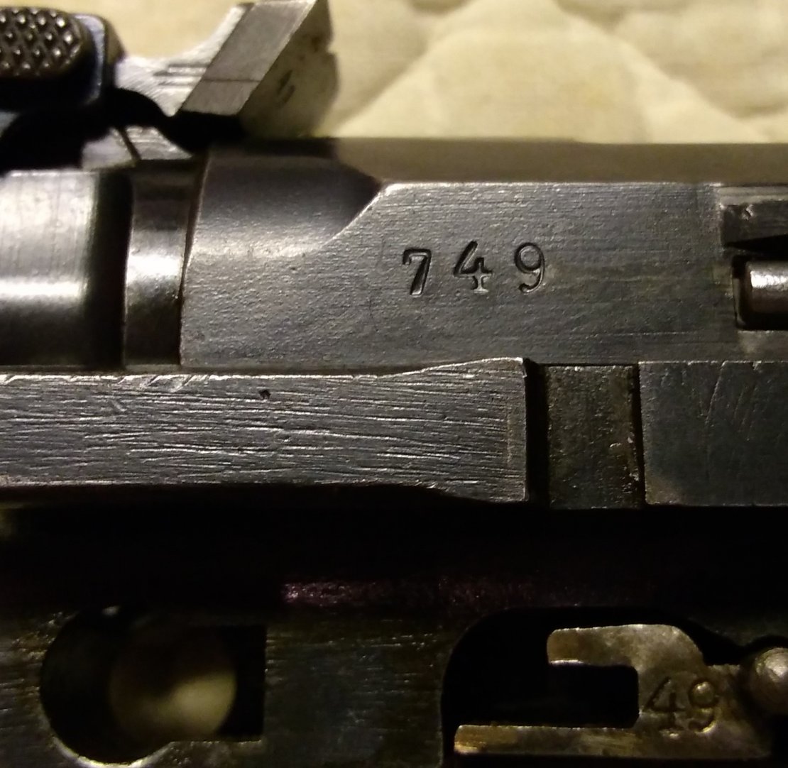

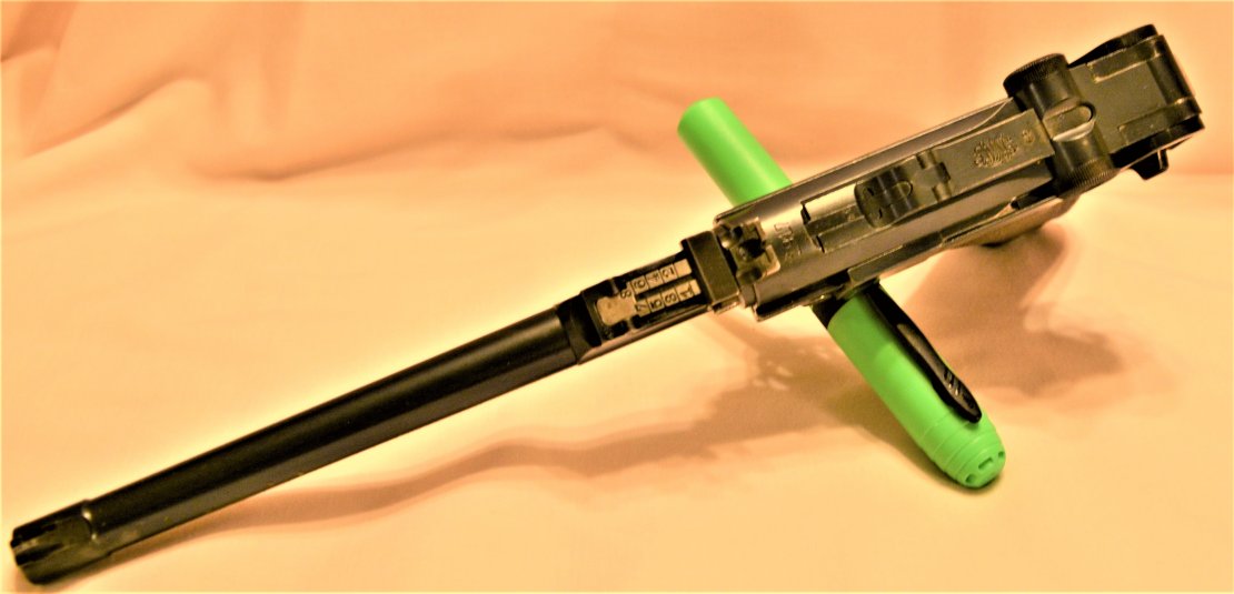

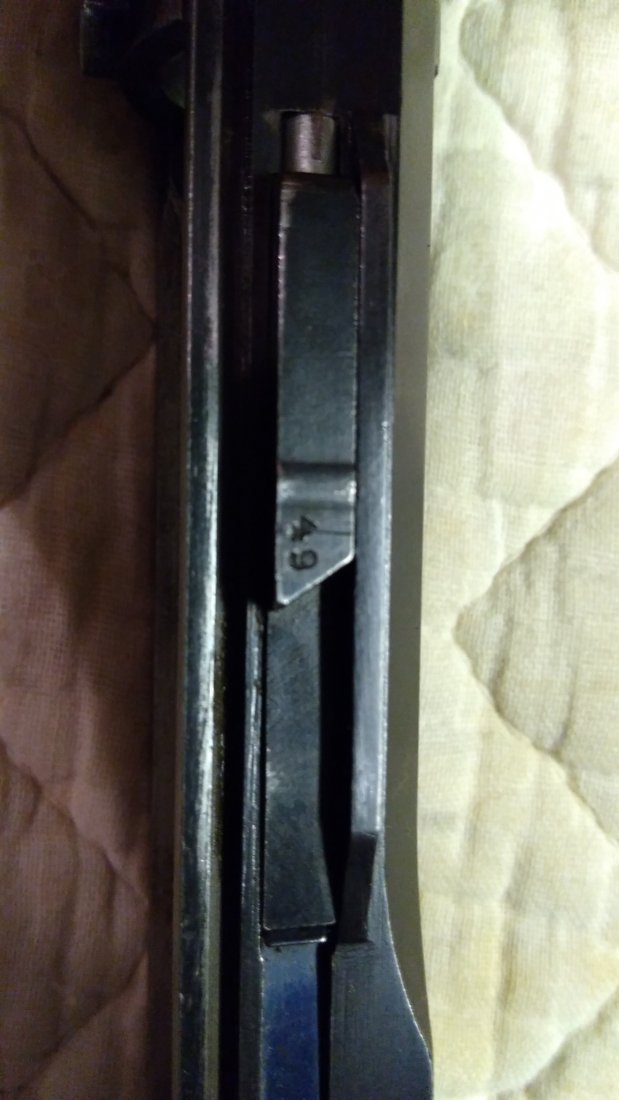

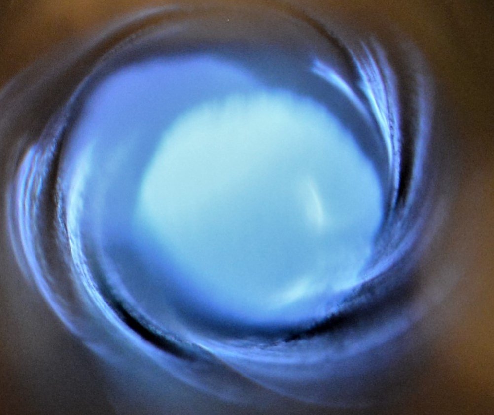

Disassembled today and believe I got the matching internal numbers suggested?
Eotlou is offline   Reply With Quote
Unread 02-26-2017, 07:43 PM   #19
kurusu
Join Date: Sep 2007
Posts: 1,225
Thanks: 2,679
You are still missing a photo of the left side of the breechblock that's where the number is.
Unread 02-28-2017, 01:35 PM   #20
Eotlou
Join Date: Feb 2017
Posts: 14
Thanked 4 Times in 2 Posts
Default Pardon my ignorance......
I'm not knowledgeable of pistol components, can you give me an idea where to look for this number? Do I need to disassemble to locate?
