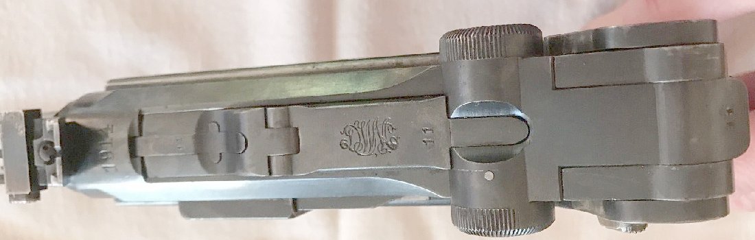

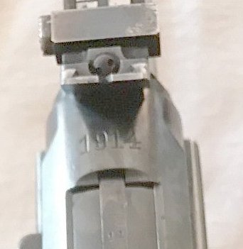

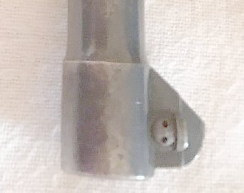

Unread 02-26-2017, 01:46 PM   #5
I can't read the date very well...
Looks legit.
Fine tune sights front & rear.
