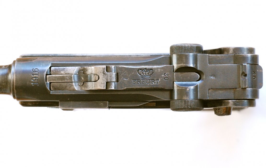

My main area of concern was the "Erfurt" stamping looking a bit buffed? Which could either indicate a rebluing or a renumbering? As previously stated I am new to Lugers but know that this sort of thing happens/happened frequently with German arms due to their post war allure.

Hi David,
After 1914 most Erfurts had notched receivers, but certainly not all.
Regards, Norm

Norme's example certainly does have a strong crown toggle stamp.

Am looking at Norme's photo of the receiver and toggle, and comparing it to the 3rd photo of hollowpoint67's first post. Big difference! In the latter, very worn "Erfurt" as opposed to a very sharp "83" versus evenly worn "Erfurt" and Serial #. Also a very crooked line in the joint just behind the extractor versus straight and at right angles.
