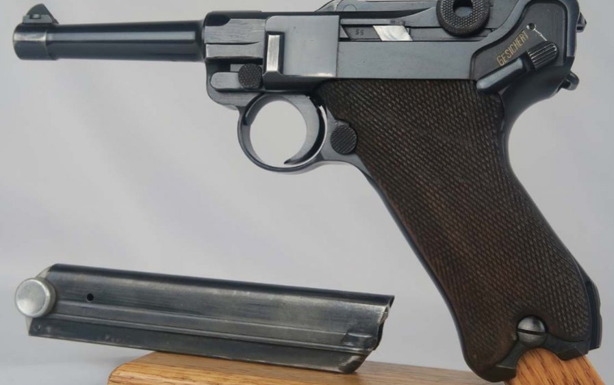

Hi All,
Enclosed below is a photo of a Luger P08 (not my own). The color of the grips in the photo is virtually identical to the color of the grips on my 1917 DWM. My DWM is shown in my avatar, but the grip color in that photo is not accurate.
My question is, is the color and condition of the grips in the enclosed photo OK? Or would you experts say they need cleaning? If cleaning is needed, what's the best way to do that?
I have not had the grips off my DWM at all... have not attempted any cleaning at all. Appreciate any and all comments. Thanks

Grips look fine. Whether or not to clean the grips is up to you. I personally do not clean my grips. It bothers me to see a 95% or so luger with brand new looking grips. Grips and metal should have the same use look. But the luger is yours to do whatever pleases you. Bill

Ahh thank you. Then I won't clean them at all- saves me the work, as well as the risk of causing irreparable damage. Good point you bring up- "Grips and metal should have the same use look." I hadn't thought of that.
What I want to do with this gun is to preserve it and keep it in good condition. It's my first one ever; I originally bought it to shoot. After going through the "shoot or not to shoot a colectable" debate, I decided that this gun should be kept safe for posterity. Keeping it in good shape meant to me to bring the grips to a more realistic condition if the color were off or they were excessively dirty. Your reply answers my question very well.

If you feel that your grips have a bit of "buildup" in the checkering, I have used a soft toothbrush to remove any. The toothbrush will not harm the wood, nor will it change the color of the wood.
If you ever decide to remove one or both grips, then you can look at the backs of the grips to determine what the original color of the wood was when they were made. That will give one a bit of an idea of the "aging" of the wood over time and usage......also if oil was applied to the grips.

Grips in that good condition with uniform color I wouldn't touch at all. As Bill said, the appearance is commensurate with the condition of the gun and properly reflects the age of the piece. JMHO.

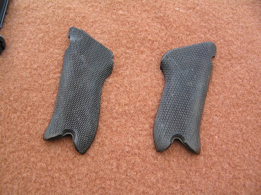

Below are before and after pictures of some M1900 grips that I cleaned. It was an easy decision as the grips seemed 'too dark', left grip had the safety chip and the pistol was a shooter.
Description of process in this thread:
http://forum.lugerforum.com/showthread.php?t=34747
It's now been over a year since I cleaned these, and some others. What I have found is after cleaning, the grips slowly darken a bit as the months go on. Likely, darker material below the surface wicks up to the top over time.

A lot of the darkening is just an optical illusion, dry wood just looks lighter than wet wood. You dry out the surface when you clean the grips, and this makes them appear lighter. After a while, the natural oils (and like you said: old deposits inside the wood) will migrate to the surface and this makes them look darker. Adding some oil after cleaning will make them darker (and usually prettier) immediately, and it will also protect the grips so they don't get dirty again.
