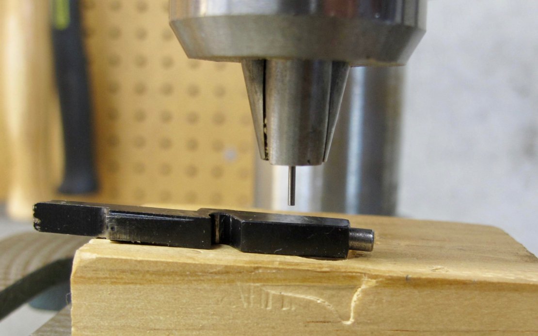

I recently attempted to 100% detail strip a 1938 Mauser 'shooter', just for the fun of it. Youtube disassembly videos give a good overview of how to do it although the ones I viewed leave off removal of some pins. I was able to get the pistol and toggle apart, except for the sear plunger and S-link. I found the pins holding those to be very tight.
After unsuccessfully trying to remove those pins using a punch and mallet, I decided to try my drill press. It worked and I wanted to share the technique.
I found a very small drill bit in my parts box that fit the pin face, and chucked it into my drill press upside down. Sorry I don't have the exact drill bit size, I just made a visual fit of the bit face to the pin. I placed a block of wood under the sear assembly. I found I had to tightly chuck the bit into the drill press or I could not budge the sear plunger pin. But, on about the third try I had things tight enough and pushed the pin out.
There is a hole in the wood block to receive the pin. This photo was taken right before I pushed the pin out.

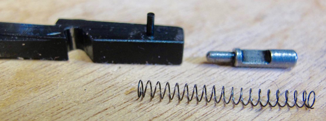

I did not push the pin all the way out, rather just enough to allow the plunger and spring to come out. The spring is small and thin, easy to lose or damage.
I cleaned out the channel with pipe cleaners and Ballistol.

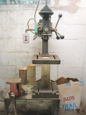

It's a very neat trick for light duty press jobs, and much easier to use than a large press when you're dealing with small parts. I have a cheap drill press ($60 from Lowe's) that I use almost exclusively as a press, and I have turned an assortment of arbors to use for different things. For example, it works great for pressing in the escutcheons in the reproduction grips I make. Just have to go careful on stubborn pins, I don't know how much pressure the table really can take and I don't want to find out either.

The table is sturdier than the drill press. The drill press is a modest Delta. All force was applied with one hand to the press arm while seated, so I'd call the force to push the pins out "significant" but not "great".
I'm talking about the adjustable table on the drill press. Mine will flex a bit if I press hard enough, so it can probably snap off the column if I press hard enough. I'm just waiting for one of those really old floor models to show up for sale, they are extremely solid and would be perfect for this purpose. They are fairly inexpensive, and you can get one for next to nothing if it doesn't work.

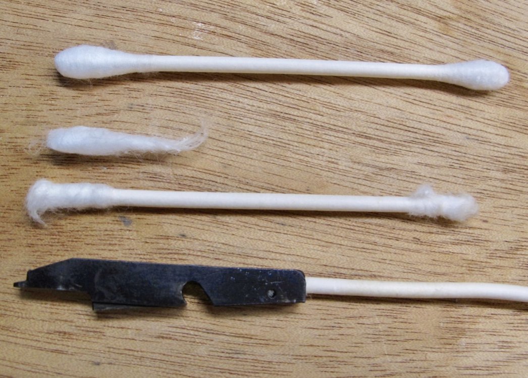

I recently cleaned the sear plunger channel on a Portuguese Army Model 1906 shooter. It was operating just fine, but I find it fun to take apart shooters. My references show DWM delivered this contract around 1909 so the pistol is approximately 108 years old. I found a lot of grime at the channel base and pipe cleaners didn't seem to be doing the job.
A modified Q-Tip helped. The photo below shows a normal Q-tip, the cotton torn off by me, the finished "tool", and the sear bar showing the tight but workable fit of the Q-Tip paper shaft into the plunger channel. Twisting helps. Channel is ready for another 108 years.
I have one of those, an old 'Buffalo Forge' table top press made sometime in the 40's, fitted with a 1/2" Jacob's chuck. I found that the table would slide down under hard pressure no matter how tight the clamp was. So I cut several 4x4's to place under the table so it couldn't slide down.
It also doubles as a press. I don't trust it to drill perfectly perpendicular to the table, but for most drilling jobs it is adequate.
