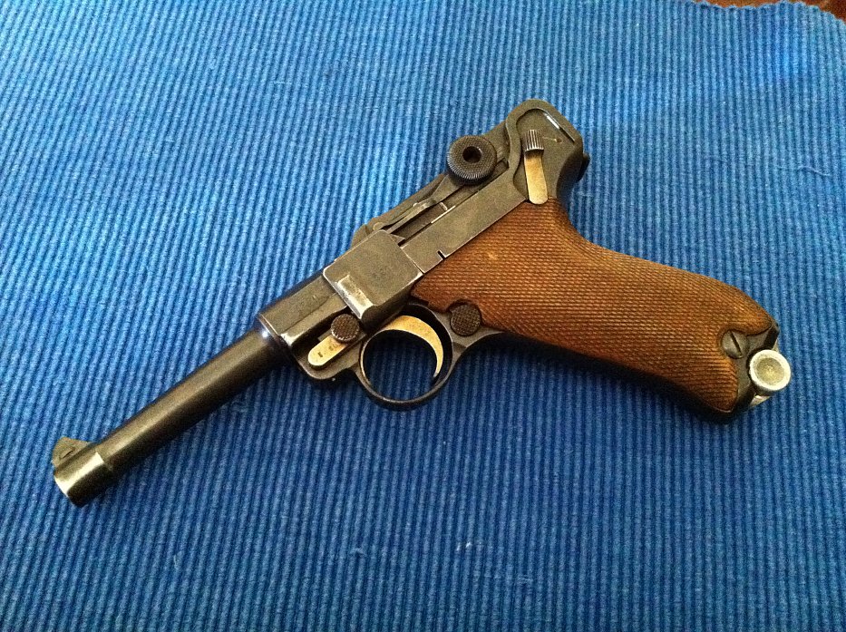

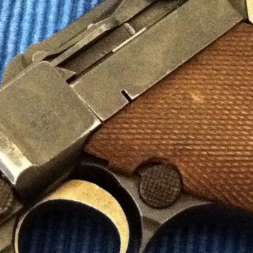

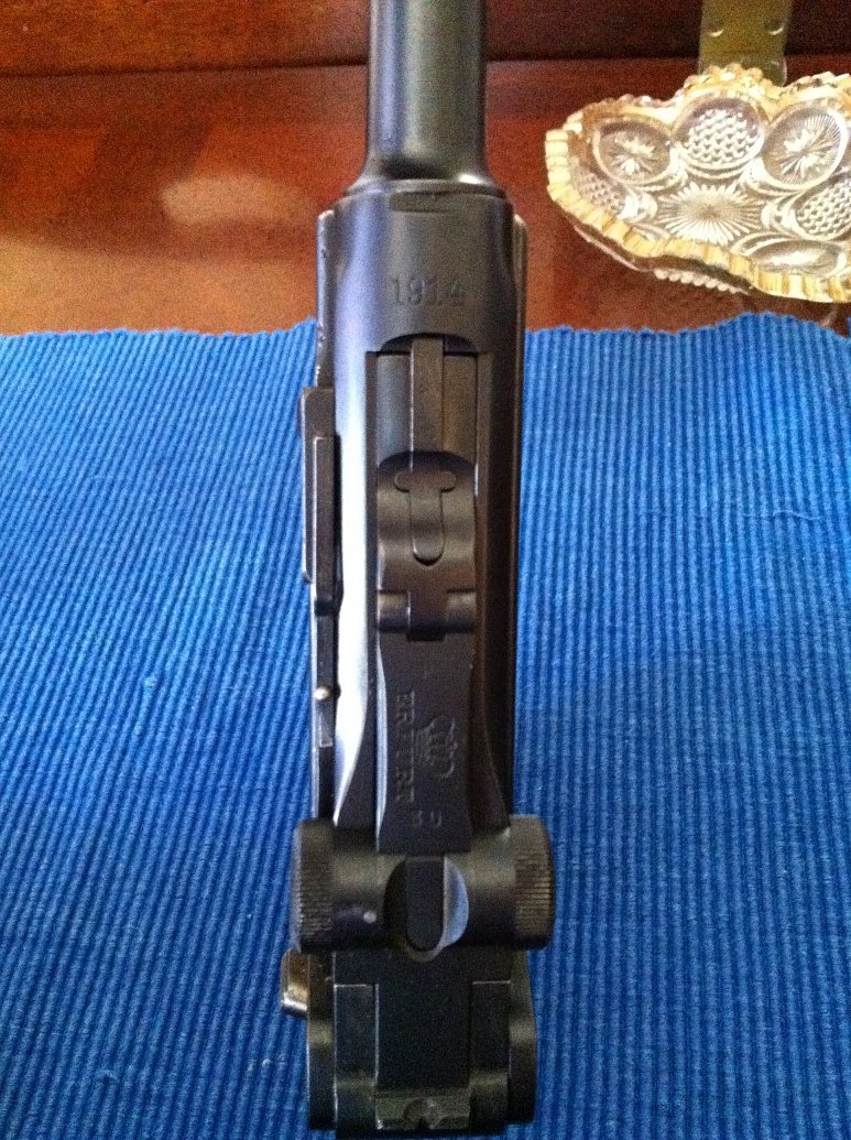

First off sorry about the poor quality pictures, I took them about 4 years ago with cellphone.
I was reviewing some photos I took of a matching numbers 1914 Erfurt SN: 1880 brought back by a family member of mine after WWII and I noticed a strange cut above the left grip panel. This gun was hidden in a bedroom by the man who captured it. He passed away sometime the 80's and the gun was lost. His wife was selling the hose in 2012 and the gun was found. When I examined the weapon I was extremely shocked to find it had an almost full mag with rounds that were manufactured in Germany in 1943.
Does anyone know what the cut above the grip panel is for? I have admittedly very little knowledge in the subject but I have never seen anything like this on a P08. Do you think the slot could be original? I am sure the gun was never reworked or refinished after the war but it may have been sometime between WWI and WWII. Again it is an all matching numbers gun.

It is a police rework that had the mag safety removed. search here for mag safety and you will get a full description. The pistol was at one point, a 1914 Erfurt artillery. It was re barreled for police use in the early 30's most likely. A police luger expert will probably chime in here shortly. John

Thanks for the info! Unfortunately I did not get any clear photos of the barrel stamps. There goes the matching numbers theory...

When in the war zone in WW-II, ANY firearm in German hands would have been confiscated.
While part of the history of this 1914 dated Erfurt, I don't think I'd value it any less for having the magazine safety cut. This is a rather rare date for Erfurt. If it's all matching and in original finish, it would be very collectible. It still has the sear safety installed. The magazine safeties were removed from many of these police conversions.
Take fresh pictures showing external markings, including barrel markings, and the internal parts. Get the details from the magazine, which is not WW-I vintage (and probably interwar or WW-II vintage).
You have a great family heirloom. Resist the temptation to shoot it. Many of these century old pistols have broken a numbered part.

The rework term is something I am usually a bit leery of using - although true, it sounds like a gun was torn down and refinished
As said above, an army luger made in 1914 by the royal arsenal Erfurt. At some point it was transferred to police and received a sear and mag safety in the early 1930's. Without any unit markings, you can only guess where it has been.
See the FAQ in the new collectors area for pictures of sear and mag safeties.

Ed, I think it is safe to say this one was torn down to some extent. At least the barrel, and rear toggle have been replaced. Miles, the barrel may very well be matching numbers, just not from the factory at Erfurt. (numbered by who ever did berrel change for the police re-fit) John

and a magazine safety requires a big hole in the frame
