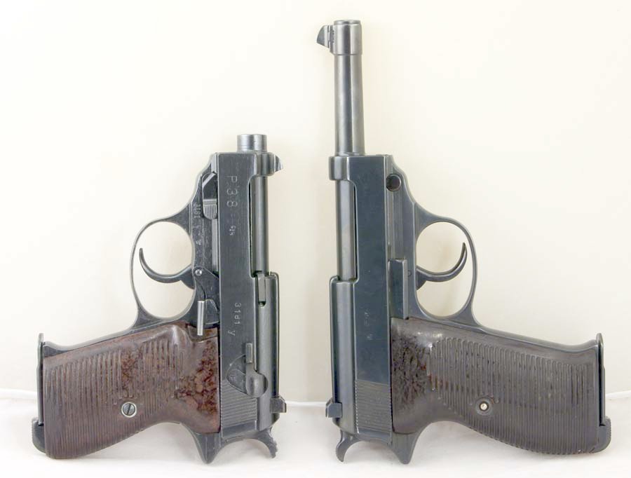

I have owned them too... great "carry" guns since they are so light weight, especially if modified and hammer bobbed to be a "shorty" like the attached photo..., but the original frame finish lasts about as long as a chocolate candy bar in my hands...Without sarcasm, These guns will likely not become very rare during this generation, so--

This image is actually photoshopped to look like a gun I made for myself back in the 1970's from a mismatched P.38 I built from parts.
In addition to bobbing the hammer and shortening the barrel, I also flattened the contour of the safety and checkered the remaining lever. It was a great carry gun, and reliable as heck.
With a P1 aluminum frame it would be even easier to carry...
I think I would find the P5 to be slightly bulkier than my "shorty."

The shortened design really requires a bobbed hammer for both looks and practicality as a concealed/carry pistol.
Unread 08-25-2016, 02:34 PM   #7
If you mean like the pic John posted, that would relegate it to double-action only [first shot]...
Unread 08-25-2016, 03:17 PM   #8
Not really Rich, I had the top of the hammer grooved and the back slightly rounded so my gun was capable of being manually shot as a single action auto. A slight take-up of the trigger made this function even easier, but in reality, for a short carry gun like this, Double-action only is perfectly fine, since most encounters would likely be at distances similar to being inside a room. Iron sights are not an issue at those distances.

Exactly! It is possible to bob the hammer for better concealment and less garment damage and still be able to hand **** the pistol for single action work.
