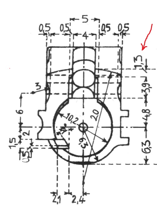

I have discovered some damage to the breechblock near the extractor after firing my Luger. The damage is seen at the front of the breechblock on either side of the extractor. There are travel limiting lips built into the breechblock that will allow the extractor to only raise so far. The metal has apparently been hammered by the extractor and raised upward. I'm a little surprised that the extractor would be raised with such force during cycling...
A little history: I have had this pistol a long time and it had been reblued at least once before I got it. I subsequently polished, then rust blued the entire bolt assembly after replacing the rear toggle, which had cracked.
Suspecting too much material had been removed in refinishing, I made some measurements and compared them to those on the Luger Blueprints DVD I purchased years ago. The drawing shows the measurement of these limit lips to be 1.3 mm (.051") top to bottom. On my Luger they measure about .035". I cannot read German well enough to determine the tolerance on this spec.

As you can see in this blueprint extract (Image 1), The area you describe is dimensioned as 1.3mm. it is the only dimension I see on this blueprint that is this value.
From the blueprint table the tolerance for this dimension is 0.1mm, (which was corrected from the previous tolerance of 0.05mm (image 2) which has been crossed out.)
0.1 millimeters is 0.003937 inches.
0.05mm is 0.0019685 inches.
I think that you have correctly diagnosed your problem as the extractor stops are excessively worn by constant hammering of the firing cycle (after being reduced in size by material removal during refinishing).
this gun is obviously a shooter class gun, so I wouldn't waste any time trying to find a DWM breechblock with a matching serial number... just get a replacement block and fit it to the gun and have fun shooting it.
If retaining matching numbers is important to you, then have the area of the original breechblock micro-welded and then remachined to the blueprint. But this will Not be cost effective in my opinion.
