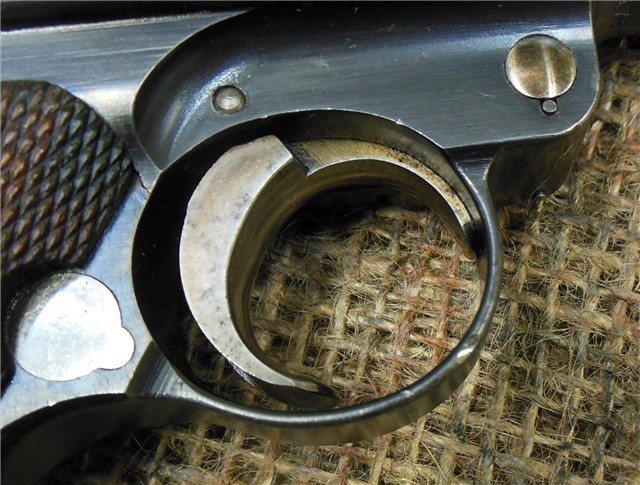

Is anyone else concerned about that line radiating forward from the right grip upper point, or is it just my imagination?
Looks like a crack to me.

Is this the picture you are saying looks like a crack?
The downward sloping jagged line from the grip?

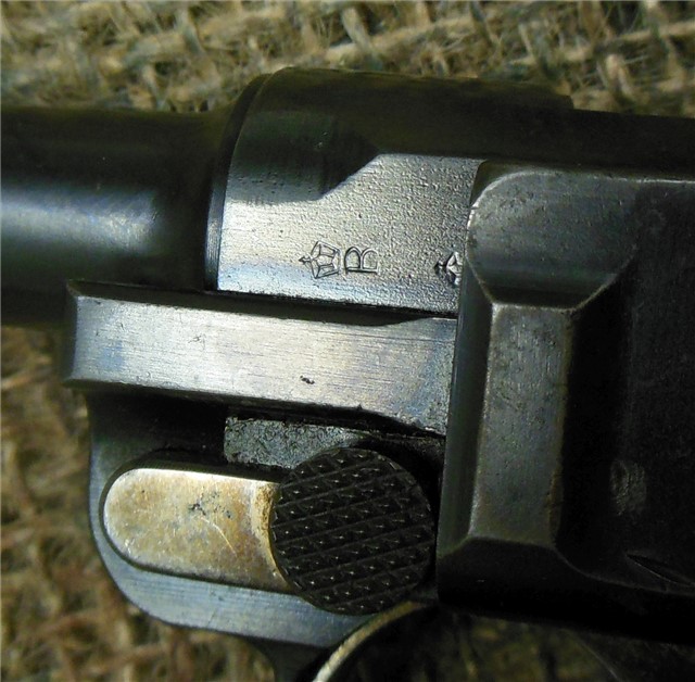

One of the things that concerned me was this stamp.
I thought it looked way to shallow.
Is this normal for an 'honest' DWM luger from 1906?
I would have expected the stamp to be deeper since they were in a commercial market and under little pressure to turn them out fast -as in WWI.
I think it is just the corner created at the intersection of the flat surface below with the curved surface above. My Lugers have it.
I think it is just a piece of thread or lint that snagged on the grip and is soaked with gun oil... seems an unlikely place for a frame crack. No firing stress in that area.
Me, too.

Maybe John and Don M. are correct, and it is a "ledge"; it does "look" like a crack- a quick look in person would settle that.
Good question to ask the seller, just to establish a reference!

Me, too.
It also looks like a crack to me.
But also agree that it's in an odd place.

I agree with Ron Wood, it is a correct and original finish Luger. Only a hands on inspection will be the last word however. It looks like a crack but is 99.9% not a crack. It is a machining ledge that all of that era Lugers have. If you have a reference collection you can check yours and see they all have that ledge. The proof mark is also ok and fine. That proof was struck before the rust blue and that one is within the range of normal appearance and depth. The barrel serial and proofs were struck after the blue was on and those too have the right look and halos. Nice original gun. Good luck!
