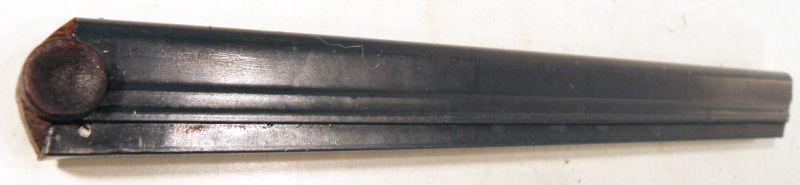

Does any collector in the LugerForum recognize this illustrated magazine in the photographs which was recently unearthed in Germany.
It has not been confirmed if it is a 16 or 20 round magazine. But it has what we believe to be the Haenel 122 number marked a the bottom of the tube. Is it possible that this could have been a prototype or what? The Wood bottom is angled and is not known if it is original to the mag or not.

This is an extruded type 122 Haenel 8 round magazine (similar to the FXO type) with a homemade wooden bottom. The original bottom was either bakelite or aluminum. IMHO worth about half what a good condition magazine of this type is worth because it has been modified and it is rusty.

On Jan Stills forum
16 round magazine that George Fortier owned or used to
A blued one another member knows of or owns
Pete states
Old photo on page 391 of Kenyon's book, LAR, show such a magazine and a special holster with long magazine pouch in the Swiss style. That magazine has some "spline" about mid-way down the metal tube. Noted in Carl Wilson's collection at time of book issuance.
Fred Datig's old Swiss Monograph's booklet has the same (or similar) extended magazine with Swiss looking leather, etc. Called Swiss experimentals.
and I have an extended P38 mag
Unread 04-24-2016, 11:13 AM   #15
Compared to the pics in TBLAP of the Swiss 16rd extended magazines, the CMR mag is nowhere near 16 (or 20) round capacity.
