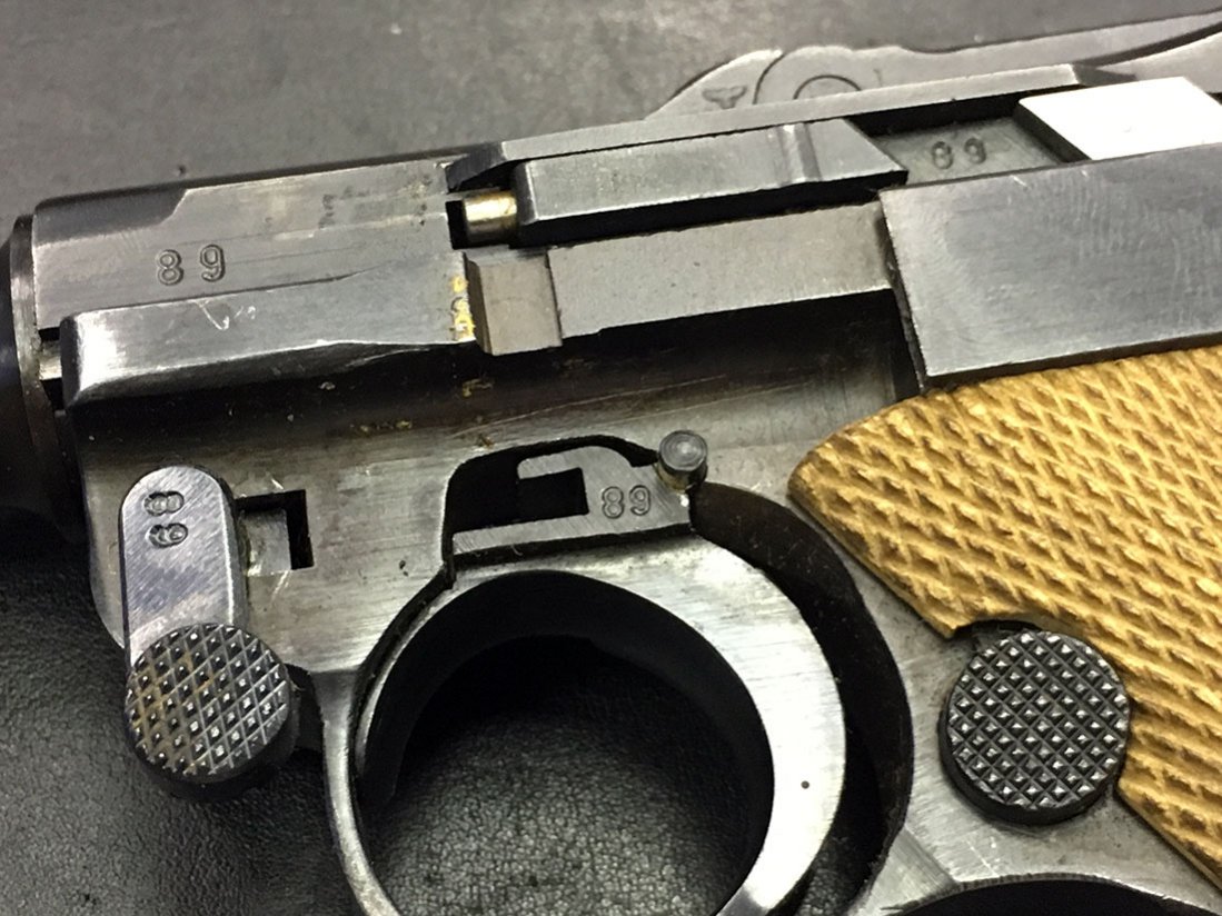

My real problem is the serial number? where is it? where all the other 42 byf lugers I've been able to find on the net have the serial under the barrel, mine just has a 89 and some letter.

Your serial number is "89F" as shown on the front of the frame. That means that it was #89 in the F block, which followed 9999 in the "E" block. It shows very little use or wear, and was probably one of the last made before switching to the P-38, although the books guys could confirm that. There was an unnumbered black plastic mag. issued with these, so we need photos to confirm if they are correct or aftermarket.

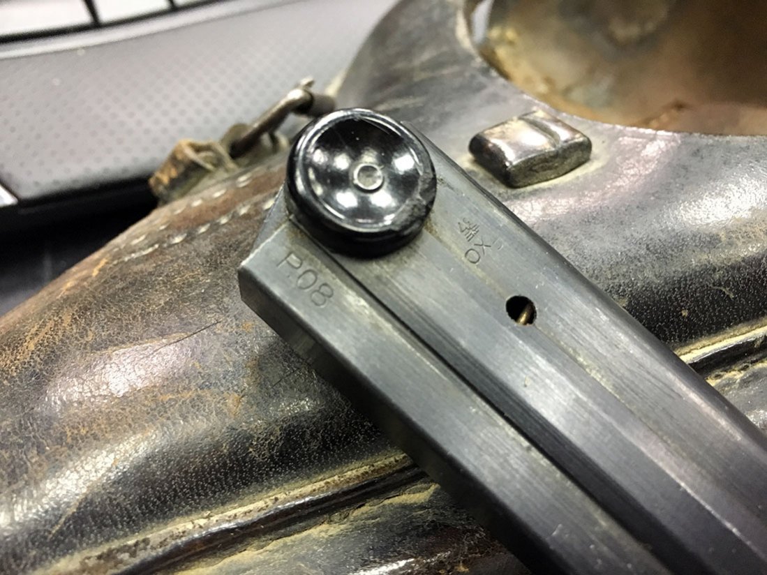

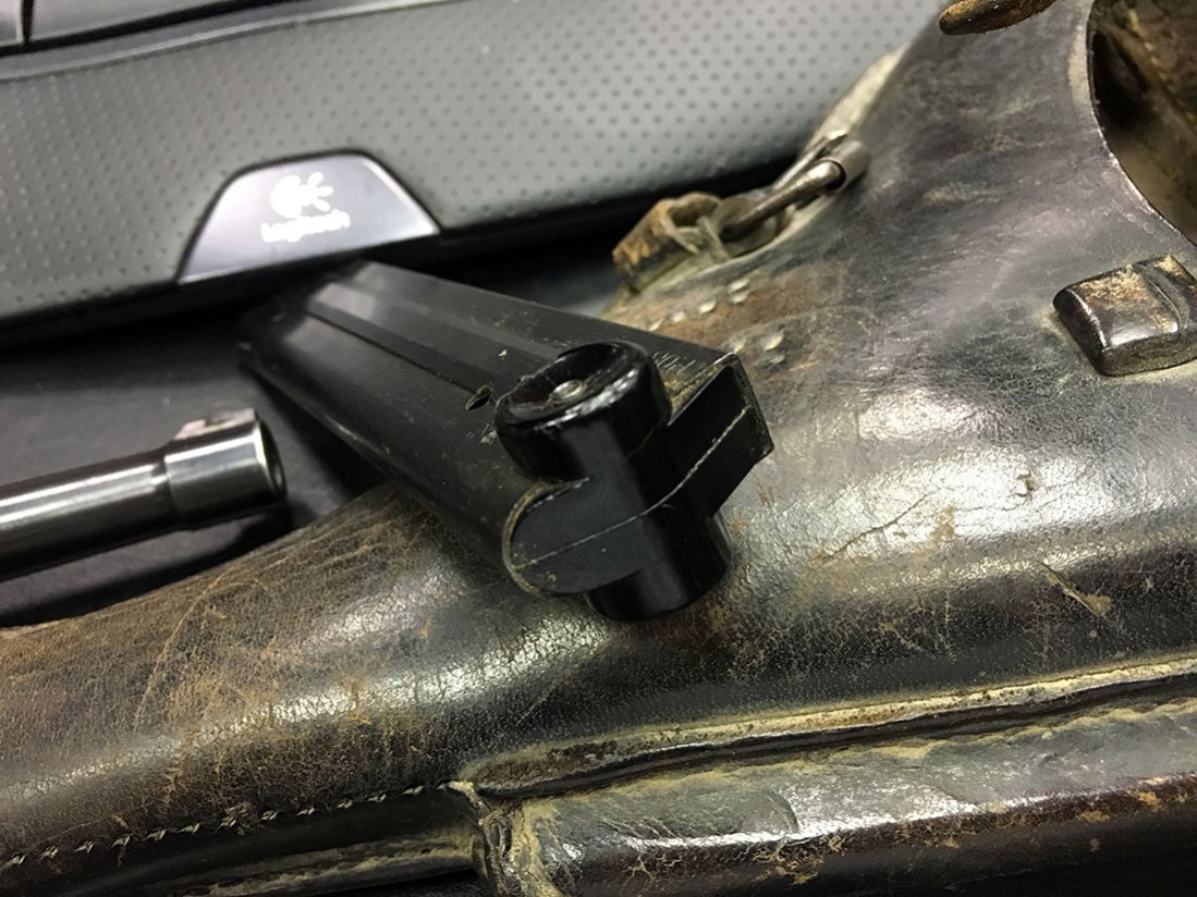

Default Holster / Mags

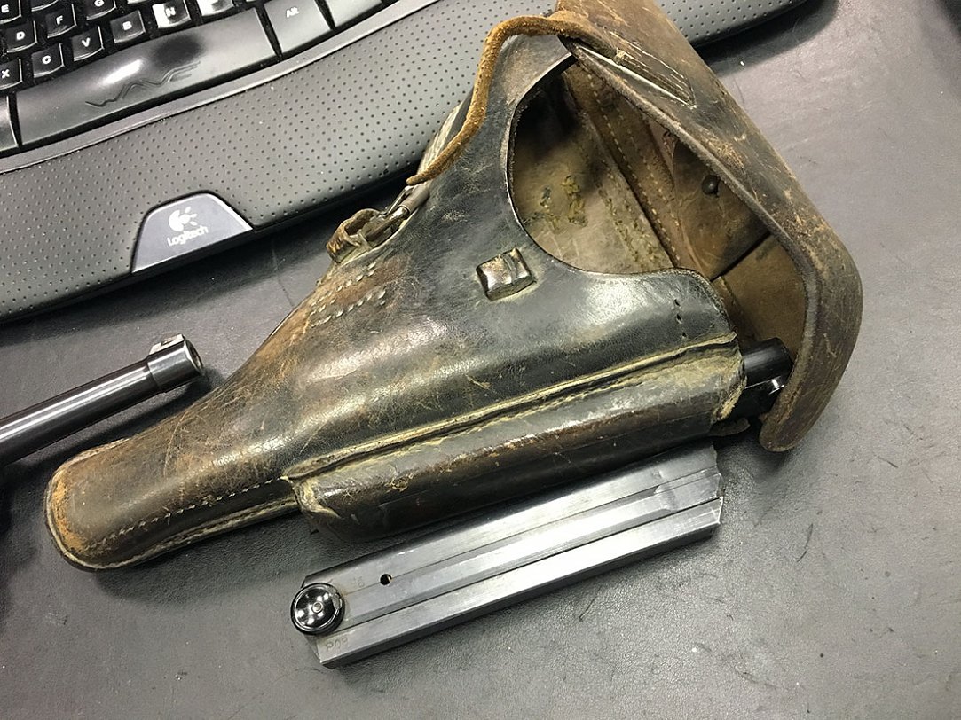

Here is a couple pics of the two mags and the holster that I have for the gun

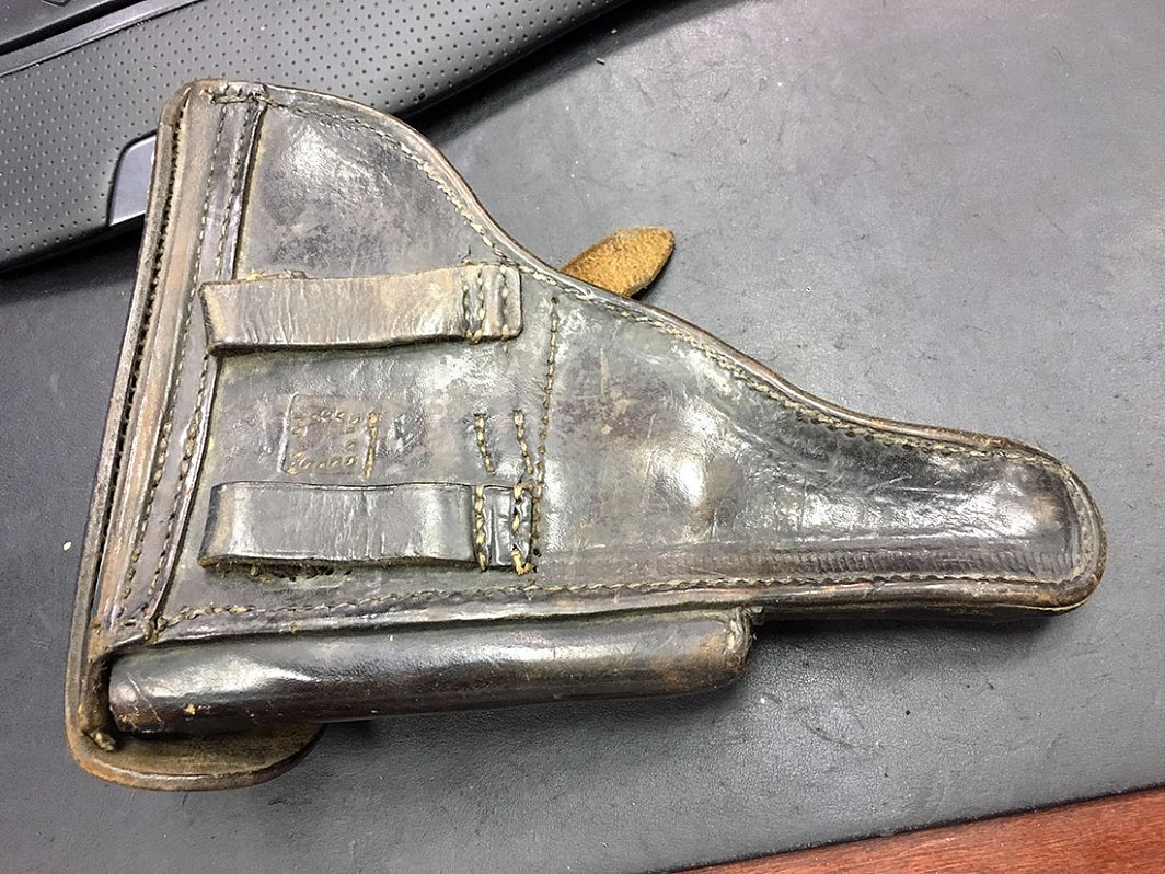

Default Couple more holster shots
Here's a couple more pics of the holster

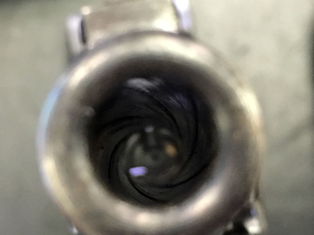

Default Barrel Looks Good
This gun appears to have had very little use as the lands / grooves appear to have no issues at all. Very sharp all around.

How about photos of the stampings or ink on the holster. It is an older conversion, possibly from Police to Military?
And those magazines are correct for that gun.

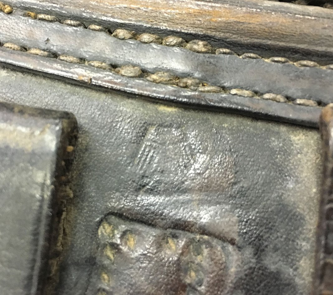

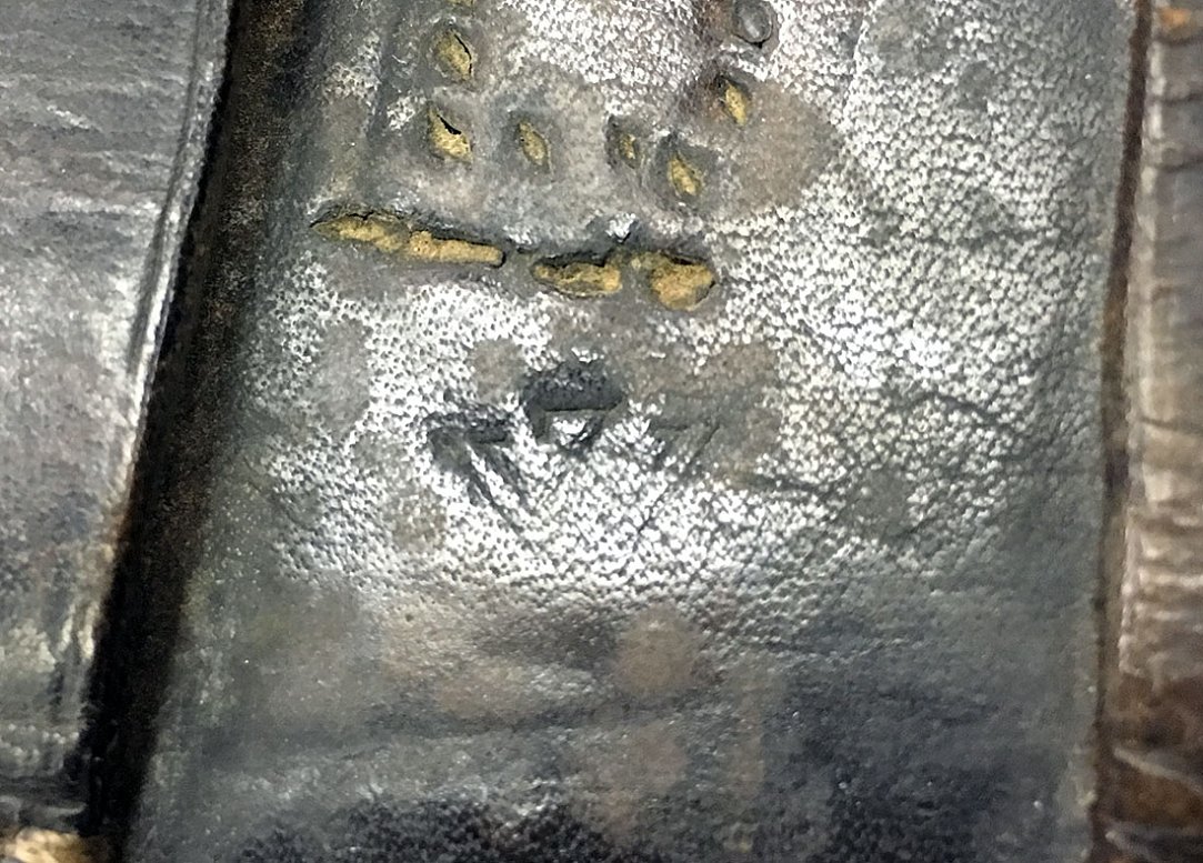

Default Holster Stamp / Marks
Only two stamps I could find on the holster were both on the back inbetween the belt loops. I did my best to illustrate them but they are very hard to see.

Super example of a 1942 byf. The magazines are correct. The holster is a cut-down and modified WWI artillery holster. The stampings on the back of the holster which appear to incorporate a spread wing eagle are bogus.

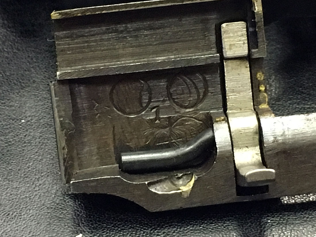

As already mentioned, Lugers were numbered from 1 to 10,000 in each lettered block, and you have "89f" made very early in the F block in 1942. The full serial number appears on the front of the frame above the trigger guard. "89" over the letter "f".
It was made toward the end of military Luger production by Mauser in Oberndorf. "byf" was their concealment code, and the E/135 inspector worked there.
Your milled steel magazines with plastic bases are original and considered matching for this gun, and are properly un-numbered. They were made by Haenel Schmeisser and have an E/37 acceptance stamp and "fxo" maker's concealment code.

As noted on the other forum, the holster is a conversion of a WWI "Artillery" holster to the military style. It is shortened, has had the cleaning rod pouch removed, and a mag pouch added, along with the necessary closure pieces, and belt loops. The droop eagle may be spurious.

As Mark mentioned in his post, these magazines are correct for P.08s produced at this time.
But, although they are of Haenel Schmeisser design, they were not produced by them.
In fact, this particular variation was produced in Zella Mehlis by the firm, Manteuffel and Co. This particular sub-contractor was staffed with forced labor drawn from the nearby "Froelicher Man" i.e. "Happy Man" Camp.

I have a 1942 "byf" like yours (S/N 2011 "l"suffix)
Mine has the same 3 acceptance proofs on the right frame and it also has "42" on the chamber.

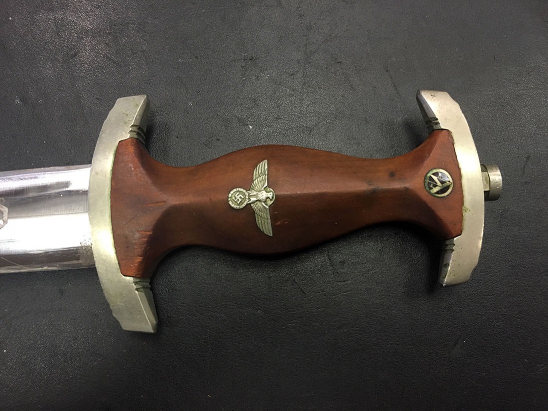

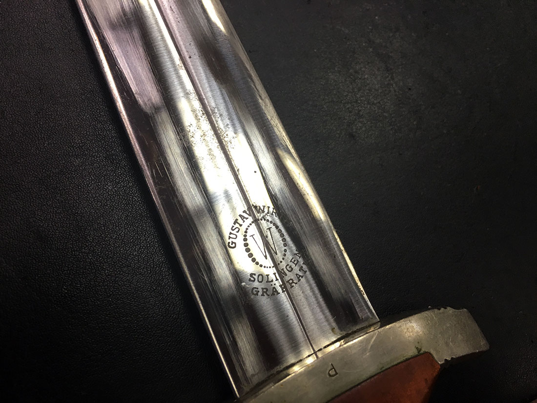

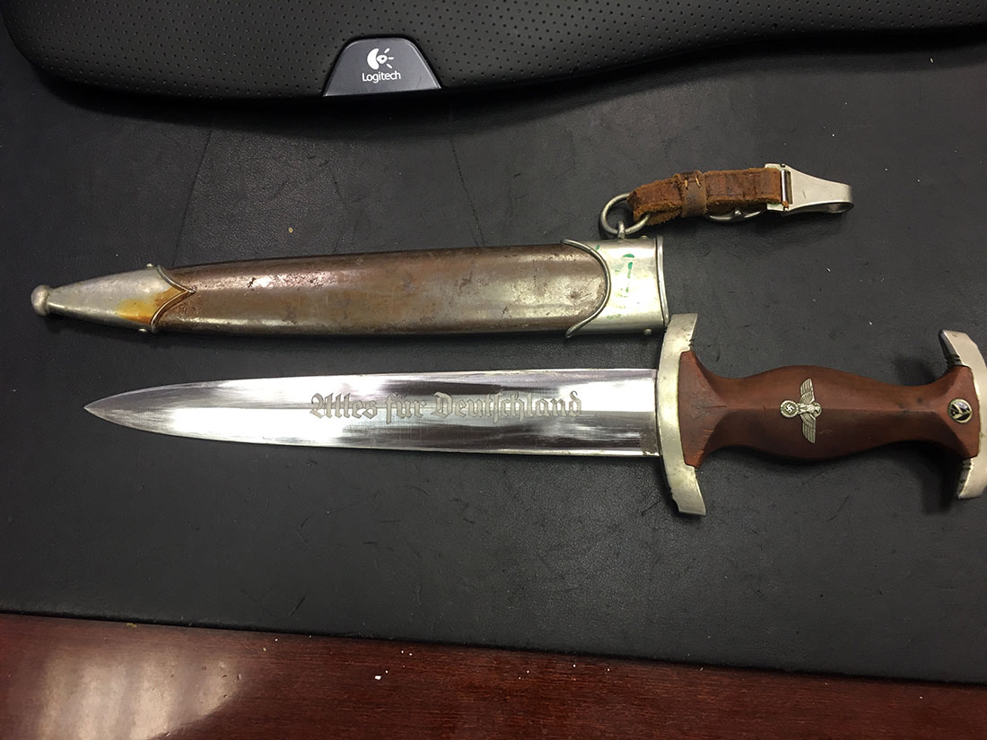

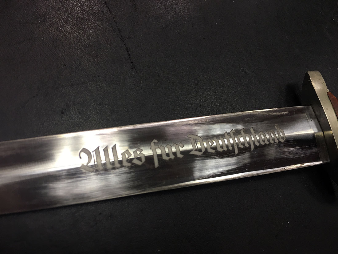

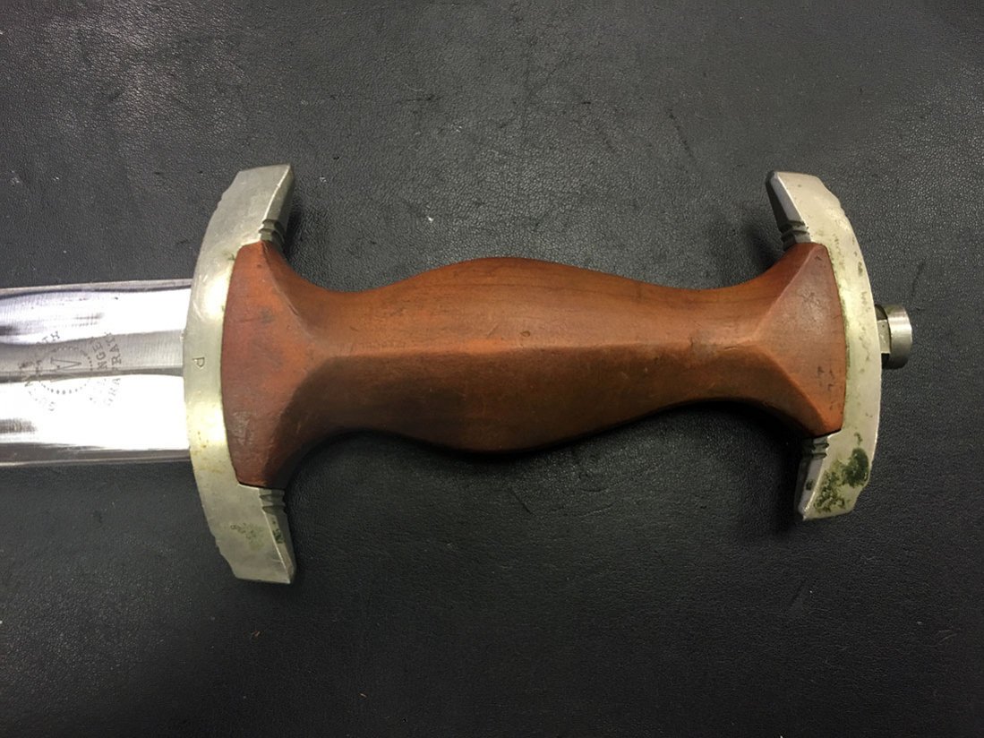

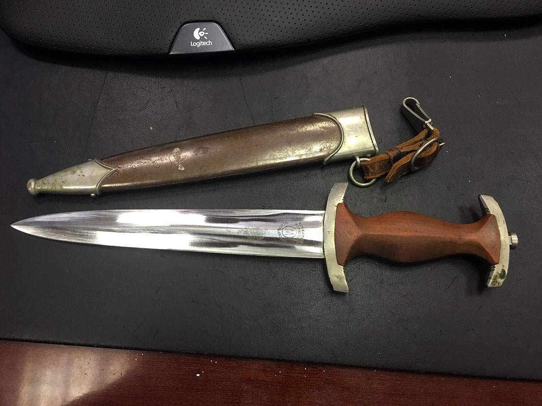

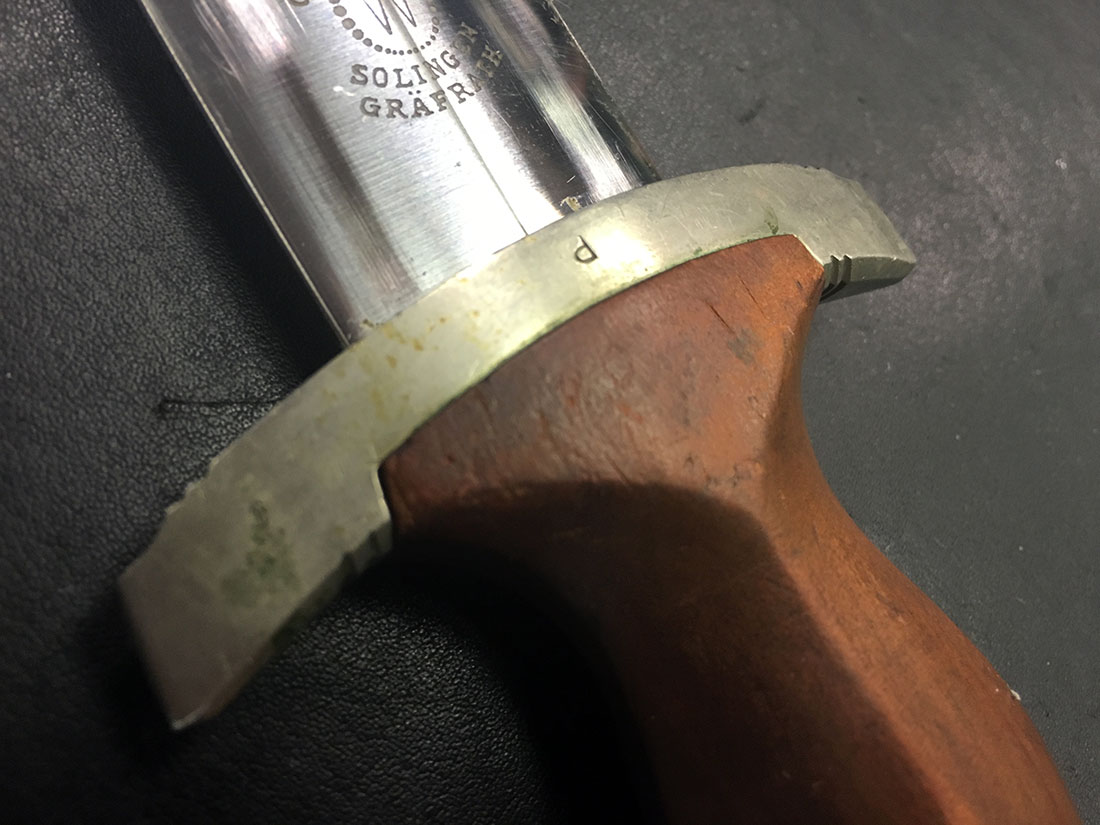

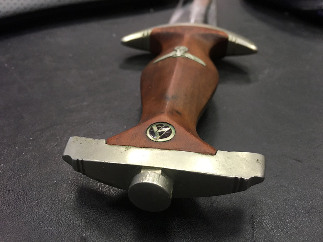

I know this really isn't the right place to show this off but the same guy who sold me the Luger gave me this as well. I did a quick bit of research and it's a very scarce maker, Gustav Wirth and this large Dagger is in great shape considering the age. It's marked on the blade marked on blade "Viles fur Deutschland" . Very cool piece of history.
