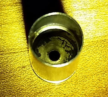

They are easy to spot when reloading. Instead of the normal taper of the case wall thickness, , they have a very visible step 3/8" from the case mouth. I had one separate on me while shooting - only the case head up to the step ejected. The 3/8" from the mouth back stayed in the chamber. I was shooting a very light load in my Sig, so it was not a pressure issue. Fortunately the part still in the chamber was easy to remove (fell out when I stripped the pistol actually). But I didn't know it was going to be easy, so I was done with that gun for the day.
I did some Internet research, and found that I am not the only one that this has happened to. Apparently these cases are made in Turkey, and are also sometimes marked "AMMOLOAD". Same design, same problem.
One brand that uses these cases is Freedom Munitions.
I grabbed this photo from another forum, but it shows the inside of the case.
And, yes, I do mean IMT, not IMI.

Not sure what you're looking for. The loaded round doesn't look any different than any other 9mm ammo from the outside. The step is on the inside, as the photo I posted shows.
When picking up range brass, just look inside. Or do it while you're handloading. It's very easy to see that step on the inside. Can't miss it.
Don't buy any ammo headstamped IMT or AMMOLOAD if you intend to use the brass again. There may be other headstamps/brands from the same case manufacturer as well that I didn't find in my research. But one look inside a fired case, and you'll know the stuff right away.

Originally Posted by NH Photo Shooter View Post
The step is on the inside, as the photo I posted shows...
So that's a case that didn't separate???
Correct. By the looks of it, I'd say it has never been reloaded after it initial commercial load was fired. It's pretty clean on the inside walls.

OK, from the top. Some company, apparently in Turkey, makes this brass for other companies to load into ammunition. They make this brass in an unconventional way, with a step on the inside instead of a taper to the case wall thickness (see photo). The companies that buy the brass load it with initial first loadings, like Remington, Winchester, Fiocchi, or PMC would do if they didn't make their own brass. There does not appear to be a problem with firing this commercial ammunition. The Turkish company will headstamp this virgin brass to order, IMT or AMMOLOAD that I know of.
The problem arises when people like me handload this particular brass. It is apparently not designed to be used more than once (reloaded). In that respect it's like Blazer aluminum cases: OK to shoot, not designed to be reloaded.
I've never seen a new box of this ammo as far as I know. I picked up some once fired cases of it at a local commercial range, along with a lot of other normal once fired brass. I noticed the difference right away as I was running it through the Dillon, but did not realize there would be a problem until there was one. Then I looked it up on the Internet and discovered that others had had the same issue.

In the FWIW dept., I just happened to be going to the range today, so I grabbed a box of Freedom Munitions 9mm "new" which was indeed head-stamped "Ammoload". Upon firing, I was able to confirm the presence of the step inside the case.

Note: they are a danger to reload because the case capacity is different.
You COULD reload them, but they would need a separate load work-up andwould need to be sorted out of normal 9x19 cases. Considering the cost of 9x19 cases, they SHOULD be thrown away. The risks are too great for a negligible gain.
The real thing to emphasize is "Inspect your cases, every time, inside and out."
