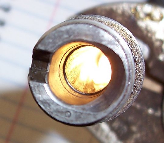

I have a 1920 commercial with sear safety, likely made late 20's with likely modifications later. I've been shooting it quite a bit - fun pistol indeed.
I was having way too many failures to feed, and have been working on that. The mags were hanging too low. The mag release showed no sign of excess wear, so I am assuming it was mismatched to the gun. Fixed that, and it helped. Got a Mec-Gar magazine, and that also helped.
The other thing I noticed was that a fair number of rounds were feeding almost all the way, but the bolt stopped about a quarter of an inch from battery. Upon recent close examination of the chamber, I noticed an extra little step about that far back from the step that the case headspaces on. Not large, bit quite visible, and easy to feel with a sharp probe. Testing by manually inserting rounds into the chamber of the stripped gun, with the rounds angled as they would be in feeding from the mag, I could easily see this causing the problem I was having. I polished most of it out with 220 grit on a 3/8" dowel in a drill, going very slowly. It's not quite gone, but I definitely took the edge off. This also had the effect of polishing the chamber rather nicely, and possibly enlarging it by a very small amount. It's feeding much more reliably now.
I have new springs on order from Wolff just in case a weak mainspring was contributing to the issue, but, really, I'm not dissatisfied with the reliability at this point: one or two minor failures (had to tap the toggle down) in over a hundred round test with mostly handloads.
So what I wonder is, has anyone ever noticed this before? Bad chamber reaming, or was that little step there for some reason? I'm assuming careless machining, but wonder if anyone has had any similar experience.
Thanks in advance for any thoughts.

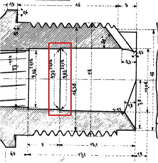

The chamber step is a feature of the original design of the 9mm Parabellum, going back to 1903. It was included in 9mm P08s until 1940-41 when Mauser eliminated it, making the chamber in one machining step rather than two. The step was intended to act as a gas seal when the cartridge case expanded upon firing, keeping the greater part of the chamber free from powder fouling. Mauser eliminated the step primarily for two reasons, the introduction of steel cased ammunition and it made machining easier.

I am afraid that that the stepped chamber is part of the Parabellum's design.
It's a desirable feature involved in helping achieve a more effective gas seal for the 9mm straight walled cartridge.
It was expensive to manufacture, and later Lugers sometimes eliminated this feature.
Hard to say what the result of your modifications will be...

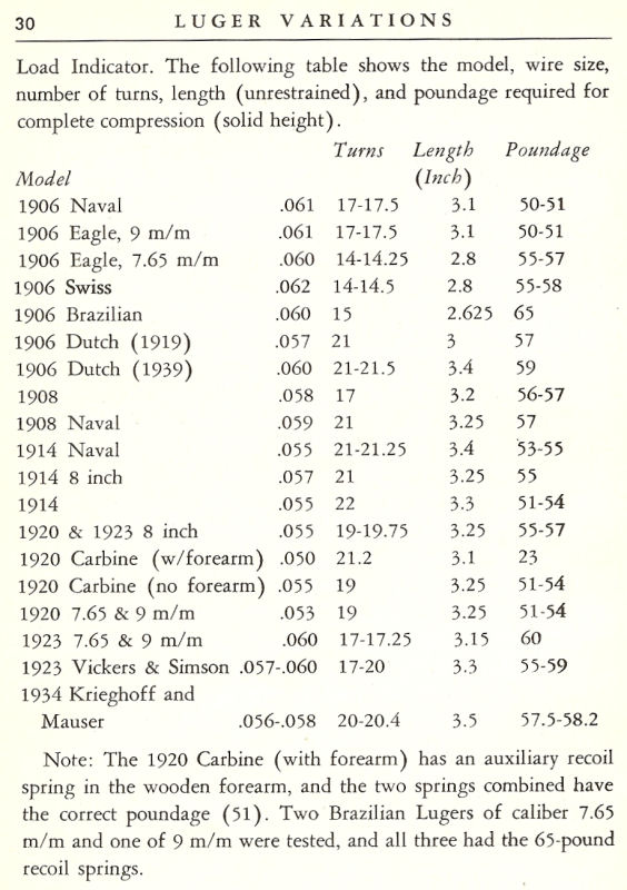

"I ordered the standard 36 pound spring and a 38 pound extra power one. I would hesitate to use the 38 pounder out of respect for the age of the gun."
I believe you have it backwards, a stronger spring will save the old pistol from "battering" better than the weak one. A lighter spring would only be correct with lower power loads, JMHO.
I'd go for the 40 lb!
But just an observation- when I ordered a set of springs from wolf, 36-38-40,
I fully expected them to be different numbers of coils and/or different wire guage and or different lengths. When they arrived, they were all the same wire guage, two were exactly the same length, and one was a little longer, but all had approx. 20 coils. The 36 and 40 were the same and the 38 longer. I have no way to measure the tension, but it is on my list to make something!
It would be interesting to know what you get.
You may have seen the chart attached; it seems the Germans could not decide which spring to use either!
(Obviously they used a different method to determine the "poundage".)
Yes, I did see your chart, and thank you for posting it, and posting it again here. Very interesting.
I'm thinking now what I'll do first is try the different springs to see if I can feel any difference from what's in it now when cycling the action by hand. If the 36 feels any different at all, I'll try that first at the range, since I am using relatively light loads. If that doesn't work, I'll see if the 38 does any better. It's a process.
