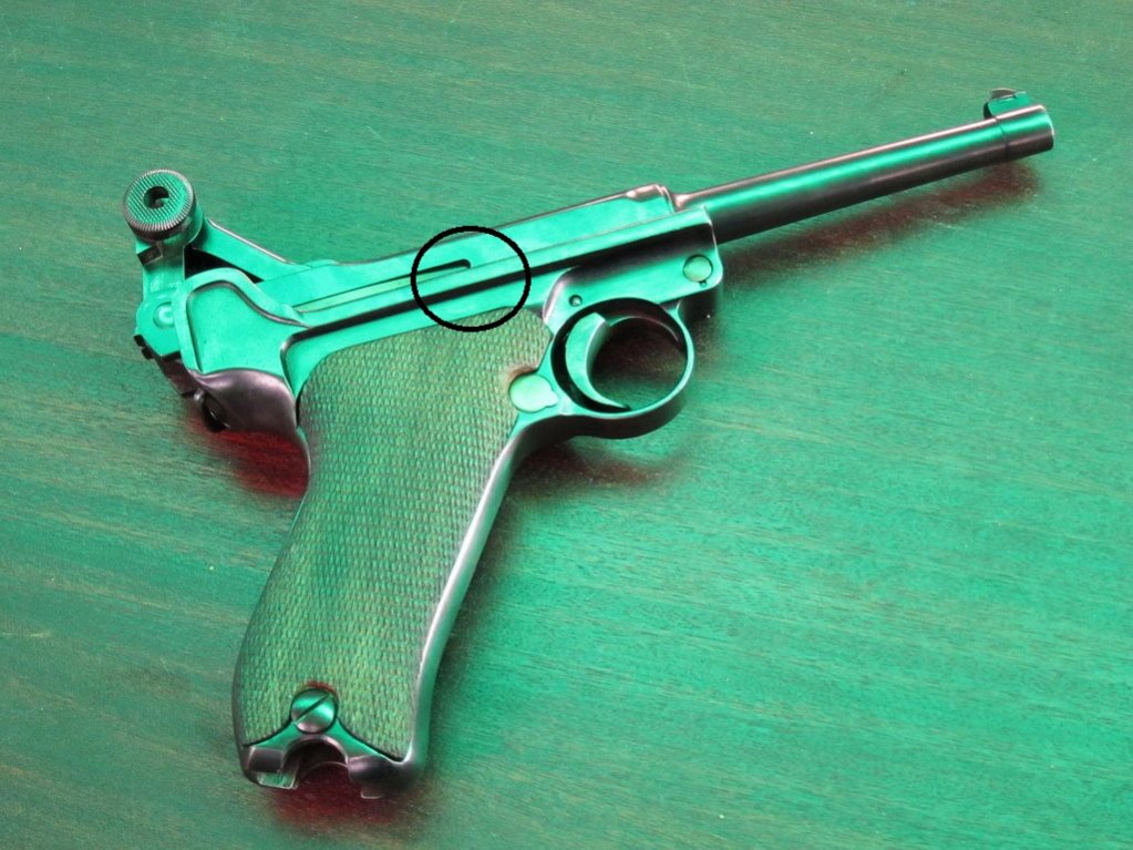

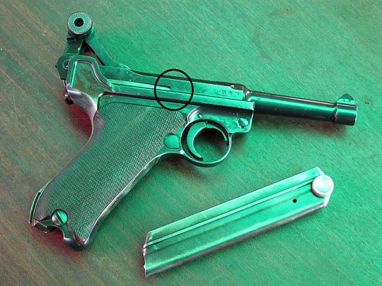

Lock the toggle back on an empty magazine. Look at the right inner side at the front of the breechblock and you should see the ejector (circled in red) protruding through the side rail. Check that it moves freely and has spring tension.

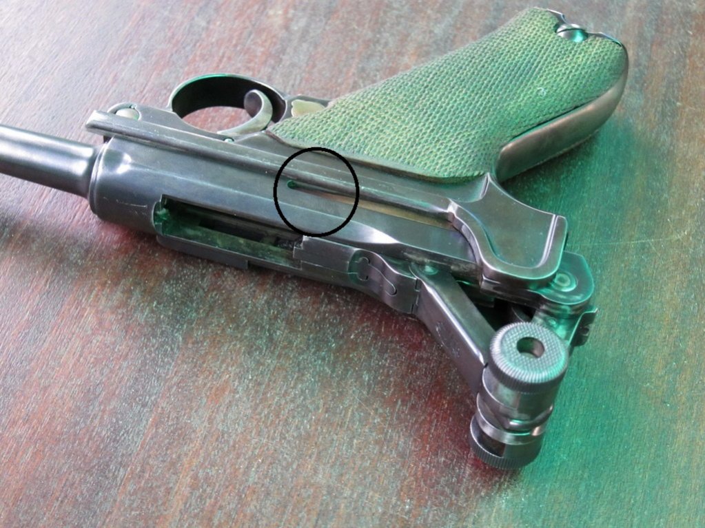

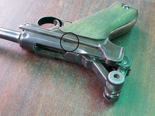

Pics

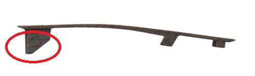

Here's a pic of the parts on a P-08 -
From your pics, your ejector seems intact. As for the extractor, it does get full of crud.

Quote: "Full magazine loaded, pulled the toggle back, bullet comes out with the extractor, but then just sits there.
it should eject it correct????
Thanks terry"
Terry,
Yes bullet should eject with toggle pulled back, even when pulled back slowly. Your photos show that the ejector is intact, but it doesn't seem to protrude in toward the breech face very much.
It is possible that there is crud between the ejector and receiver that is preventing its full travel. Check for travel by slowly pulling the toggle back until you see the extractor is even with the breech face. It should be all the way into the cutout in the breech face. If not, remove and clean.

Originally Posted by 3Horses View Post
Pics
That ejector doesn't seem very healthy to me. With the open breechblock, the front part of the ejector should get well into the frame. In your third picture that is not very evident. Could be the angle of the picture though.

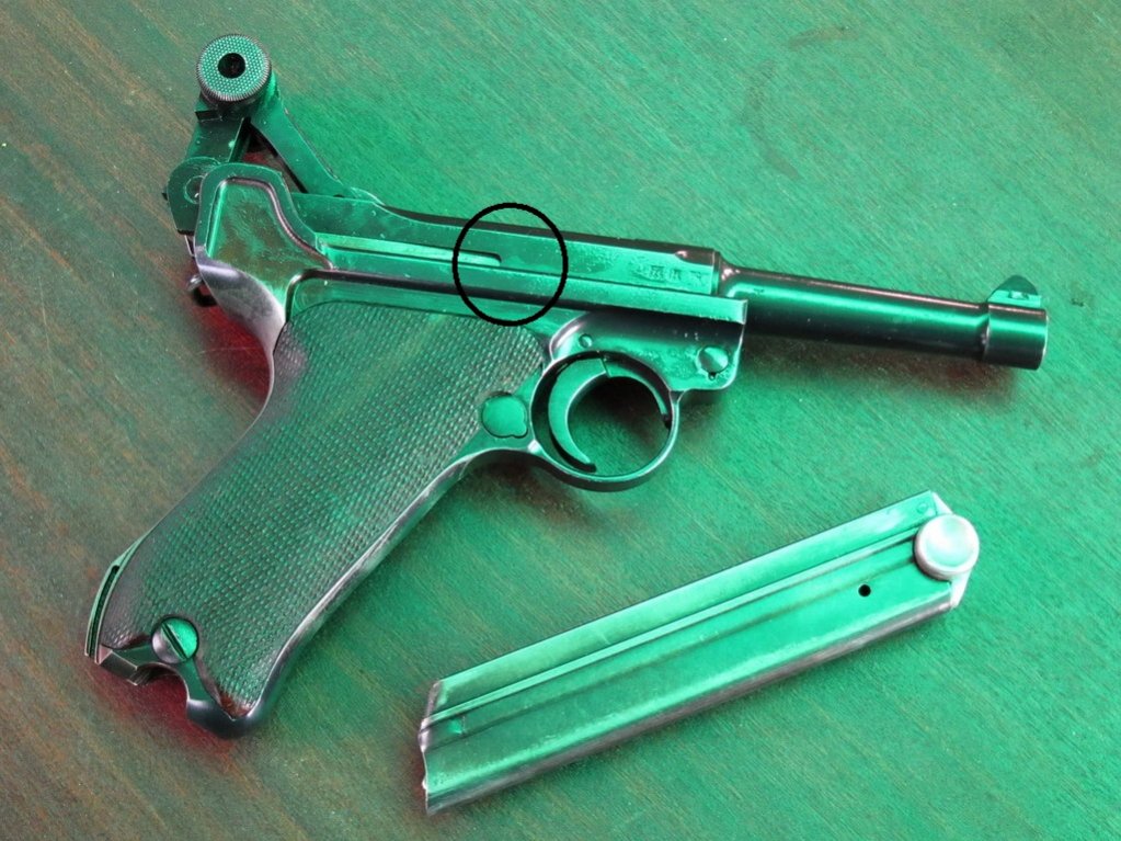

This is what I mean.
