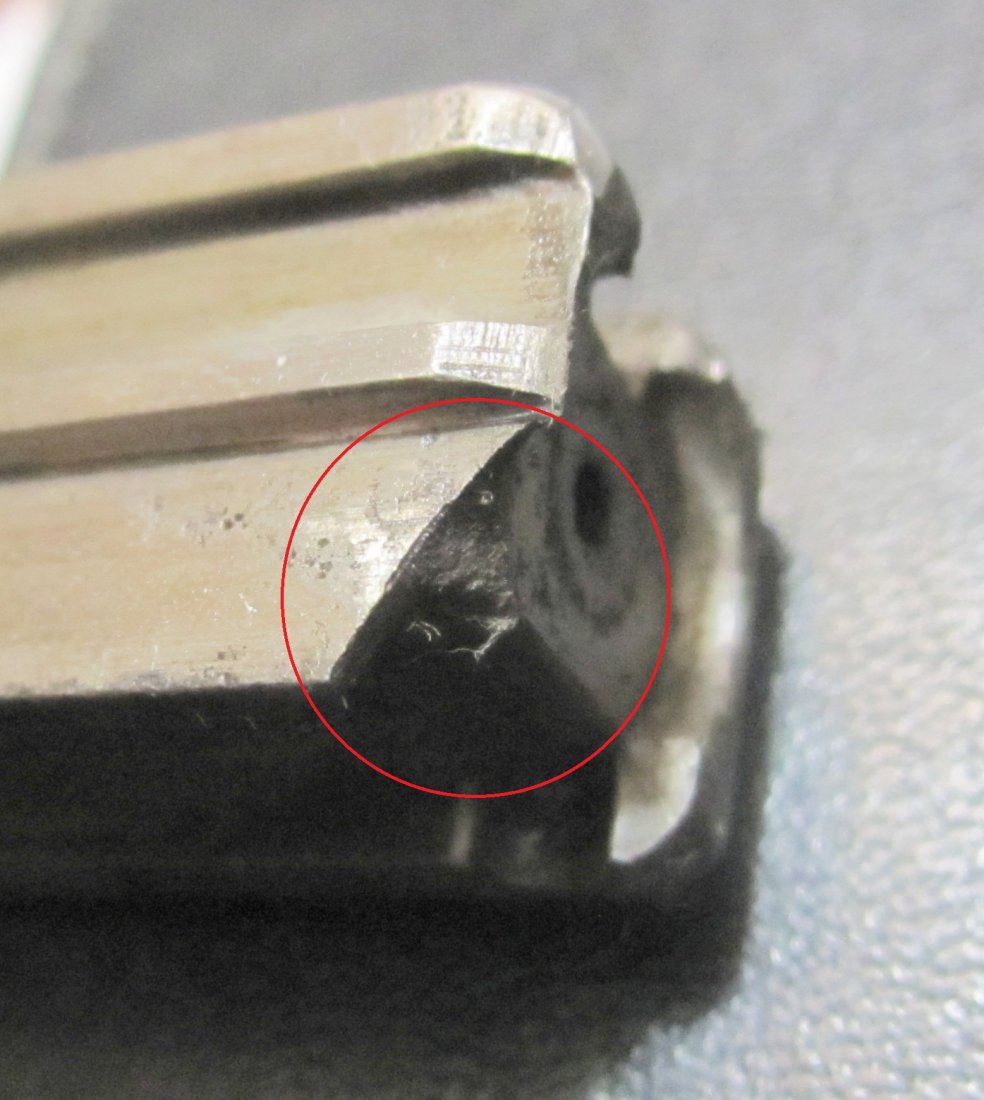

The bolt on a C96 is broken. Not broken by me, it came to me in this state. Looks it has been broken many years and it's not mentioned in the description nor shown in seller's pictures. Partially because it came relatively cheap, I did not insist on returning it, so it became mine.... My spouse saw this, asked "Alvin, he's off-hook, who's on-hook? Tell me". ...."Well... as long as I am playing this, no matter how careful I am, I am part of eco-system, and this is almost avoidable. You should understand." (Kind of self-cheating. There are other issues besides the bolt, lost probably $400. Definitely not a pleasant experience).
To have this repaired needs not only skills, but also proper equipment. I don't have skill nor equipment, will send to a professional today.
Here is the "before picture":

As far as the bolt goes, I believe you can make an almost invisible repair by TIG welding it and machine or file it to the correct shape. The welding will be a bit iffy though, the bolt face will inevitably lose temper partially or entirely, depending on how hot it gets. The guy I use for welding jobs does an excellent job on small repairs, he has the skills to put on a bead that's less than 1mm around, and the patience to weld larger areas in increments so the surrounding area won't get too hot.
I still wouldn't shoot the gun after such a repair, unless the bolt was heated during the welding, the correct alloy was used and the bolt heat treated after the repair. This would be a job for somebody with extensive experience in such repairs, so I would probably make it a cosmetic repair and call it a day.
