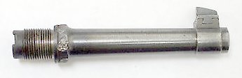

Heh...There is a Lahti M40 barrel on eBay right now...
Swedish LAHTI M40 9mm Pistol Barrel
http://www.ebay.com/itm/Swedish-LAHT...-/291544282545
I do not recommend anyone buying it - here's why -
Condition: Used
Seller Notes: “Used with removal dings at the hex area, nice bore”
Heh, heh..."removal dings"...heh, heh...You trashed it you douchehead!!!

Unread 08-30-2015, 03:44 AM   #16
Zorba
Zorba's Avatar
Location: Merritt Island, Fl
Posts: 952
Thanks: 777
... ??? ...Why would I want it???
'Cause you're one of the few that could actually fix it!
Condition: Used
Channel locks can be used on many things. Apparently pistol barrels is one of them
Dave
Unread 08-30-2015, 10:15 AM   #18

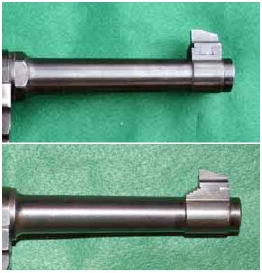

If it were a reasonable price (like $20, which is all it's worth like that) I'd buy it, cut off the front sight band [and bore & tap it for a custom barrel] for later use and make another receiver thread chasing tool out of the rest. The Lahti thread is the same as the Luger (although the shank is longer) and there are some Luger barrel extensions ['receivers'] that are crudded up pretty bad with old dried up powder/grease/dirt.
As is, the only part of this barrel that's worth anything is the front sight.
Unread 08-30-2015, 10:51 AM   #19
Starting the thought process towards acquiring a Lahti. Any thoughts...
Yes, a thought. IMHO, the tapered barrel [trumpet shape] is much 'prettier' than the hex barrel. From the gotavapen site it appears that the hex is the older/original style and the tapered/trumpet style is the newer/arsenal refurbished barrel. I would look for the newer style, particularly the arsenal refurbished Lahtis. The finish is quite well done, although it is [lightly] buffed.
I do like the front sight band on the hex barrels.
I don't like the square-ish thick trigger guards of the hex style Lahtis.
Boy, what a snob I am.
