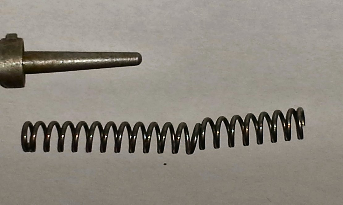

At the advice of another user I am creating a new thread for this issue. Hoping to solve a problem I have with a 1916 Erfurt. In my case the gun will not **** at all, even by hand. The action seems to work, it will hold open with an empty mag, but doesn't seem to **** or dry fire no matter what. Internally the gun looks good. The only thing I see is some noticeable "peening" around the Breech Block where the Firing Pin Spring Guide locks in. That FPSG also doesn't seem to stay in very well and often pops out when field stripping. I am afraid I will need to replace the Breech Block and the FPSG since both look worn and don't provide a very positive lock and that looks like a $100 from Numrich. That wouldn't be all that bad, but I dont think that's the entire fix or why it wont ****. The Firing Pin Spring itself is a little bent (possibly caused when the guide pops out). I plan on replacing the spring, but looking for advice to solve the cocking problem at the same time. I read the sticky thread about cocking, but if the problem is the lever not slipping over the Trigger Bar, shouldn't you be able to release/dry fire it with the side plate off and by depressing the trigger bar? I don't think my problem is that its not releasing, it appears not to be cocking to start with. Thanks again. ChuckM

I do not think a bent spring is the problem; though it should be replaced.

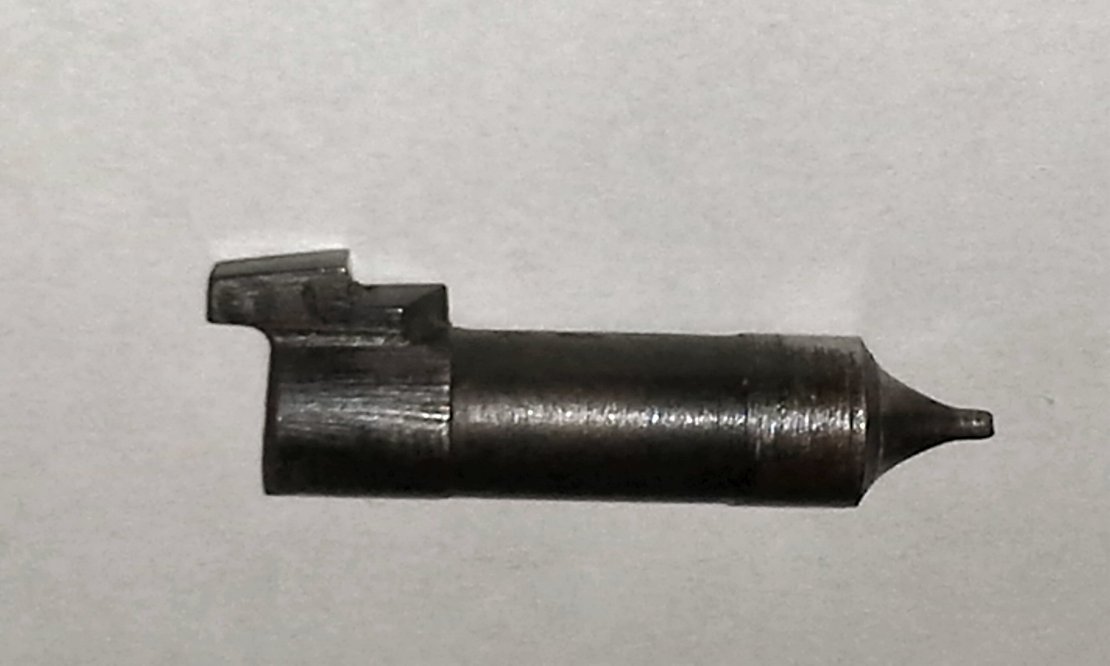

Remove both the sear bar, and the firing pin and take clear focus photos of both from different angles so we can diagnose the problem further.

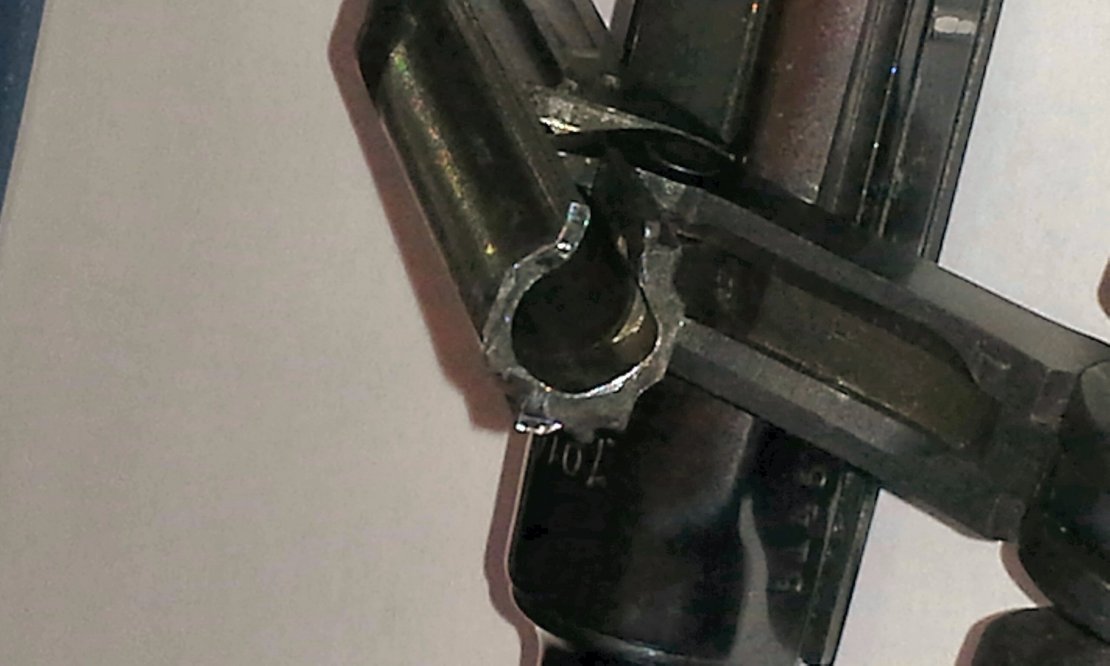

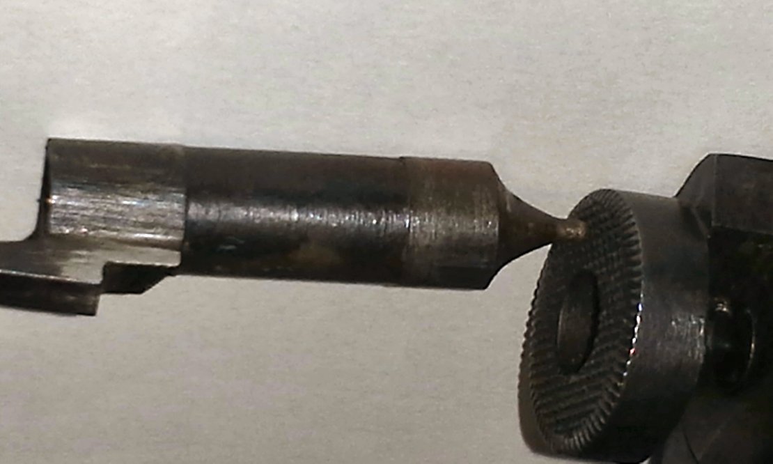

Thanks so much for your reply. When doing as you asked, it immediately caused the Firing Pin Spring Guide to shoot out of the Breech Block. It is the face of the Breech Block where it shows signs of damage, what I would call "peening" of the metal and the locking tab channel inside appears very shallow and worn. I have included some pics of those parts. The sear bar that you refer to, I assume, is what is referred to as the Trigger Bar on the schematic? I don't know how to remove that. I am guessing it involves prying up the Trigger Bar Spring somehow? If you could give me some addnl instruction on that I will remove it and post some pics. Thanks for all of your help. C.

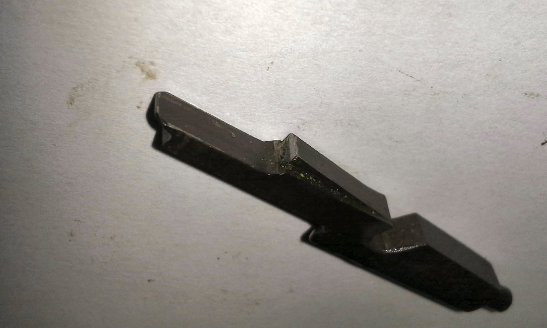

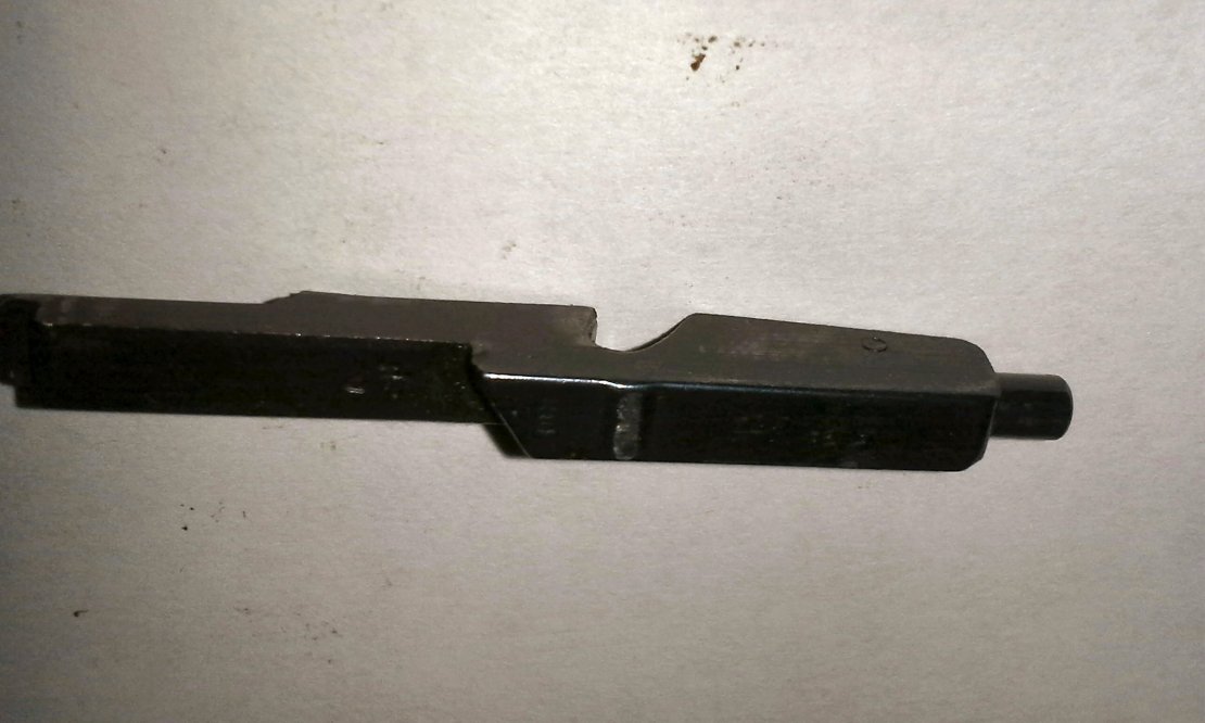

Got the trigger bar off and here are some pics of it. C

From what I can see, I believe that the breechblock is your problem.....or at least part of it. If it won't hold the firing pin, spring, and guide as it tries to set on the sear, there is no cocking of the firing pin. Also, there looks to be something "off" on the sear bar, or it is just the angle of the photo that gives it that impression.

I would try another breech block, or a toggle assembly- but I guess you don't have another or you would have done that already.
Got a friend with a luger? I'd borrow a toggle from a shooter and try it.
Since the FP guide won't stay in place, it does seem the block is the likely culprit.

Chuck, You definately need a different breech block or have the rear or your current one welded up, if your pistol is otherwise matching. You may also need a different sear. TH
