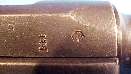

The stamping I'm interested in looks just like the letter in my original post except it is underlined. I believe the letter J looks like that below.
