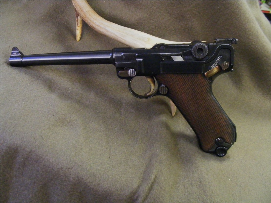

I have to admit it: I love shooting Lugers. But in their military configuration they are not target pistols: the sights are horrible and get worse every year; and the trigger pull leaves a lot to be desired. So with a little time on my hands this winter, I decided to put together a "Target Luger". The objectives were: a longer barrel, better sights, and better trigger.
I have always like the elegant lines of the Navy Luger; it just seems more graceful than the 4". In addition, the longer sight radius of the 6"barrel offers the potential of better accuracy. I wanted adjustable sights for the sharper picture and the ability to adjust for different loads. Improving the trigger pull was also on the agenda. AND I wanted to do this without ruining the classic lines of the Luger.

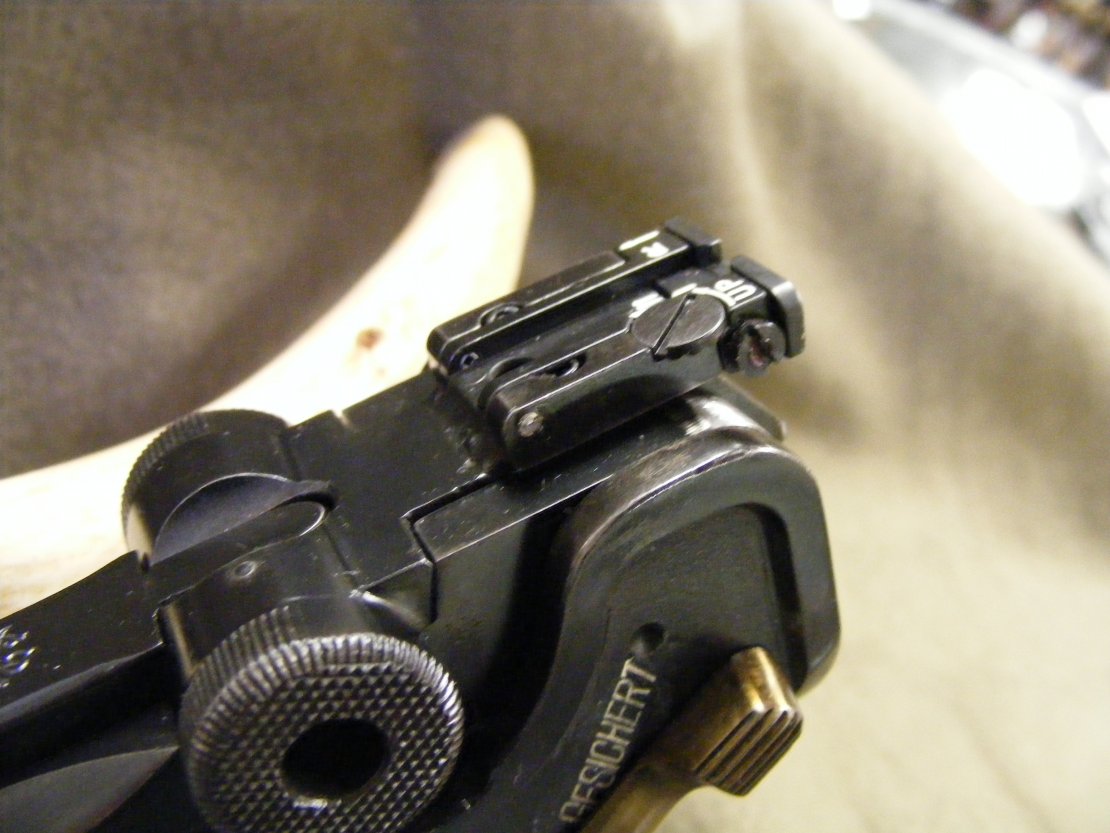

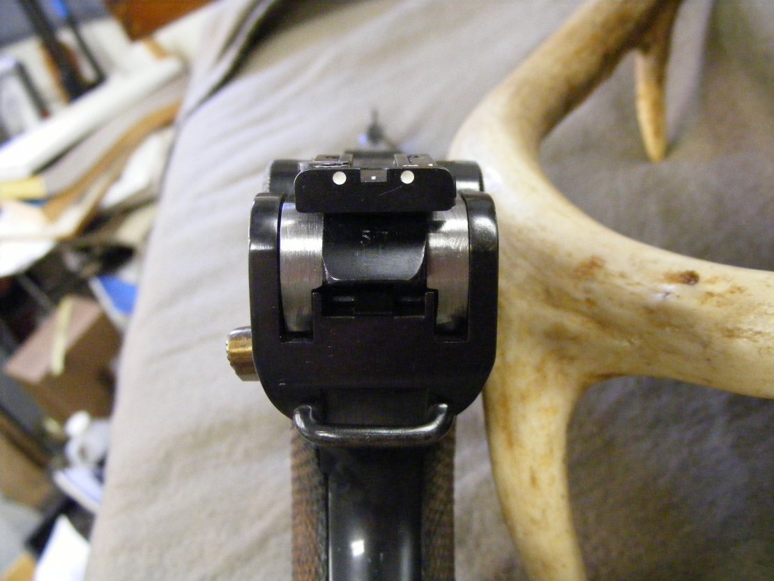

The rear sight was intended for a Glock. It was the lowest profile adjustable rear sight I could find. The dovetail attachment was removed from the bottom of the sight. The Luger's original sight and 'hump' were machined flat. The new sight is wider than the rear toggle, so the forks were re-shaped to provide clearance for the sight as it travels with the rear toggle. Some of the final fitting has yet to be blued. The rear sight base was carefully TIG welded to the rear toggle. GT provided a beautiful 6" barrel, Brownell's was the source of the front sight blank.

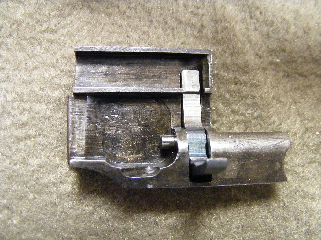

Trigger work was primarily to take the slop out of the system. The trigger lever and plate were drilled for a larger, tighter fitting pin. The lever was also bent to bring it closer to the trigger bar when at rest. The sear surfaces were polished, but the angle and amount of engagement wasnt changed. It now breaks cleanly at about 8 pounds.

in order to bend the trigger bar did you have to heat it ?
Ive tried to bend a few and always seem to break them

Hi Jim, I wouldn't try to bend a trigger lever without having a couple of spares on hand to replace it with. They are super hard, and very brittle and prone to snap if you bend them cold.
I would try heating just the leg you want to bend until it turns a dull red in color and then let it cool without any help. Then try your bend, but don't be surprised if it still breaks.
An alternative to bending would be to have a precision welder build up the lower arm surface that touches the trigger (leave the vertical part of the lever alone IMHO), and then polish it back down slowly by hand (or with a dremel polishing head) until you have achieved the dimensions and surface that gives you the trigger manipulation you are looking for... It may take you several attempts, but at least you won't snap the trigger lever.

John, you are right-on about the brittleness of the trigger lever. I realize I was flirting with disaster when I heated & bent mine. Whether the LPA sight has the strength to stay together for a couple of hundred rounds is part of the experiment. I'm mildly optimistic.
