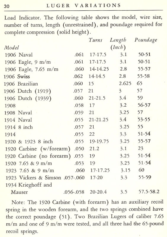

Somebody else usually posts exactly the same thing right after I do, so when they do, I'll delete this...

Unread 04-17-2015, 08:25 PM   #4
G.T.
Location: Chandler Arizona
Posts: 3,541
Thanks: 1,342
Default That's it!
Closest is the 08 one? funny thing is, the 08 was issued without a hold open... they added them later... The particular frame this spring came out of is a Mauser 1938, but obviously not original to the gun.... But, it had issues with inconsistent hold open on the last round.. Put a WW2 Mauser mainspring in it, and boom! 100% hold open function........ I wonder if a mainspring change wasn't performed along with the hold open added operation?... Best to all, til...lat'r...GT ...... Thanks Rich!
