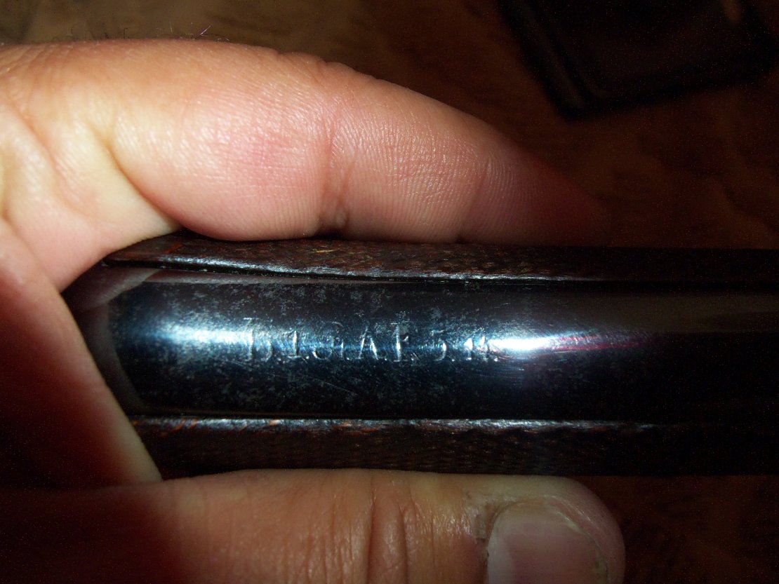

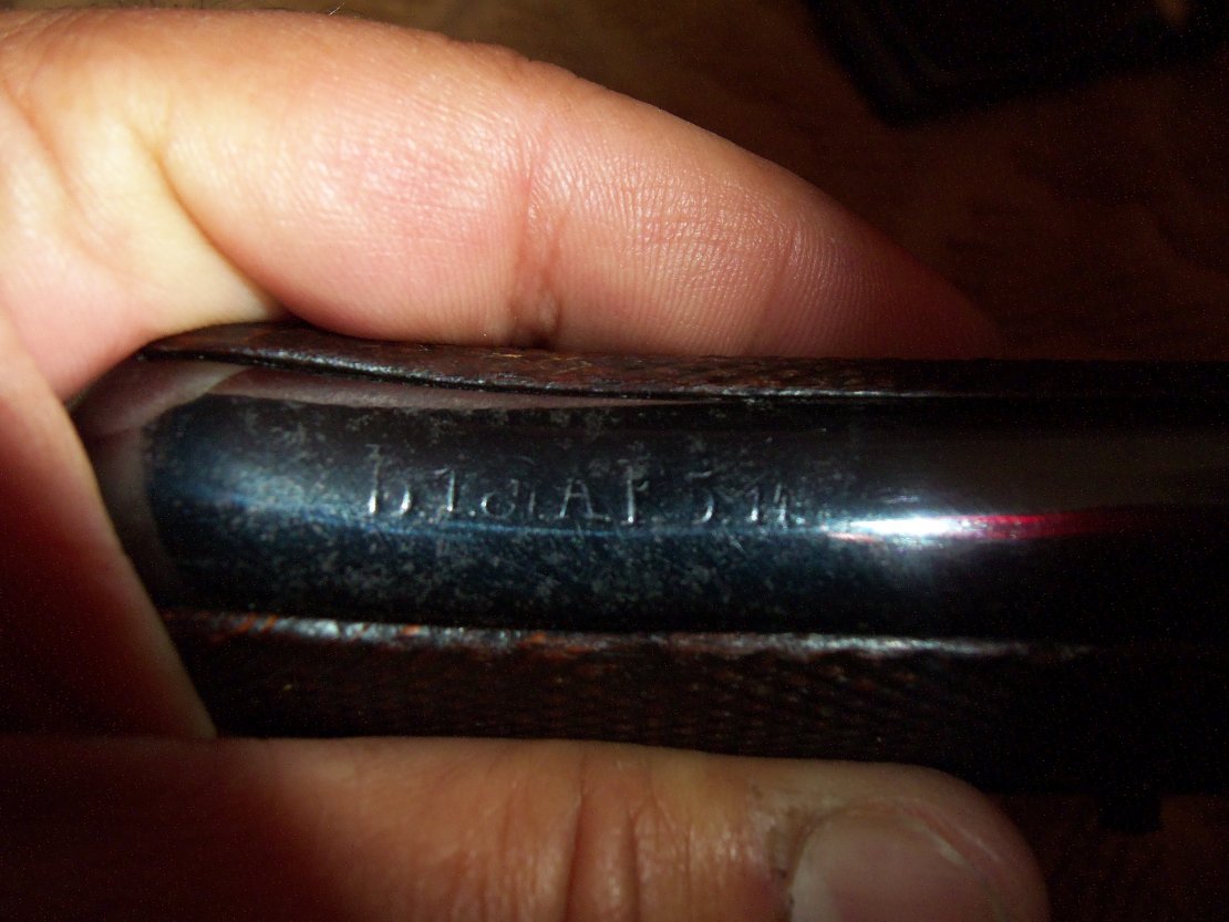

Unread 03-19-2015, 01:02 PM   #4
This is the best the owner could provide. The gun has obviously been refinished, but any other insight as to the Unit Markings would be appreciated.
Thanks!

Unread 03-19-2015, 01:05 PM   #5
More

Unread 03-19-2015, 01:29 PM   #6
klaus 3338
Join Date: Jun 2009
Location: Germany
Posts: 524
Thanked 432 Times in 165 Posts
Looks like B.1.R.A F.5.14 for Bavarian 1. reserve foot artillery regiment. 5. Batterie weapon (Luger) 14 which make more sence than L.1....

Unread 03-20-2015, 02:09 AM   #8
klaus 3338
Join Date: Jun 2009
Location: Germany
Posts: 524
The I. Bataillon of the Bavarian 1. Reserve Fussartillerie Reg. was part of the Alpenkorps and the II. Bataillon of the 6. Bavarian Infanterie Division.
