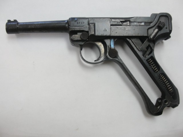

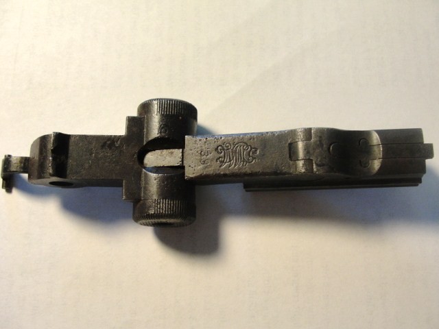

My second Luger #2787 was a very nice DWM 1915 all matching, but no toggle, grips or mag - $525. I had a 22LR kit for it and it is a complete toggle and barrel liner - $400 - so just needed some grips. It shoots fine. But then I noticed a complete DWM 9MM toggle set up for sale and so bought it for a dual caliber use - $149. It needed the rear pin. So I bought the toggle and a 0.05 pin, but I had to use an emery cloth & clean the rear pin to match the toggle in clearance. It shoots 9mm fine. So ever since Eli Whitney and his 1801 interchangeable gun parts, this concept has worked. And I really wanted a WWI for shooting, at $675 + grips here with membership, it is GREAT!!!
