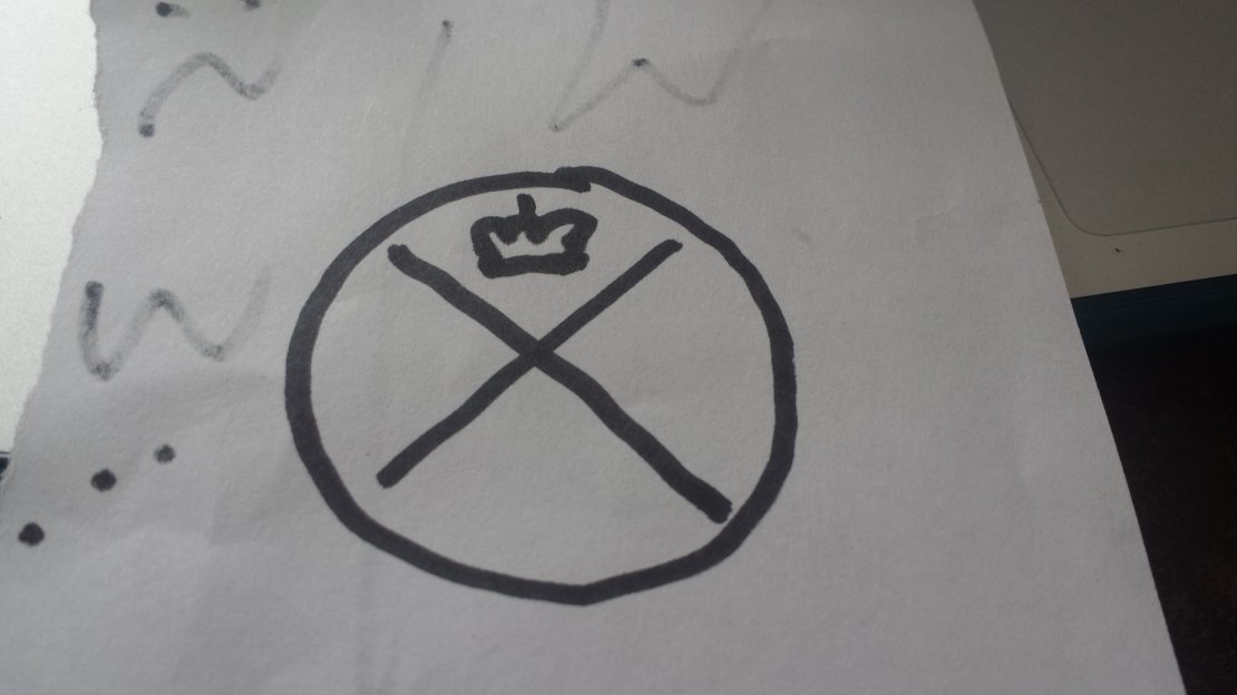

It has some very strange proof marks on side. Looks like a Large circle about the size half the size of a dime with a cross in the center and a crown above it.
Ill draw a picture. Sorry when I get pics ill update this.

You're most likely looking at a "X" that was marked when this was captured by the Russians.
The Erfurt proof marks are crowns over a Fraktur letter.
All Erfurts were military guns since they were made by the Imperial Arsenal under license from DWM.

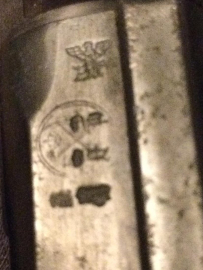

Does this help any? Its a horrible pic but its all I have. I also noticed the eagle seems to be sideways instead of right side up??

If the upper receiver serial number matches the rest of the gun parts serial numbers, then it is likely that some previous owner ground off the year stamp that should appear above the chamber. Only some good photographs can provide more detail than you have already been given.

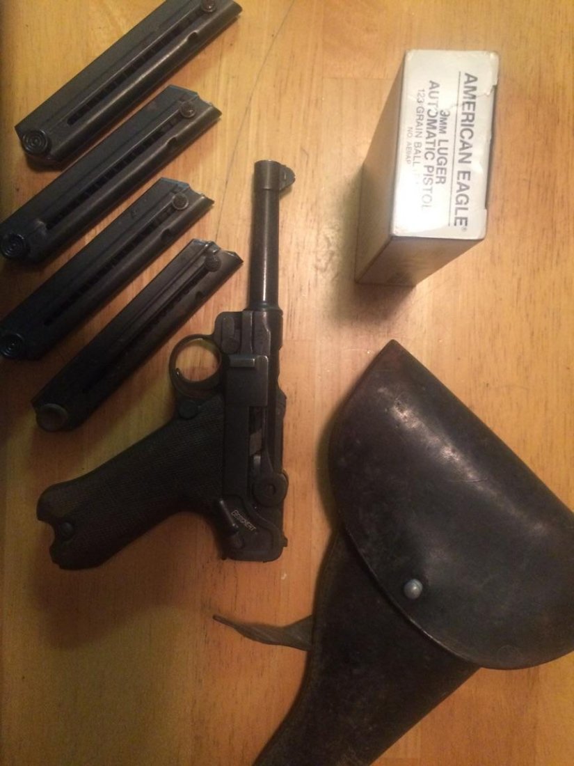

Some more pics. So if this is in fact a parts gun is it possible they were able to individually stamp every part to match? If so how did they remove the old numbers? Im asking because Im curious by the way. I hope Im not coming off as combative to your knowledge.

It depends who rebuilt the gun. There were plenty of blank part available to armorers at that time which they could fit, install, number and then re-blue.
Regarding the photos, you say here are "more". Is there a total of 3 posted or did I miss some?
The extractor seems to be ill-fitting, suggesting a replacement part, but that is about all that I can tell you from the last 2 photos.

Unfortunately those are the only 3 pics I could get. Ill take my own personally this weekend.
Does anyone find the eagle proof mark on the receiver strange? I cant find another luger receiver with a similar mark. Ive looked all over.

The circle with a cross in it is a British proof, although it is unusual to see it in a circle. The gun has been "commercialized" which may account for the date being ground off. The eagle is an independent firing/rework proof used by gunsmiths to conform to the 1940 German proof law. There should be a letter under the eagle but it may be obscured by the original Erfurt firing proof. If it is a "N" it is a nitro firing proof, if another letter it is a rework mark.
