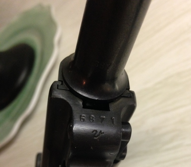

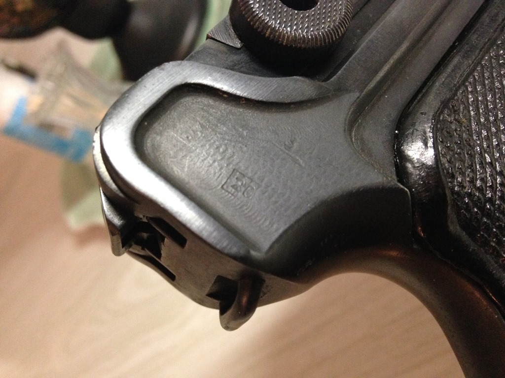

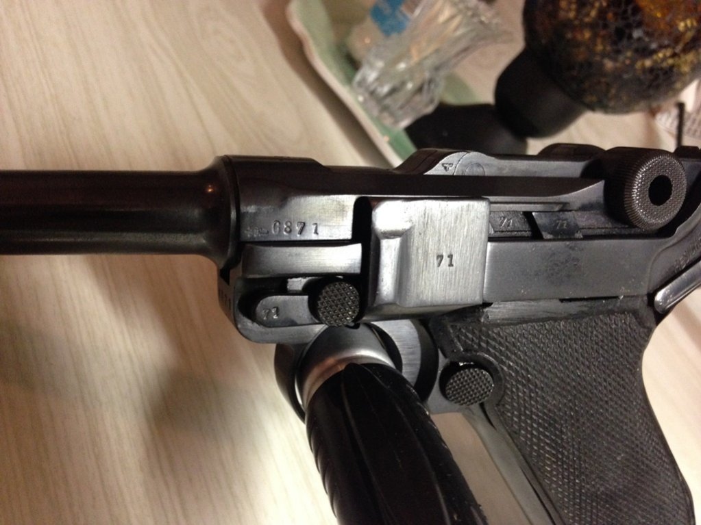

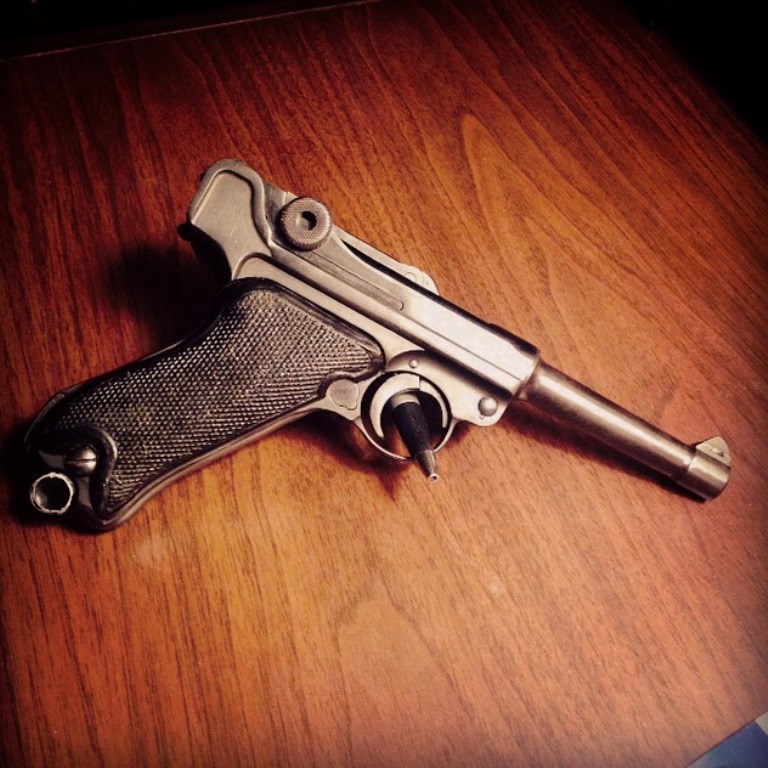

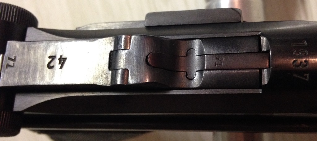

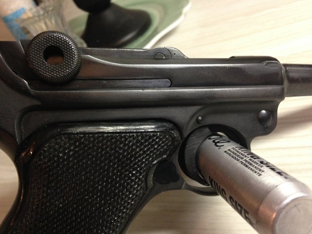

Default Better pics of the Luger 1937
I think I have the photos figured out.
Wilson1937/42 is offline   Reply With Quote
Unread 01-23-2015, 08:13 PM   #8
W:
Congratulations, looks like a great shooter! It has been switched around over the years, but it looks good. How does it shoot?

Thanks!
As far as a 'switched around' what exactly do you see? (Just learning) I know the grips are incorrect and I will be looking for period correct wood grips.

Unread 01-23-2015, 09:23 PM   #10
Don't pour money into changing your new Luger. It has been refinished as well (the WaffenAmt inspection marks are scrubbed off the right front of the receiver).
The Crown/U inspection mark on the left is likely a VoPo rework inspection mark. It's possible that the twenty in a box was applied at that time also (I have not seen that mark before).
You have a very nice shooter, and it should function well...
Is there a "69" stamped inside the trigger plate? If so, the grips and magazine may be the only parts substituted.
It's unusual to find the sear safety block blued. They normally stayed in the white. This makes me wonder if this Luger was dip refinished, which was often done by the Russians and VoPo.
Is there an "X" stamped anywhere - perhaps on the rear axle pin?

Unread 01-23-2015, 10:11 PM   #12
You asked about my "switched around" remark. I am referring to the black grips, probably the magazine, the black finish, and the "42" center toggle link. These guns were reworked to function, not be original. That is why I say you have a fine shooter.
Unread 01-24-2015, 12:25 AM   #13
The double crown over U is the correct commercial proofing for 1939, but I would have expected it to have a Mauser Banner center toggle link, vise the military code 42. The grips are Portugese replacements. if they also reworked the pistol, there may be some Portugese proof under the barrel. Check it out. Tom
Unread 01-24-2015, 07:30 AM   #14
Your grips are also not original, but poorly made castings.
Unread 01-28-2015, 02:00 PM   #15

Marc- the number stamped inside the trigger plate is "68" and I do not see an "X" anywhere on the gun.
Lugerdoc- I find no proof stamp under the barrel that you are referring to. (Portuguese)
DJU- thank you.
