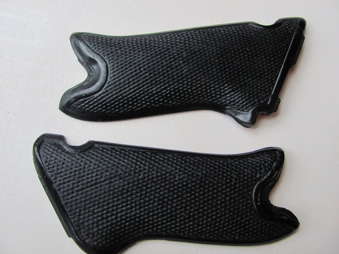

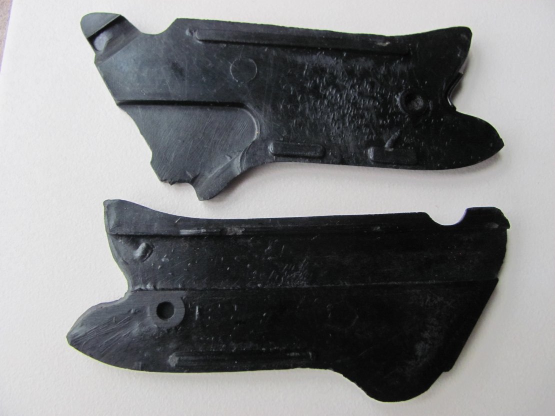

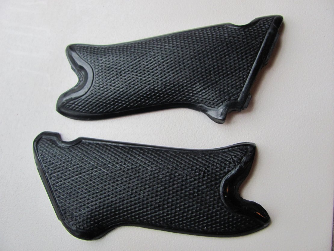

Can someone help me with black plastic P08 grips? I'm unsure how to tell if these are real or repros'. They came on a mismatched BYF41. Pictures are in nature light.

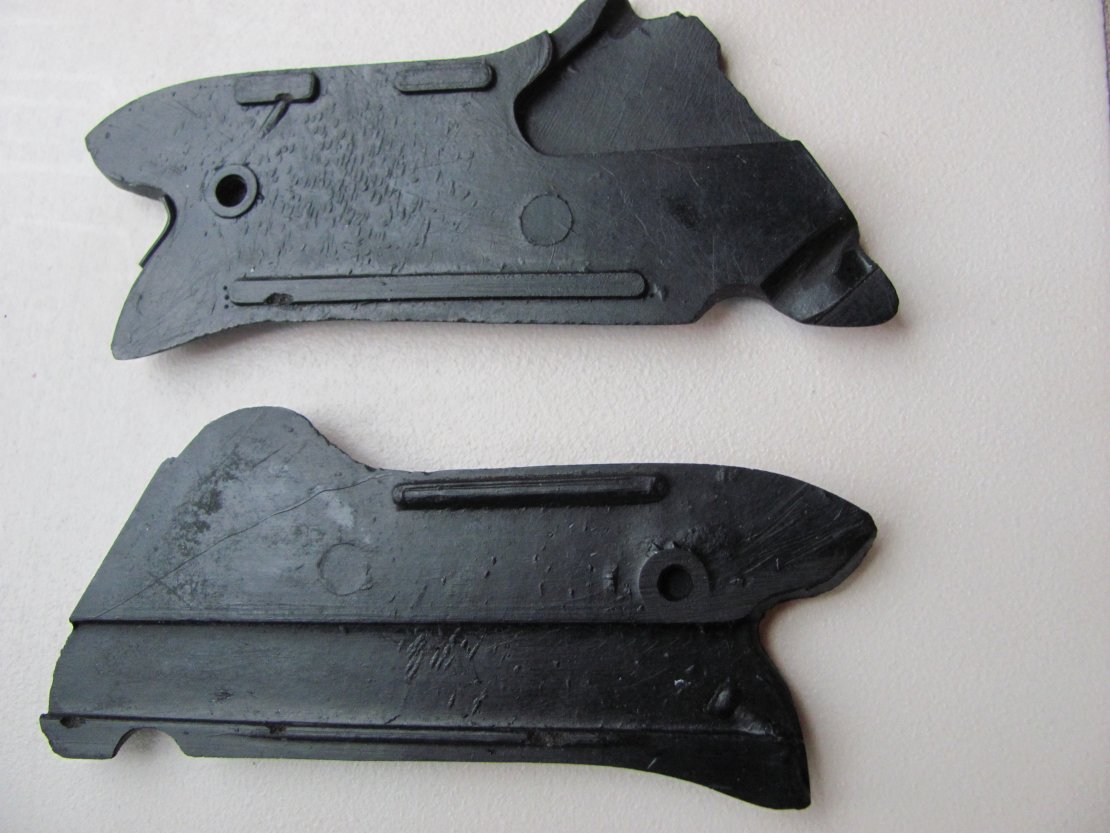

Two more pictures.

Aftermarket.

Copied/ cast from a pair of grodey grips. The backsides look terrible, and the fronts have incorporated all the blemishes and wear of whatever they were cast from. Other ways to tell plastic from real Bakelite would be the 'hot pin test', and checking to see if the holes in the back are threaded to accept a grip screw.

Aftermarket too.

This type of panels are fragile after decades. Don't shoot Black Widow as is. No need to test those panels. That also implies spare genuine black panels are not easy to come.

From the pictures to me they look like copies.
