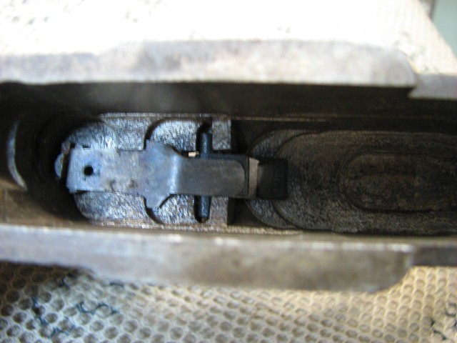

Since my gun was sold, I have to borrow a picture to show 1980 Shansei's frame internal. Please look at this -- this is not milled, this is cast.

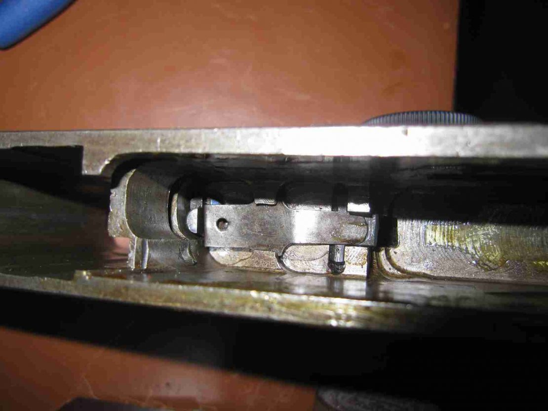

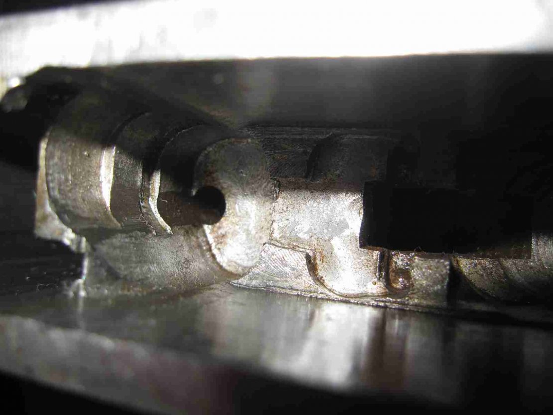

Comparing a shooter 1930 I have to the Shansei I'm still not certain it's an actual grey iron casting. Probably isn't Mauser grade steel either but that shouldn't surprise anyone.
Photos ( yes I'm doing this after New Years celebrations! ) of the inners of the Shansei - I removed the magazine latch trigger spring and of the 1930 commercial with the spring left in.
I've never fired mine. Never intended to. The bulk of my C96 collection suffers the same fate in my safe. I have only two examples that I shoot and at that rarely. Ones I built from parts, had relined and I rust re-blued. None of my core collection will I fire.
I've thought about firing the Shansei but never very seriously nor if I were to fire it probably no more than 5 shots. If it jammed or mis-fed I'd stop period. It isn't that important to me.
If Alvin's assertion is correct and the frame is cast iron I'll never fire it. won't risk breaking it.

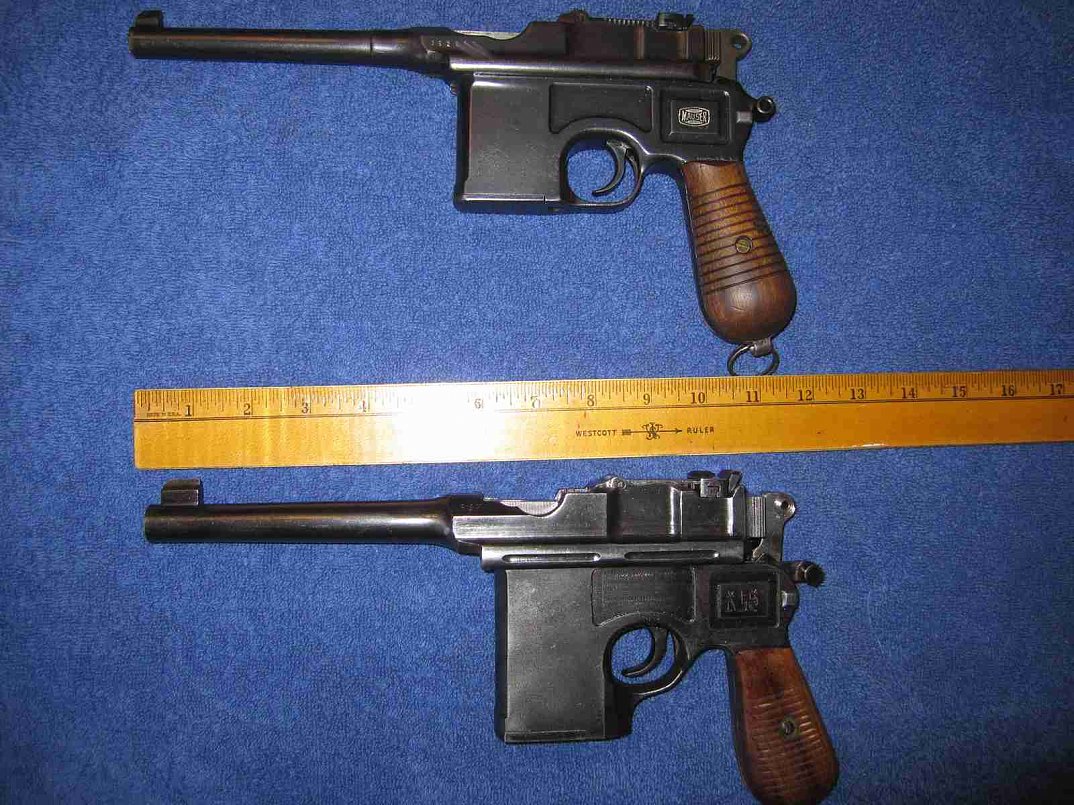

The two pistols I compared. The 1930 commercial is my shooter that I've worked on, it's wearing Nil grips.
The Shansei is particularly annoying to reassemble as it is difficult to get the lock work to engage the upper for reassembly. I can literally reassemble a a C96 lock work and reassemble the pistol in the dark(!) but the Shansei tests my patience.
As to the caliber discussion I'll ask Alvin: since many have said here /elsewhere and proven(?) that the large pistol isn't chambered for 45 ACP does anyone here have or has seen original ammunition for these? Or is it like the 8.15mm Mauser that to my knowledge ammunition still has yet to be found ( I do have a copy of the DWM cartridge book that shows that case). I have two C96 examples in my collection that are supposed to be chambered for the 8.15x 25mm Mauser; one a very later 1930 and the other a mismatched very unusual Mauser Banner over chamber piece
Jerry
