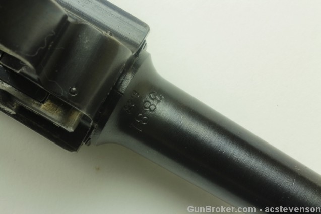

Default Has this Simson been renumbered?
This auction lists Simson Luger number 3881:
http://www.gunbroker.com/Auction/Vie...Item=458655806
The areas of the serial number on the receiver and the frame look ground down and renumbered to me. The font on the frame looks odd.
What do you think?
Unread 12-18-2014, 10:40 PM   #2
Let's see..grind marks, funny numbers and fresh blue..NAH..who would do that?
The following 6 members says Thank You to lugerholsterrepair for your post:
Unread 12-19-2014, 01:42 AM   #3
I have it in my database. Looks nice, but fonts not correct...
Unread 12-19-2014, 02:05 AM   #4
MikeP
MikeP's Avatar
Location: ILL
Posts: 686
Thanks: 36
Tomfoolery
Unread 12-19-2014, 12:29 PM   #5
Strange shape numbers, they look just printed, bah! Who knows there must be an explanation.
Unread 12-19-2014, 01:01 PM   #6
Ben M.
Ben M.'s Avatar
Posts: 496
Thanks: 108
Thanked 155 Times in 97 Posts
are barrel numbers bad? seem large but i do no buy simsons
Unread 12-19-2014, 04:47 PM   #7
Actually, the position, font and size of the barrel digits do look like those on my Simson, made about 2,000 later.
Unread 12-20-2014, 03:33 PM   #8
May want to post a picture?

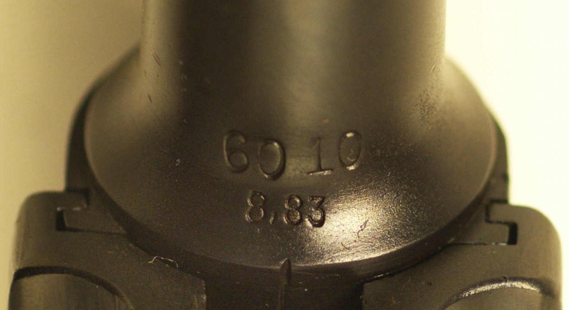

Unread 12-21-2014, 04:18 AM   #9
Default Simson barrel sn
Here is a sample Simson barrel sn:

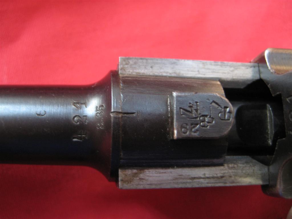

Unread 12-21-2014, 02:58 PM   #10
Marc, I had a Simson in the past. It's original. There are not many Simson floating around, so it's also in Ed's book.
The gun was sold. But its ad pictures still belong to me. Here are the front view and barrel view of it. Look and feel being different?
