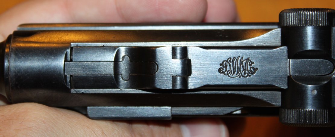

Love those "Sweet Heart" grips! Part of the guns history but diehard collectors will blanch. The Luger is a 1906 Commercial model. Nice find!

A very nice Luger. It is a 1908 Commercial in 9mm. A real prize and I agree with Norm that, while it does detract somewhat from a pure collector standpoint, the photo grip is a charming part of the gun's history and should remain with the piece.

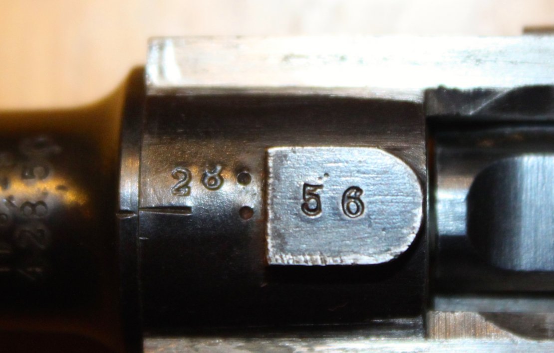

I'm not clear on the rationale behind the second set of numbers under the barrel (118.36?). Also, are the numbers on the front of the frame 42356?. Any letter beneath the numbers?

David, I have also wondered about the 118.36 under the barrel. I saw one reference that it was related to the caliber? Also the serial number on the barrel and front of frame is 42856 (8 and not 3 in the middle).

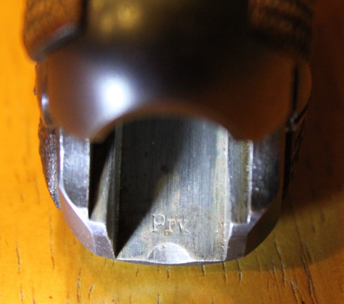

Any information on the "Prv" stamp in the magazine well? I have read it designated groups of commercial weapons bought by the German government for resale to soldiers. Any good documentation on that? With the WW2 era medals (issued just before hostility broke out), issued to WW1 veterans, it is interested provenance that this could have been captured from a soldier that not only server in both wars, but possibly used this weapon in both as a personal purchase.

The numbers regarding bore diameter are generally something close to 8.83 or 8.84 (land to land measurement). Yours looks like 118.36 if I am reading it correctly.

The 118,36 is a bore measurement now archaic for pistols, but still in use for shotguns (12 bore, 16 bore etc.). It's the size of bore that would accommodate lead balls 118.36 to the pound.
Imperial era Commercial Lugers numbered into 5 digits with no suffixes.

It's a BUG proof so it probably dates 1908-1910. In your pistol's condition it is pretty scarce and with the Prv marking probably worth close to $3000.

George, am I right on the "Prv" marking designating a weapon bought by the Getman gov, to be sold to soldiers? Only found a few references to that, but nothing definitive.
