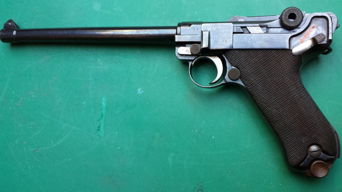

Mine is a 1917 Artillery (i hope) all numbers 37 except rear section of toggle link and possibly the barrel, and magazine. My father bought this in Chicago in '65. It was last fired in '90-ish. Now it is mine.

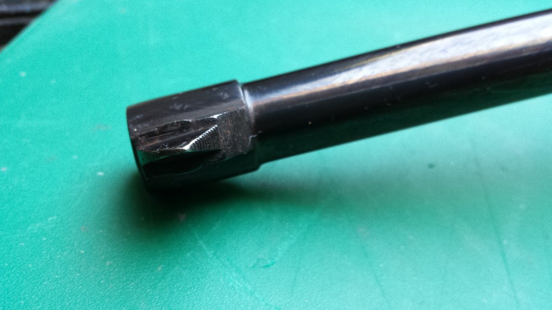

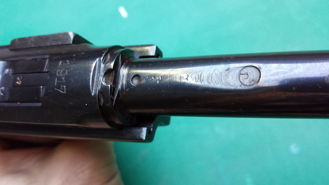

After some reading here and elsewhere, i'm coming to the conclusion that the 8" barrel on this was turned or machined somehow at the breech end to get rid of the squared section for the mounting of the sight. if this is the case, i want to find the machinist and begin strangling procedures!
The bottom of the barrel where markings would typically be found shows absolutely nothing. also, i can't discern numbers on the front sight, but maybe the small cross piece was punched out, inverted, reinstalled, hiding the 37?? see that pic, showing a line punched in to the top right side of that little cross piece.

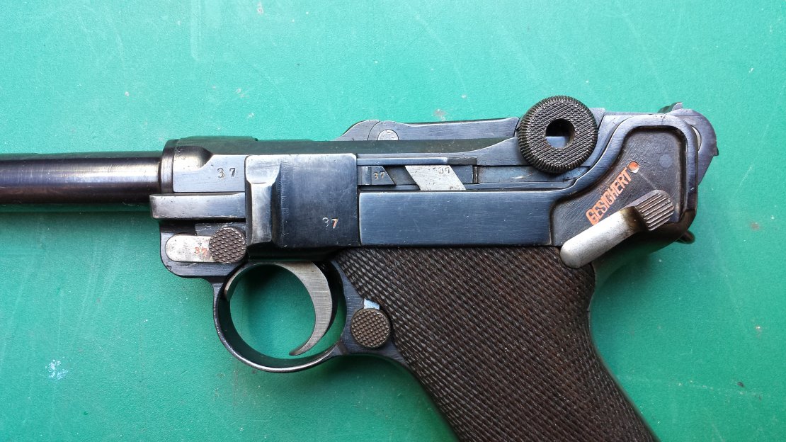

You are actually lucky..this is not an Artillery. Someone put a FUBAR Artillery barrel on it..but it doesn't belong to this pistol. Well..with the mis numbered rear toggle part it MIGHT have been once..This mis matched part has a rear sight that wouldn't be on an Artillery pistol.
The sight base has been lathe turned off?

I agree that the barrel is an artillery that someone turned down at the rear sight area and that a rear toggle with sight was added in order to create a longer sight base. Turning down the barrel at the rear sight would have also eliminated any markings usually found there, so that you will never know if the barrel is original to the pistol.
The gun has been buffed and refinished as well.
This makes the gun a mismatched shooter worth maybe $800 or so.

The relief notch for the original rear sight leaf clearance is on the frame, which means that this would started out as an artillery. Strictly speaking, I'd call it an Artillery with two major issues. I agree with Doug about the rear toggle link. Way too bad about the barrel... But it is reminiscent of commercial Lugers Stoeger might have re-barreled in the 20s? Aside from the aesthetics and finer points of the approach used on the former rear sight, an 8" Luger with standard sights looks just fine to me. And it would have a sight radius of about a foot. It should be a gas to shoot!

Ahh, cool. you're talking about that little flat that runs transverse just about 1/2" toward the front from the '1917'... hmm, cool observation.
The number stamped into the rear toggle... at first looks like a 32, then i realize the original font would make that first number a 7 then there's definitely a 2... but there's weird stuff going on there: definitely some over-stamping and another strange symbol or lettering/numbering at the upper area of those numbers. Would you happen to know if Stoeger used to stamp their own info on the guns they de-flowered?

Ross, I'm not saying it was re-barreled by Stoeger. It was an 8" LP.08 when it was born. Somebody turned down the barrel and removed the accommodation for a rear sight. A mis-/force matched standard rear toggle link was changed in, its v-notch sight to compensate for the loss of the barrel's sight. After all this heavy-handed surgery, it looks like one of the Stoeger Lugers. They would re-barrel in a number of lengths--some of them approaching outrageous--and the standard rear toggle link was retained.
Even if you found a rear toggle link numbered 37 with no sight notch, you'd need to find an artillery barrel with sight leaf intact, and all those parts would need to match, too. The odds of returning this pistol to number matching are homeopathic!
