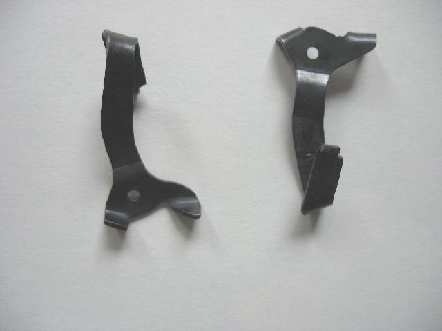

Look for one in the archives. It is a bent piece of spring steel, which went behind the trigger. Inserting a magazine pushed it out of the trigger's way and allowed the pistol to be fired. It was a poor design that didn't always work, so it was done away with.

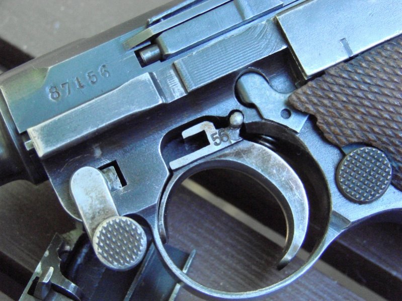

Here's a photo of one that was deactivated by removing the portion that went behind the trigger.

Here some pics from the part out from the luger
