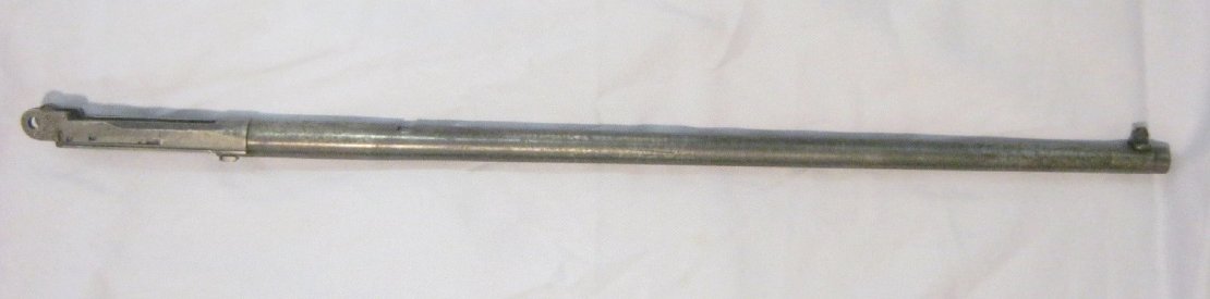

Ken/Revshop had a 20" 30 cal barreled Luger action a week or so ago...I found it mildly amusing...I saved a pic...
Hmmm...Somebody made an offer on it...Accepted...
http://www.ebay.com/itm/Luger-Barrel...-/311001643683
"Gunsmith special"...Yeah!

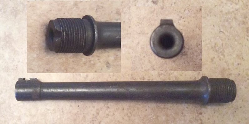

It's always exciting to watch an Internet auction/bidding war...The tentative early bids, the feints, the feelers, the bold jump in price to scare other bidders off, the flurry of bids as the deadline approaches, and the last-minute snipes...
None of that here..."Starting bid: US $50.00 [ 0 bids ]"
I have to agree: Too much work involved here. Even if someone were to re-chamber it for a .223 Luger wildcat, they would still have to modify a set of reloading dies.
"Will clean up nicely"...I doubt that...
"Standard 12 o'clock Luger type extractor cut"...That's not the 'standard' Luger extractor cut...And the thread relief is not 'standard' for a Luger...
"6 inch .22 caliber barrel"...I'm not sure it IS .22 cal...
Doesn't conclusively look to be relined, from these pics...
Looks like a monumental PITA to me...IF it's actually .22 cal...

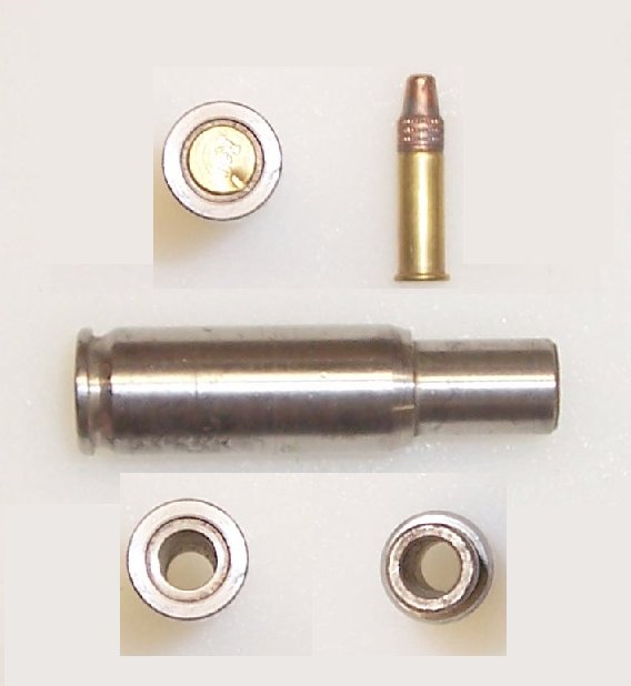

I'm not convinced that this is a .22LR barrel, but IF it is, it may be an enthusiast's attempt to shoot .22LR using all Luger components. Have to be single shot as the extractor notch would be for clearance only; no .22 magazine; have to use a dowel to poke out fired cases (think Liberator).
I don't know how effective a .22LR would be using a center-fire firing pin, but many many years ago I picked up the sub-caliber insert pictured below. It is smooth-bore .22LR, and the steel body is as follows:
- .470: dia body
- .354" dia neck
- 1.212 body length
- 1.735" OAL
I don't know what cartridge chamber this was intended to be used in; obviously a rifle, but way too short for the .308" Winchester.
But somebody thought it would work. It's very well made, not something turned out in a basement. I'd say production, maybe even gov't issue.
So this barrel in the eBay auction may be someone's attempt to center-fire the .22LR with 'standard' Luger pistol minus barrel.
IF it's .22LR...
- .470: dia body
- .354" dia neck
- 1.212 body length
- 1.735" OAL
IF it's .22LR...
That contraption reminded me of this, although the dimensions differ.
http://en.wikipedia.org/wiki/Tokarev_Sportowy_.22_Lr
It does look similar. It's definitely not 7.92 Kurz; not 7.62 x 39 Russian. Might be a .308 Winchester case shortened and formed to fire a ~.324" bullet but it's not anything I recognize. Can't be a longer cartridge (like .308 Win) or it would push too far into the chamber. Might be 8 x 57 Mauser case, shortened. Might even fit in a military bolt action rifle chamber in some way that I'm not aware of.
I'm waiting for my end mills [mail] so I'll look in COTW and see if anything looks similar...
Got this at a gun show back in the 70's or 80's.

Rich, I remember seeing .22 LR sub-caliber devices like the one you have pictured at gun shows back in the 1970's... One popular caliber was .30-30 Winchester. So a deer hunter could put one in his lever action and pop a very close range rabbit of opportunity without spooking everything else in the forest.
I also remember a two piece device that attached to the end of a spear gun projectile that actually chambered a 5.56mm NATO round.
It was reportedly used by special ops types to improve the chances of dispatching an enemy diver. The round was detonated by direct impact with the target's torso. I imagine it was probably devastatingly effective. but have never seen one used in a movie, or heard about a real-life story where the device was employed.

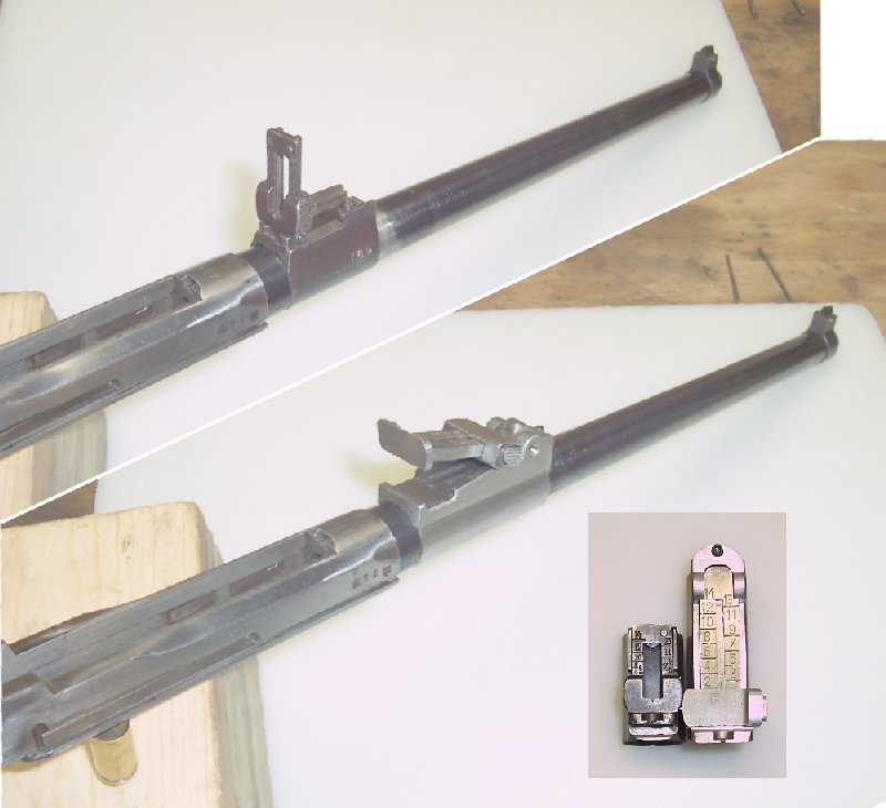

I have a long barreled Luger project waiting for machine time right now...I had a thread up about it, but I think I may have deleted it...Here's two pics from it [below]...
The amusing part is that without extensive lightening, the barrel won't recoil...The gripframe will fore-coil...
You'd have to hold revshop's 20" barreled action/pistol in two hands to shoot...And instead of your front hand going back, your pistol-gripping hand will travel forward...
I think that is hilarious...

I have to say, I am somewhat skeptical of this being .22 caliber. The profile and the muzzle pics look like 30 Luger/7,65 Parabellum caliber. Is it actually .22 caliber???
Do you have a pic of the chamber end???
Thank you for your help!
-- Rich B.
Dear Rich B.
Yep, my eyeballs were telling the truth, it's still a .22, no matter how many times I look at it. You are being fooled by it's looks in the picture because it is scaled down. It's nowhere near as big as it looks in the photo. Camera app is not cooperating, sorry.
- proudfather76
So...You pays you money, and you takes you chances...
