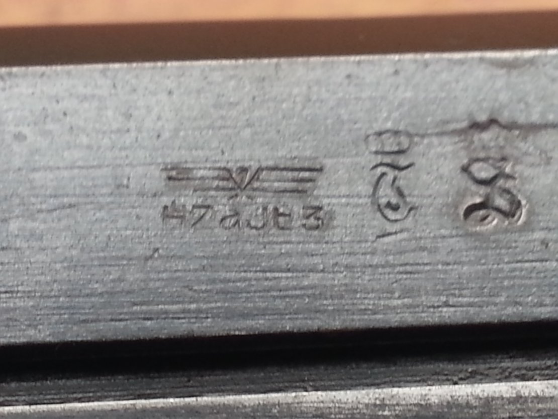

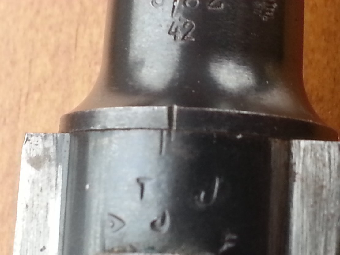

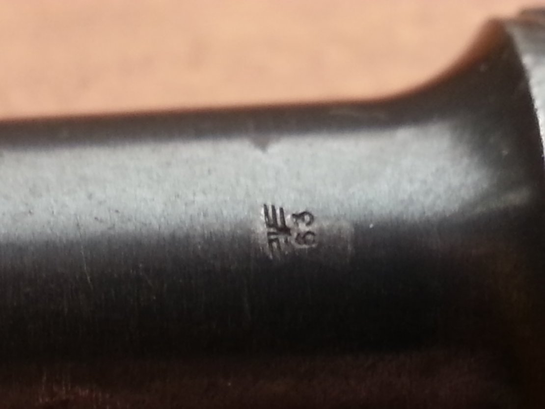

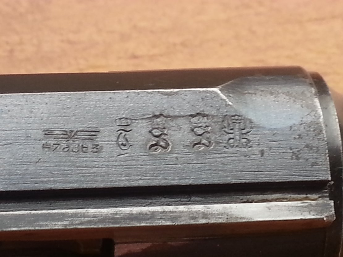

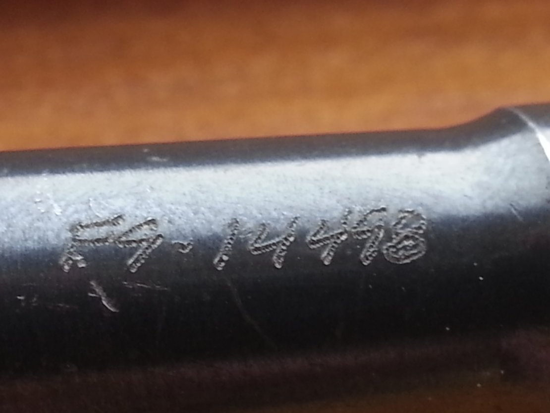

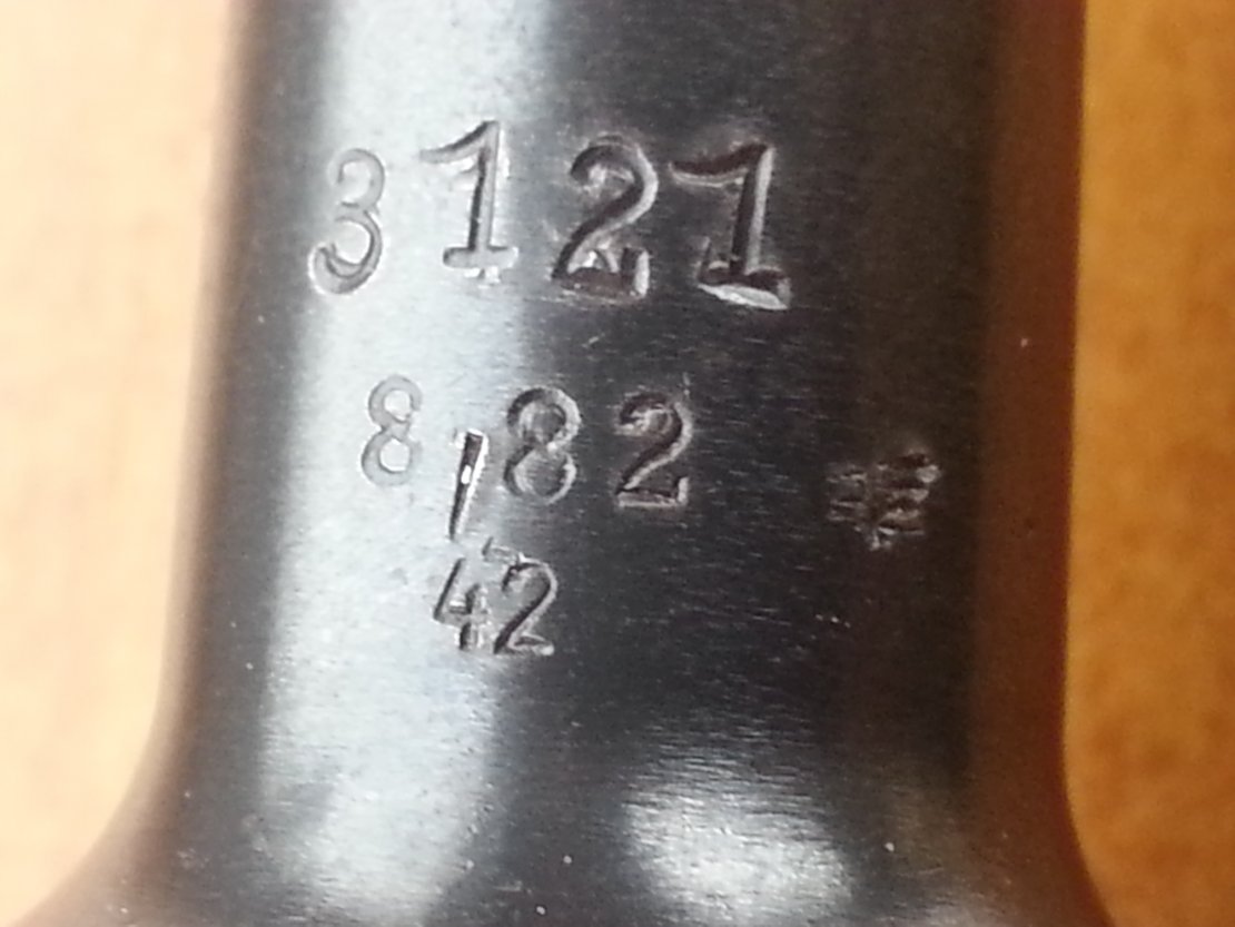

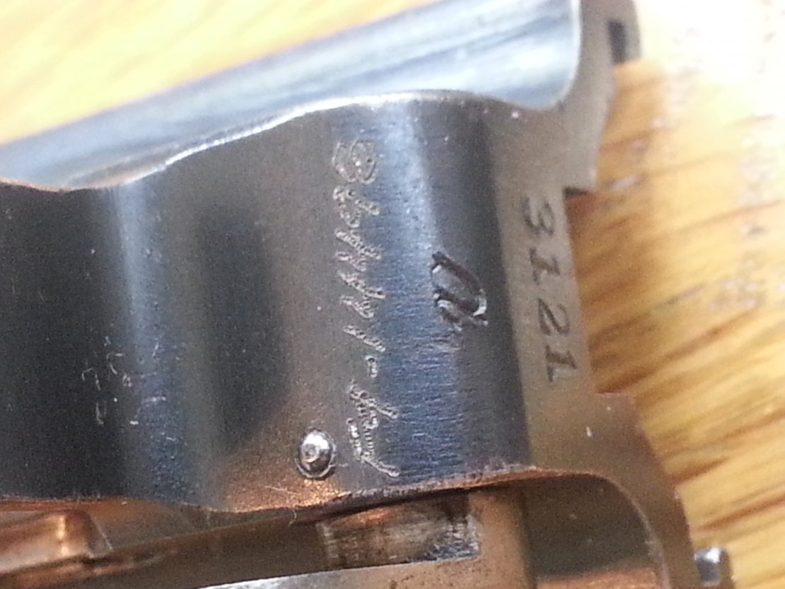

I have a Po8 DWM 1918 military. It has all the military proofs and matching numbers but scribed with a electric marker are some small numbers on the barrel and receiver looks to be F9 - 14498. There are the standard military proofs on right side of receiver but one extra one a back to back F v shape with small letters under it [ H7aJL3 ] hard to read though. the back to back V shaped F is also on the barrel twice one next to the serial number and one upside serial no. 3121 a barrel 3121 8,82 and a 42 under that . its in good shape most of the bluing is there no pitting and good bore. There is a extra barrel align mark. any ideas of what I inherited from my uncle. john jsteffs@yahoo.com

At the risk of overstating the obvious, it seems to be a WW1 gun that was later reworked, and rebarreled, by the Nazi's.
We'll let the book guys weigh in on the different acceptance marks, but I don't recall ever seeing an electric engraving pencil being used for official markings.

I would say, 1 of 2 things IMHO
1. Owner, back in the 60's or 70's this was considered a security measure and people were encouraged to put an identifying marking on an item.
2. Police evidence markings - I lean towards this, once finished, it was released, police were not known for being discrete 'back in the day'.
I would call this a low end collectable or a shooter, as it has etchings in two places, frame and barrel...

the marking on the right is Imperial acceptance and proof and then the far left is a rework marking....
Unread 10-19-2014, 05:17 AM   #10
The 42 under the barrel denotes a Mauser replacement part. The eagle/63 on the barrel is the mark of the WaffenAmt (Weapons Office) inspector who inspected and accepted the barrel. The eagle/HZaJt3 is the mark of the Herrs Zeugamt (Army Weapons Depot) at Jngolstadt (Ingolstadt) depot 3, where the rebarrelling took place.

I didn't try shooting yet have to buy some ammo. those electric etching marks probably ruin its collector value so I may just use it for a shooter. Thanks for all the help I really like this site.

For my $.02 I would class it as a 'shooter' due to the electro-pencil etchings, although if you are just starting out collecting Lugers, this is an excellent choice IMO. In my mind it is a high-end 'shooter', and in my neighborhood would probably go for $1000-$1200. Buyers hereabouts don't see Lugers very often, and don't care about re-barreling as long as it looks "original". Gun show sellers will fabricate exotic stories to explain away anything that a buyer might question.

This one rides the line between high end shooter and low end collectible, and the distinction in this area is quite subjective. BTW, all mine are "collectible shooters"! All else being correct and in good condition can go a long way in making it desirable, but this single issue will definitely repel the hardcore experienced collector, except for its appeal as a place-holder in a collection. As Rich points out, some local markets--and many individuals--do not require as much of a Luger in order for it to sell.
