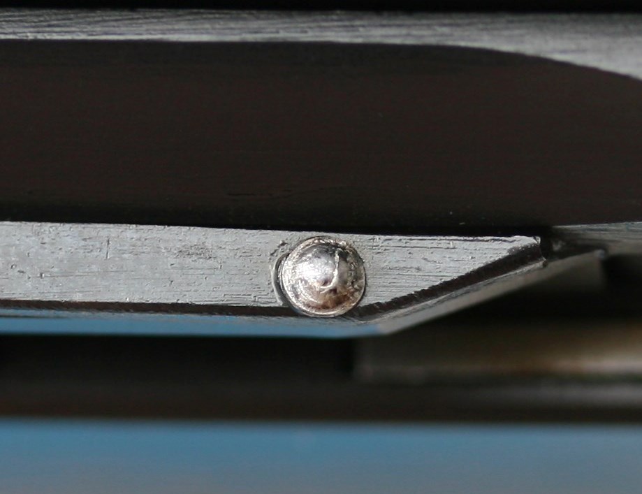

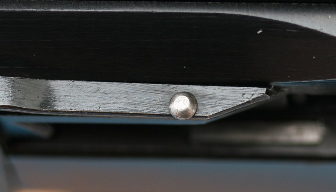

Hi G.T.
Here are a couple of rivet head photos. First is from my father's 1939 bringback Banner so I know it is correct. The second is from a 1941 Banner with a different shape.
Tom

Default rivet shape.
Hi Tom, the first one shown is referred to as a "truss" style, and the second as "universal" I've seen both, and neither is readily available, to me anyway?... .. but think the truss is certainly period correct as you have stated.... Thanks a bunch, it all helps me a'lot! .......til...lat'r....GT
