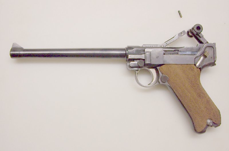

Long Barrel .22 Luger project.
This is a commercial Luger receiver [barrel extension] mated to what appears to be a cut-down, threaded, and chambered .22LR rifle barrel. There is a dovetail under the threads (visible in pic #6) and the chamber area was left long, so that a Luger or Erma toggle assembly would not seat fully. There is no extractor cut and no feed ramp in the barrel. There is a blade front sight in a slot cut in the barrel, possibly original [the slot].
The owner also has a complete Erma SE 08/2 conversion 'kit'. Looks like it has never been fired.
I'll be doing the Erma .22 conversion kit adapted to the 7 1/2" custom .22 barreled Luger...
Original Erma parts will not be modified.

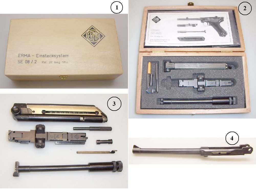

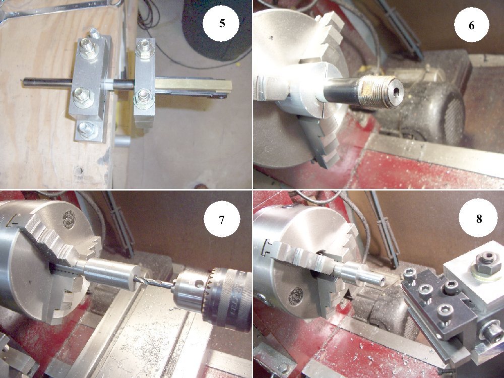

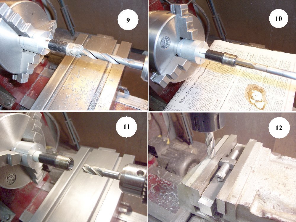

Steps in pictures
(1), (2), and (3) - Erma 22 SE/2 'Kit'
(4) 7 1/2" .22 barrel on Luger receiver
(4) Removing barrel with barrel vise & receiver wrench
(6) Turning off excess metal at breech end of barrel
(7) Drilling chamber plug 'blank' in 7/8" steel bar
(8) Turning down plug to fit in chamber
(9) Drilling out .22LR chamber for plug
(10) Reaming drilled hole
(11) Facing off blind end of drilled/reamed hole
(12) Milling plug sides to fit in Luger receiver

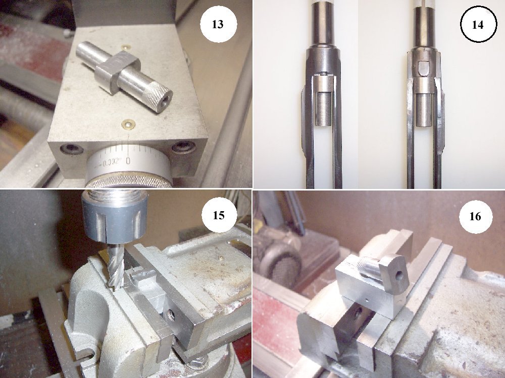

(13) Plug sides milled flat
(14) Plug snug fit in barrel
(15) Excess metal milled off plug
(16) Plug ready to cut ramp
(17) Muzzle skim cut for concentricity
(18) Plug milled for breechblock clearance
(19) Plug set up to mill ramp
(20) Ramp milled
(21) Cut milled in center of ramp
(22), (23) Slitting saw set up to mill extractor groove
(24) Centering slitting saw with drill bit & spirit level
(25) Finished extractor cut

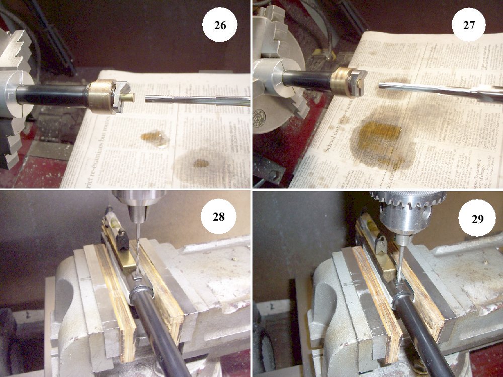

(26) Reaming .22LR chamber; partially cut
(27) Finished reaming .22LR chamber

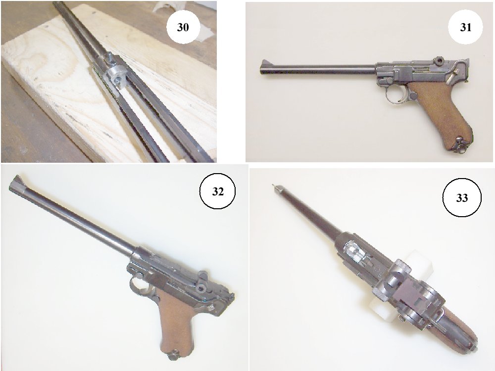

(28) Drilling receiver lug & barrel for setscrew
(29) Tapping receiver lug & barrel
(30) Installing setscrew
(31) Side view; finished conversion
(32) Oblique view
(33) Chamber view; toggle locked open

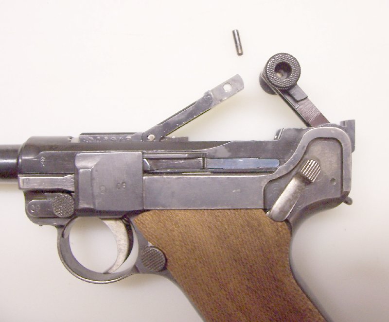

Note that the toggle pin that came out should have a locking pin that goes down a small hole thru the toggle, near finger grips, into a detent on the left side of the pin. This is like the locking pin on the safety or take down lever. Georg seemed to like this pin method to lock parts in.
Unread 01-02-2015, 08:32 PM   #7
I must have missed that part of his biography - When did Georg work for ERMA???
Unread 01-02-2015, 10:06 PM   #8
Can you provide a picture of what you are saying, because I can't picture it.
Unread 01-03-2015, 02:44 AM   #9
Posts: 3,403
Thanks: 7,569
Rich, if you need an axle retaining pin, I predict the Erma King will cooperate. Mic the D. and the L. and he can check for one.
Unread 01-03-2015, 10:07 AM   #10
As far as I can remember, this ERMA toggle had no axle retaining pin. My pics don't show any either.
It's not my unit [the ERMA .22 kit], which is why I made no permanent modifications to it. I did not try to 'tune' it, as I only had my own 1937 Mauser Luger to try it on. I no longer have it, but perhaps the forum member who does own it can comment further on this.

Unread 01-03-2015, 06:39 PM   #13
So without a retaining pin, how's the axle supposed to stay in?
I have no idea. If you look at the second pic in post #10 above you can see the axle pin is sticking out already.
Unread 01-04-2015, 07:03 PM   #14
Posts: 3,403
Thanks: 7,569

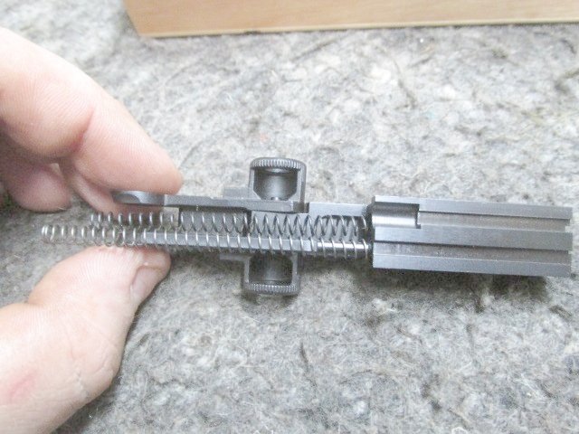

I pulled my 70s Mauser with the SE/08 kit installed today to fiddle with the kit's extractor, which wasn't pulling the empties out of the chamber last time I used it. I was intending to clean out its area and dress the claw, if necessary. (I succeeded only in locking all of the related parts into the breech block somehow, but that's another story.) The corresponding axle in my slightly earlier kit is a press fit. The rear pin is the only one that slides out. It can do this because once installed, it is captivated by the barrel extension, while the other two present open ends--thus the press fit for them. Looks like you'll need a slightly larger pin that will bind enough to stay put.

Unread 02-04-2015, 04:44 PM   #19
Ed - I couldn't either; your toggle wasn't drilled for an axle pin retaining pin IIRC - and my pic in post #10 above don't show a hole for one either...
...But the Gun Digest parts schematic in the other thread DOES show one...WTF???
Unread 02-04-2015, 11:23 PM   #20
Diver6106
Diver6106's Avatar
Join Date: Sep 2014
Location: Mt. Vernon VA
Posts: 246
Thanks: 1,436
Thanked 119 Times in 76 Posts
If you don't have the 'center pin key', I guess you'll have to peen the two ends of the axle so it doesn't come out, but is still flat enough for the toggle to close. Or other options, such as modifying the pin to a screw fit or other mod. As a side note, the Stoner LMG had faulty locking pins with a screw design holding the grip to the frame in the earlier versions, and they fell out and killed some SEALs. After that it was modified with a snap in pin that precluded it from falling out. Locking pins are a simple concept, but faulty ones can ruin your day.
