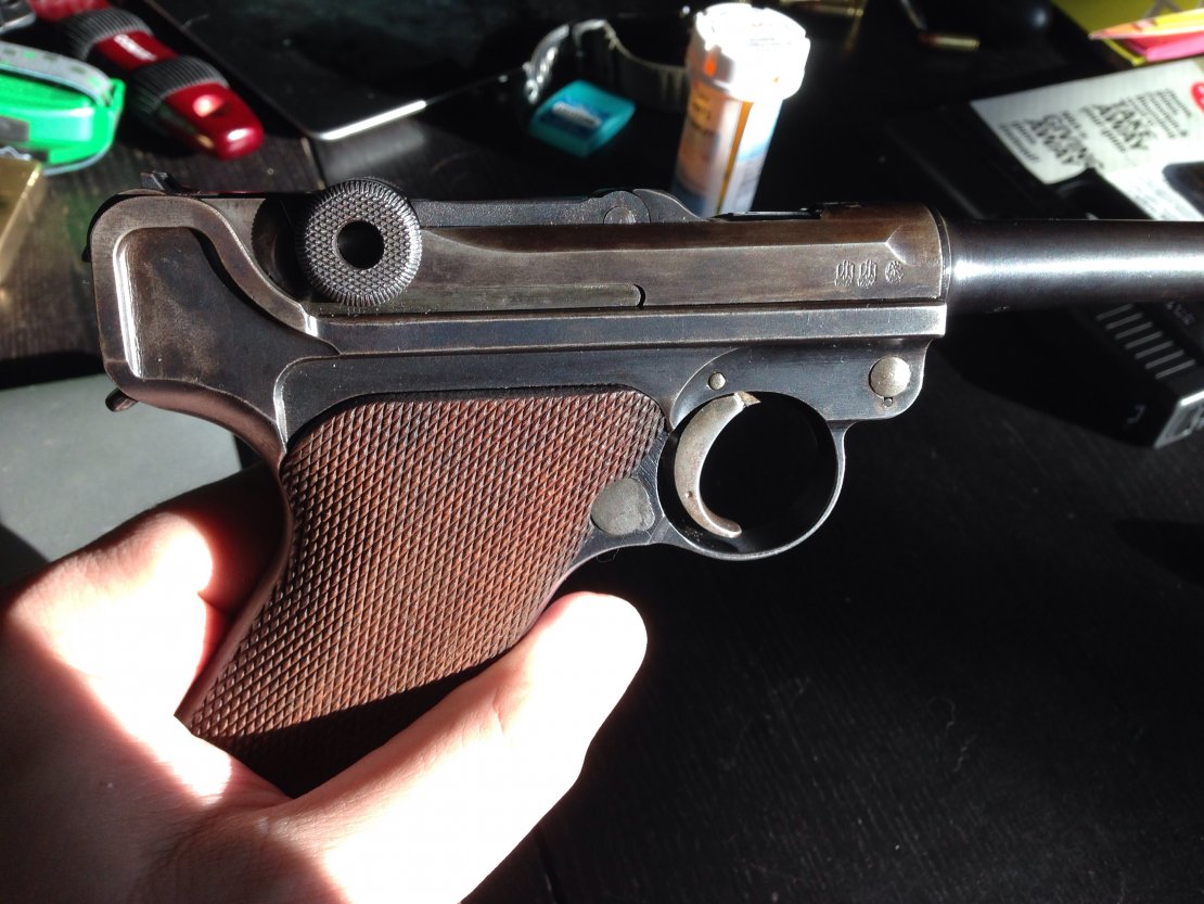

Default This is my 1921 DWM Army
I started another thread hoping to find additional information about it, specifically if it is in fact an army DWM, was I well bought at 1200, and does the brown receiver seem strange and out of place?
Please follow this link to the auction that alerted me to the pistol, there's a lot of nice pictures of it.
http://www.gunbroker.com/Auction/Vie...Item=430847848
I attached one photo that really shows the brown.
What do you guys think?
DATURK is offline   Reply With Quote
Unread 08-26-2014, 11:43 PM   #18
Finish varies by the heat applied to the metal, the freshness of the rust blueing solution, ambient temperature/humidity, etc.
it is not terribly unusual to see a major pistol component slightly off from the rest of the gun. If the factory worker did something as simple as go to lunch before finishing that last component, if could affect the final finish.

I'm wondering if someone hasn't wiped on cold bluing or something similar that does not hold fast. Usually smell is a tell-tale of cold bluing.
