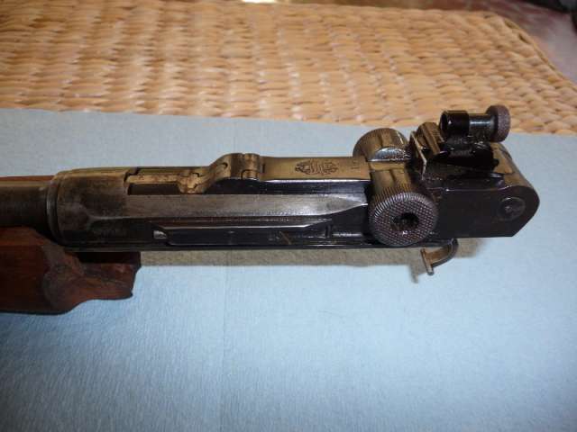

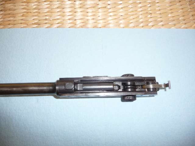

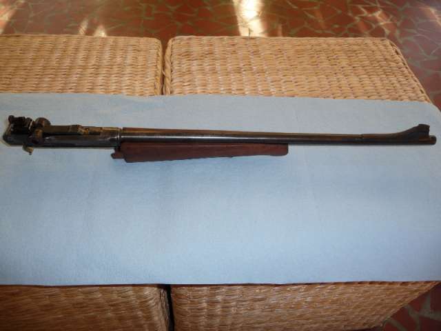

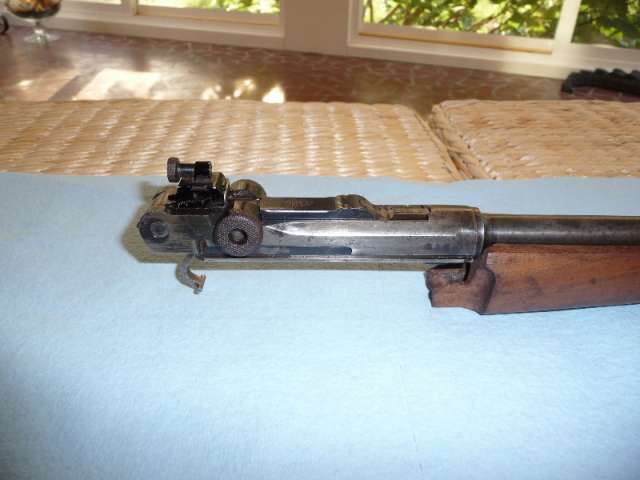

so i recently obtained a 1915 dwm marked all matching numbers (except for pivot pin at rear of receiver) 16" rifle barrel and complete receiver wondering what it would be worth it definantly could use a reblue and sights are not original pics to follow ... just want to get an idea of worth

It looks like the start (or end) of a gunsmith's Luger carbine project. I am assuming that the forestock is not attached to the barrel in any way. I suspect that the forestock is held on to a frame extension with a screw. To complete the carbine you would of course need the frame to go with the upper and it would have to be modified with an extension to attach the forestock. With the 16" barrel, it would be legal to attach a shoulder stock.
I would think that it would be an attractive item for someone interested in making a carbine and would be worth $300-$400 or so. I would buy it for that if you are interested in selling.

ive no clue ive never owned a luger , there is a hole in the rear of the forearm where it looks as if something would go up in it , the receiver and bolt all match no serial number on the barrel .... there is a hole half way up the forearm for a screw

These long uppers are tricky in getting them to fire a 9mm more than single shot...

A forestock attached to a barrel will flat not function. First of all there has to be about 3/8 inch free space between the rear of the stock and the receiver or the receiver will not move during recoil and the action will not cycle. Secondly, even with the free space the weight of the forestock inhibits cycling so every round jams, and you can't hold the forestock while shooting as that further exacerbates the problem.

The ones that feature the wood attached to the longish barrel are at best single shots...

I've worked on a few of these 16" rebarrelled lugers. The most difficult part of the process is to come up with a recoil spring that will allow this heavy barrel to cycle properly. I do fine the adjustable rear sight interesting. TH

I had this in my possession for a while , if memory serves it head spaces correctly and the barrel looks pretty nice inside.
Very nice setup on the rear adjustable sight, proper height for the front sight.
It shouldn't take too much to get it functional .
Pick your favorite ammo and calibrate the recoil accordingly.
Should make someone very happy, would like to see the finished product posted for us to look at one day.

Vern, can you tell us a bit more about it??? The peep sight base looks like it might be pinned in place...Do you know what it came off of???
