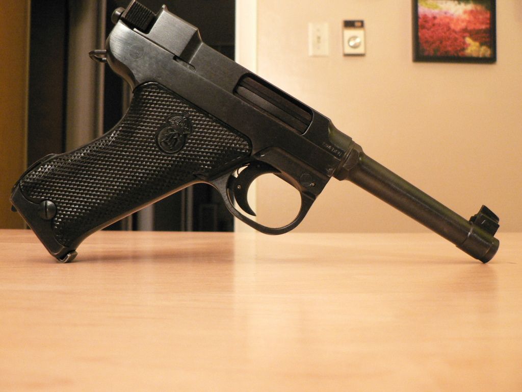

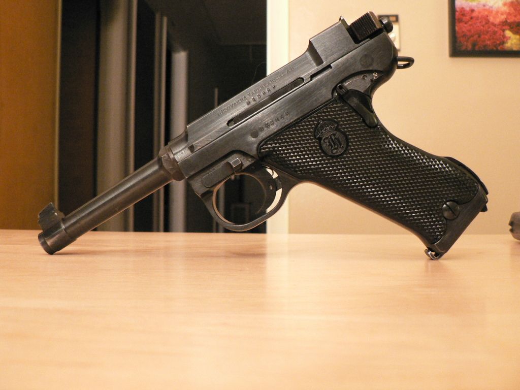

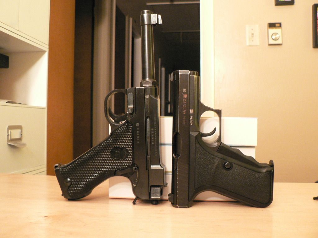

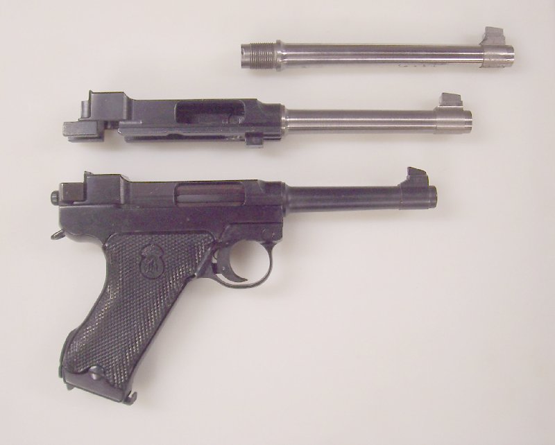

In my very first post here back in 2009 I posted a pic of my Lahti along with two 9mm barrels I had made for it. I just took another pic and posted below.
But that is not my question...Did Lahti or even any aftermarket gunsmith make a carbine version of the Swedish M40 or Finnish M35 Lahti 9mm pistol???
I know there are several types of stocks for it; board, wood stock/holster, wood board + leather holster...Several different leather holsters...
But was a forearm-equipped, 12" or longer, multi-position adjustable sight Lahti ever made???
I Google-Searched, couldn't find any pics...
I think a Lahti carbine would be kind of cool...An added incentive for a Lahti carbine is the Lahti 'accelerator', which aids in cycling the action in extreme cold/dirty conditions, as well as overcoming weak powder loads...
I can [probably] whip up a PhotoShop rendering of my idea of a Lahti carbine, but it would be pure fantasy...(As opposed to my artillery Nambu)...
I can imagine an artillery Lahti easy enough, and it would be a familiar project for me...But a carbine...Well, that would be a challenge...
The Lahti uses the same barrel thread as the Luger, but longer...The stock lug is similar, but the lock cut is placed differently...Both are close enough to be modified to fit...

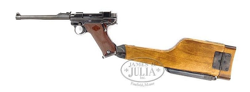

There's an excellent site for the Lahti at -
http://www.gotavapen.se/gota/m40/pist40_1.htm
With shoulder stocks on page 6. I like the one Julia has on their auction site. That Lahti is a Finnish L-35 and seems to have a tangent sight as well.
http://www.invaluable.com/auction-lo...9-c-j4w578fk5t
(That one sold in 2008)

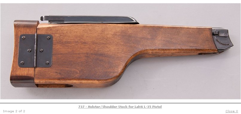

Here's the pic from the URL of a Swedish site selling M40 stocks that Olle mentioned...for 1250 Kronor!!!
That's outrageous!!! I'm sure I've seen them on eBay for 600 - 700 Kronor!!!
Anyway...Interesting method of attachment...Two straight-cut clamps with a center push-bolt...Slide it on and then tighten the push-bolt against the gripframe lug...
I think I could possibly make up something like this attaching piece...But I like the Luger curved ironwork with the half-moon latch...
I like the shape of the Luger board stock better too...
If I were to attempt such a board stock, I'm thinking of a Luger artillery board stock with a Lahti attaching piece, and a Luger artillery repro holster attached to the board stock, probably with three or four 1/4" carriage bolts holding the leather to the wood...Maybe with domed nuts on the carriage bolts...
