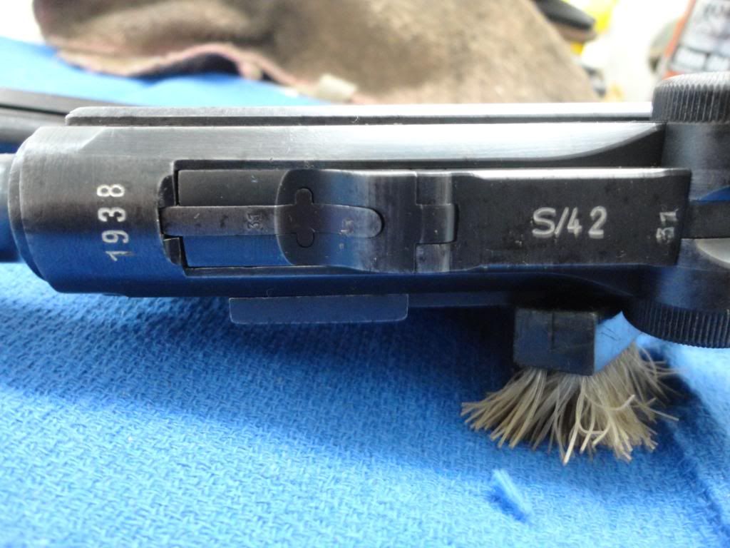

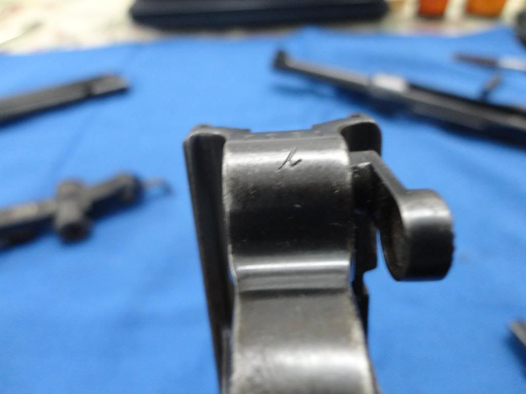

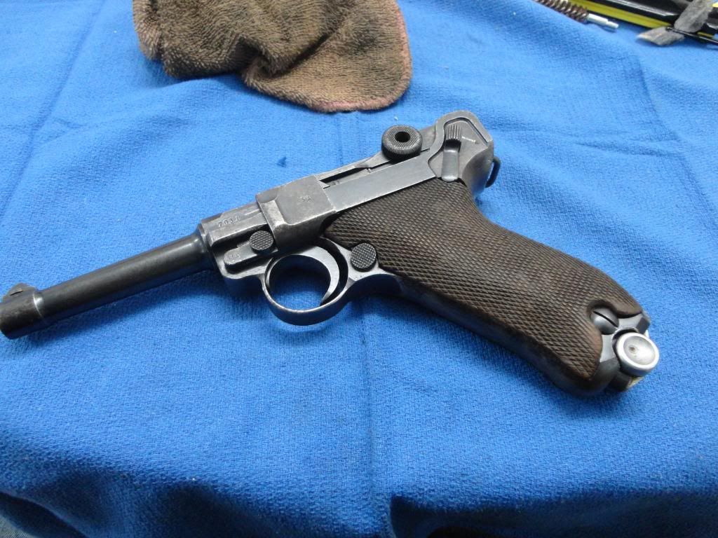

The last one was identified in no time at all. I hope y'all can do it again. I've seen similar ones on Gunbroker, but none of them have a decent description. All the numbers I've seen have been correct. Thanks in advance for any help anyone can provide(and yes, I'll thank you again later). Sorry about the huge pics.

Hello.
The magazine is not original. Looks like an east german. I can not see any VOPO markings on the gun.

Hi Randy,
What do you want to know about this one? Is this yours, or are you looking at buying it?
It's a Mauser made Luger looks like sn 7031k? Looks like the barrel has been off of it for some reason. Million dollar chip up on the left rear top grip.

Good point on the witness markings...
Looks like she's been around the patch a few times, but if all numbers match except mag, maybe $1250 as an entry level collectable that you can shoot. An easy $1000 as a shooter.

I don't believe the barrel has been removed and then reinstalled, the very notion is absurd. Extensive firing can cause a barrel to tighten up slightly, which is why the register mark has shifted.

And Norme, I find it no more absurd that the barrel has been removed or somehow altered, than I find it that it tightened itself up. (Insert smiley face here...)
Just my $.02.
Hi David, What is absurd is the idea that a German armorer would go to the trouble of unscrewing a Luger barrel and then replacing it with the SAME barrel!
The passage of a bullet through a rifled barrel imparts a rotational torque, and the right hand twist of a Luger's rifling makes the barrel self tightening. This is standard engineering practice with parts that are subjected to torque, such as bicycle pedals, those on the left side having a left hand thread, those on the right a conventional right hand thread.

Witness marks tell you much less than is commonly believed. If you do a forum search you will find extensive posts on the subject.
With Mauser P08s, the witness mark was not applied in one stroke. The flange diameter of Mauser barrels is slightly greater than the diameter of the receiver, so it is impractical to strike the mark hard enough to impress both the barrel and receiver. The mark was centered on the receiver, and once the final barrel was in place the flange was stamped to match. Obviously the accuracy of the correspondence depended on the skill and care of the person applying the mark.
